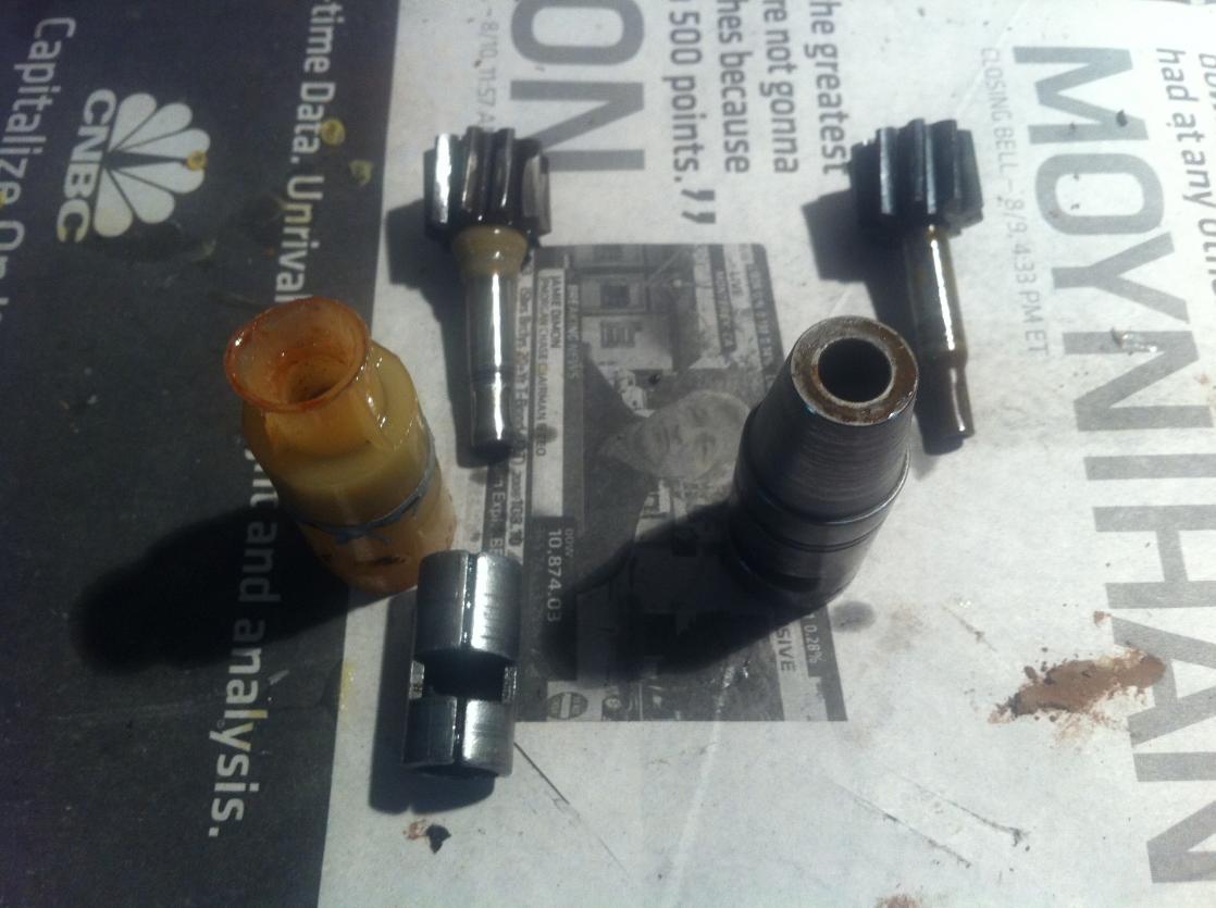

Here is how I fixed the leak coming from the speedo drive on my automatic transmission.

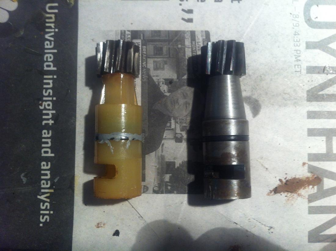

First, it seems there are 2 types of speedo drives. The 'cylinder' of one is made out of some plastic material (ABS?), on the left in the first picture below. Another type is made completely out of steel, on the right of the same picture. This one also leaks and came out of a spare transmission I've had for over 30 years.

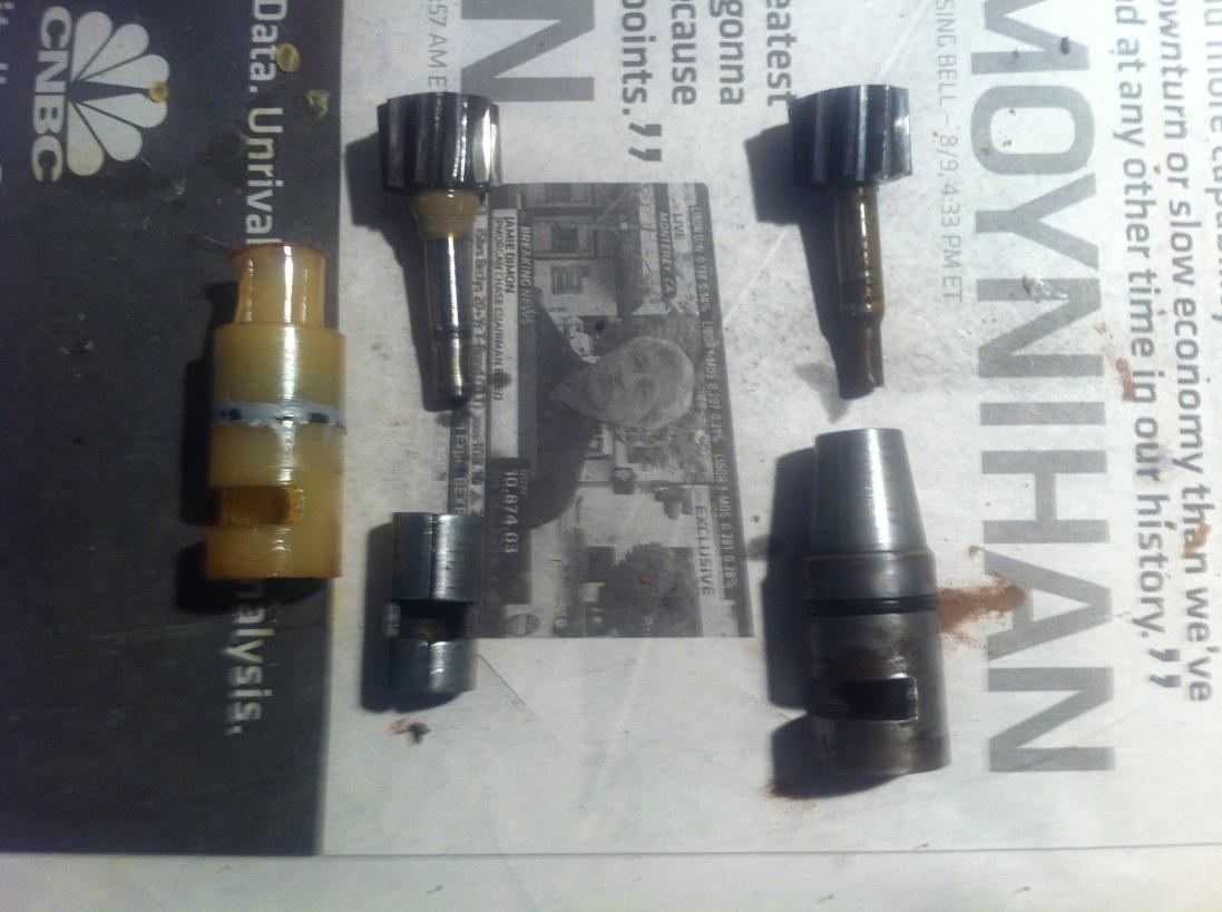

The fix is for the 'plastic' type which I had in my transmission. You can see the difference in the construction of the two types in the second picture picture. The plastic one has a sleeve which is inserted into the cylinder. The metal one has no sleeve and is basically made out of two parts, the cylinder and the gear. Have no idea as to how the o'ring was put in there by BMW so no idea as to how to fix that type. The last picture is a view from the top of the two types

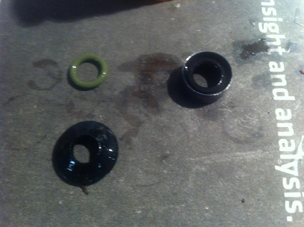

The leak was coming from the center where the speedo cable is attached. This was a result of a defective washer/o'ring encased in a metal band inside the 'plastic cylinder. This o'ring is NLA. This o'ring is at the top right of the third picture. The other two o'rings in the same picture was my first attempt at fixing this leak which didn't work.

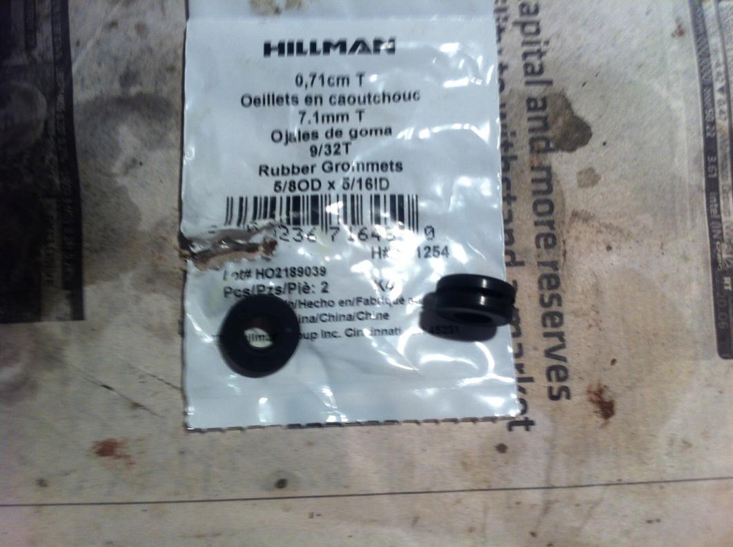

I searched for a suitable o'ring and the only thing I found is a grommet which fit perfectly over the shaft of the gear and was the same diameter of the indside of the cylinder. Its a snug fit.
Below is a picture of it with the bag (for size purposes if you want to do the same) I bought it a Lowes for about $0.89. The only problem was that it was too thick. So, I cut the grommet in half. You may be able to see from that picture that this grommet has a 'channel/groove in the middle. This is where I cut it.
I left the original o'ring in the cylinder then put this 1/2 grommet on top of it. Then the sleeves goes in holding this 'new o'ring' in place as the gear shaft would turn when driving..
I put the spedo drive back in and drove the car for about 5 miles. Not a drop leaked. Is this a permanent fix? Time will tell. If it lasts a couple of years I'll be happy. I still have 2 1/2 grommets left so that would be 10 years of fix.

My car is an e9 but I suspect it would work for an e3 just as well. Do you have the ABS plastic speedo drive or the all metal one shown in my pictures? Just curious.
Also, how long ago did you fix yours? Curious to know how long this fix may last.

Good try but it will leak again as there are 2 things wrong with what you put in there 1) it is not compatible with oil, it will probably swell and leak as bad or more 2) This is a an actual seal, just like a front engine seal or any other seal. Get a proper seal and install it. It needs to stop trans oil from coming down past the gear drive.
This is what I explained in your other post, anything but a seal will leak, just a matter of time, from working at the dealership for years on this stuff, I have seen all sorts of crap people have stuffed up there to stop the leak
The seal size is 8 X 15 X 5 O ring size is 9 X 1.8
