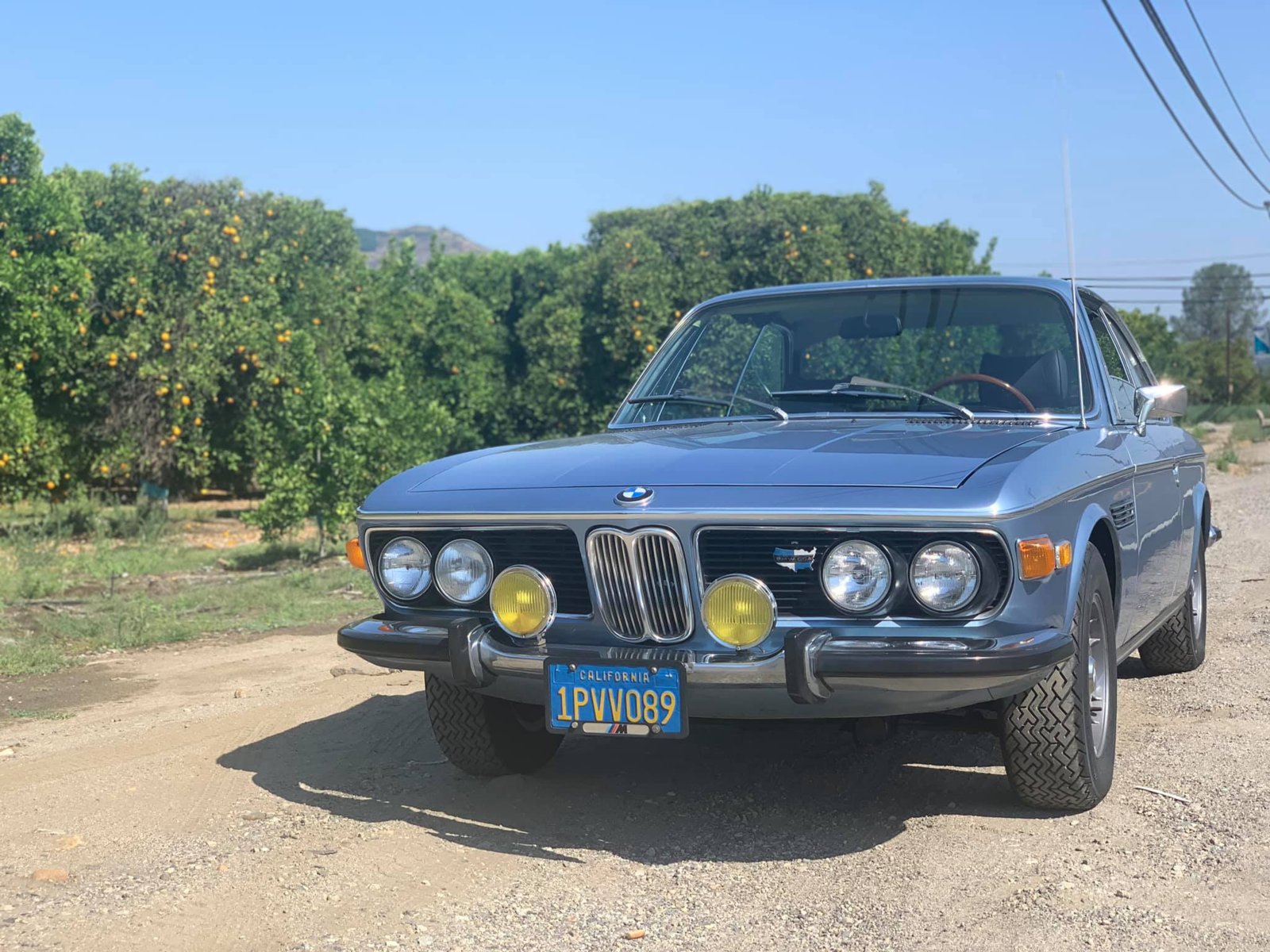

Hey Everyone -
I was Speaking with Carl at the BBQ over at La Jolla Independent on Sat and told him I liked the idea of an automatic, just not this one (I have the stock BW unit). All of my newer BMWs are 6spd MTs.
As many of you know, it downshifts at odd times and just isn't a good performer. He mentioned an auto trans replacement from a 5 series (which would also give me an extra 35hp) that would be a drop in, but I'm not sure which one.
What is the preferred model year 5 series to do this with?Has anyone done this? I tried searching the forum, but everyone went the 5spd route.
I'll post some photos of the event. too. Great time and Carl is the coolest.
Thanks -Wyndham
