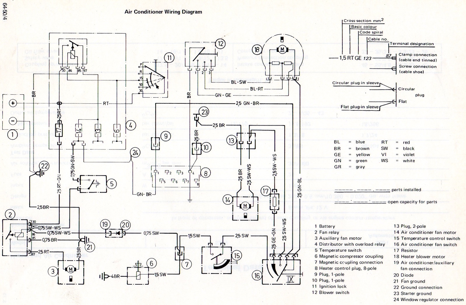

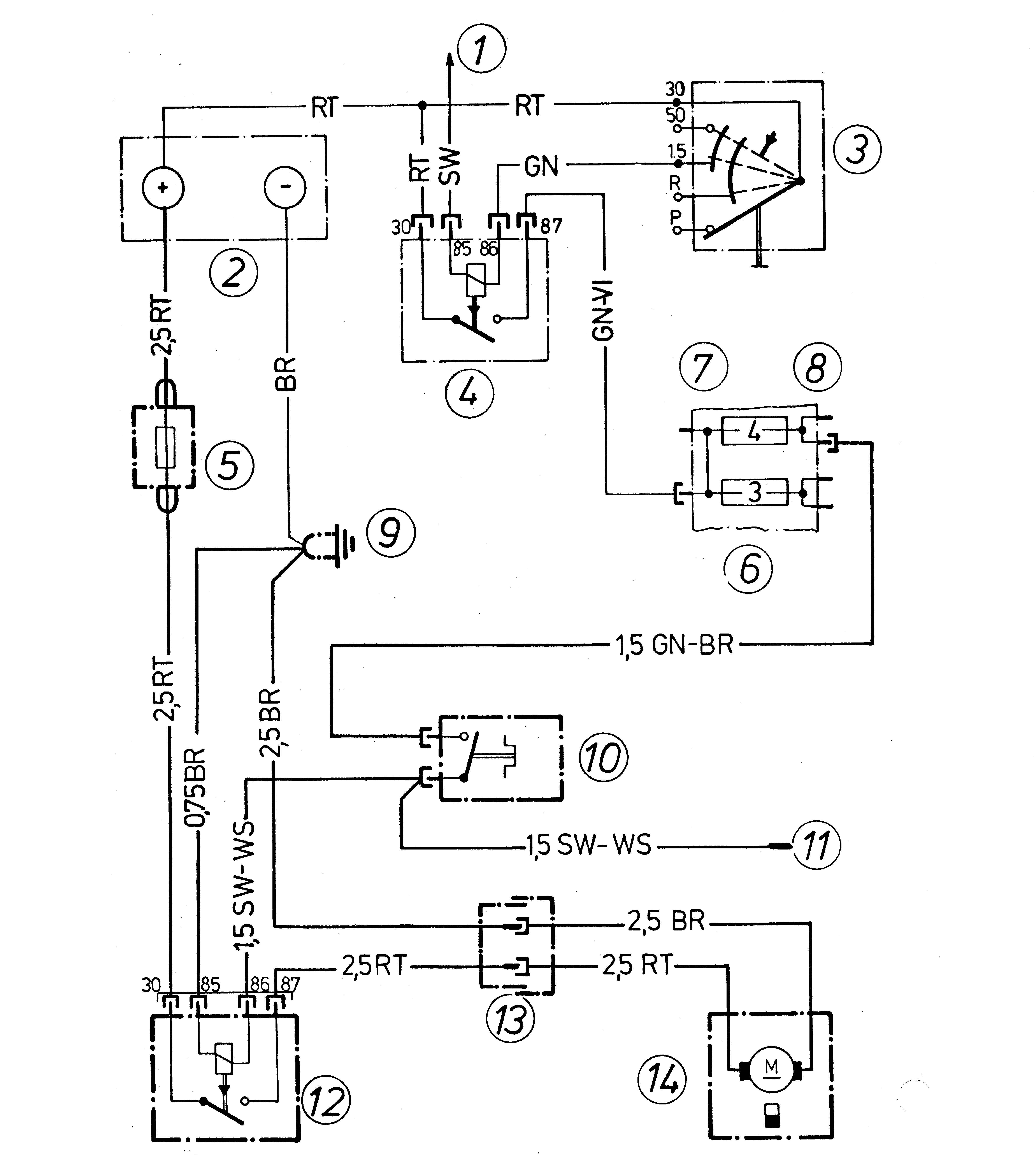

View attachment 32067 THERES A TEMP switch in the radiator that is synced to the fan -so yes it comes on wwhen it heat up too much
you can weld a bung to the side radiator rail and tap one in if you dont have one there
its really easy and then wire per the 74 diagram .
heres the wiring for the ac and the switch hookup

Thanks for your help Gents, I have a 71 2800CS and do not have a switch in the radiator so the Aux fan is only triggered by A/C only.
I was wondering If one could rewire the Aux fan to work with A/C compressor or thermostat switch?
aearch I can not find the attachment 32067, like to know what the numbered symbols are in the diagram you sent, Thanks?
