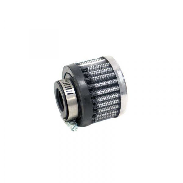

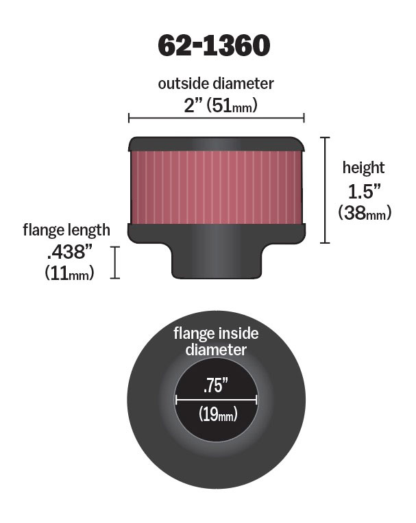

Had the same question last week, probably you already find something for yourself, but I find this part as a perfect match.
It's a K&N Crankcase breather filter, article number 62-1360. Fit's perfect to the auxiliary air valve.

I use an oil breather filter like the one suggested. Inserts easily and peened over the flared opening to hold the filter in the housing.
