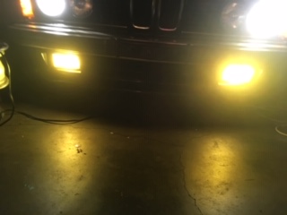

Hella 140 fog

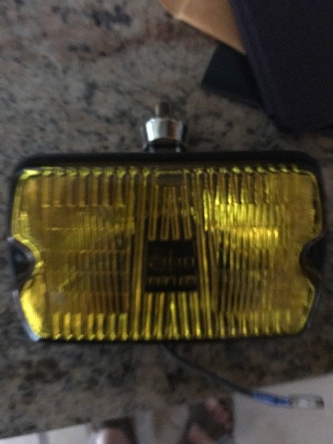

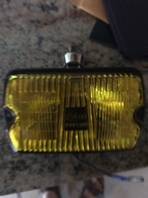

This is what my Cibies look like. But as you can see, it's the lenses that are amber so I would have to go with a dedicated fog light? So back to the original question which is sort of a survey of who favors what. Is it a matter of practicality or aesthetics or just personal choice and there is not a real answer
Depends on whether you anticipate driving in foggy or clear night conditions. For me its the latter and they have come in handy on numerous road trips. Yellow light was thought to cut through fog better than white light, but this has been debunked. Yellow is definitely less fatiguing for my eyes and provides a nice canopy ahead. Fog lights are typically mounted under the bumper to better get under the fog layer and reflect less back into your eyes.
Yours are Cibie 35's, they are also available with clear lenses fog and driving lights
