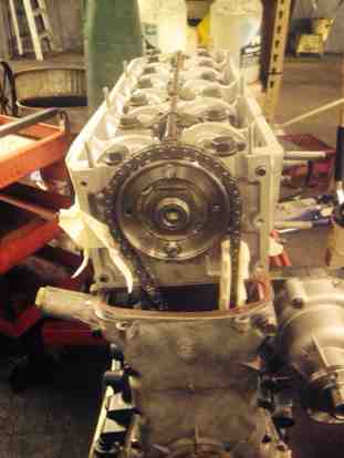

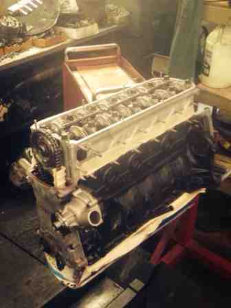

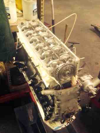

We're getting closer...
ImageUploadedByTapatalk1407891516.209637.jpgImageUploadedByTapatalk1407891525.508786.jpgImageUploadedByTapatalk1407891535.525522.jpg

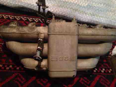

Definitely need to give this one a good cleaning and clear coat. Is it safe to blast the inside of the intake or do you just leave it and worry about the exterior. I was hoping to do this myself to save a few bucks or really as an excuse to buy some tools.

I'll post pictures soon but am very happy to report the B35 is in along with the 5 speed and stahl headers. They decided to take the entire front end off to fit it in. 10 hours later and a few tweaks to the headers and the trans mount and voila.
Oh wait, wrong intake and need the booster rebuilt but it's progress and the first time I've actually seen the headers.
