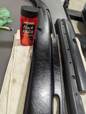

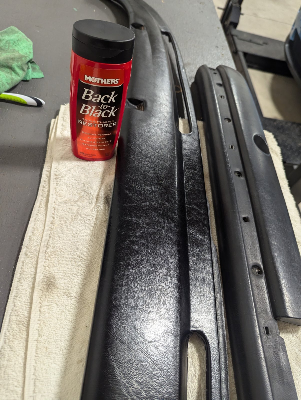

If it isn't already common knowledge, I wouldn't recommend giving your plastic dash a treatment of "Back to Black".
I scrubbed with general purpose cleaner first then rubbed in this product.
It certainly covers faded black well but comes out a bit too shiny.
In picture you'll see the top dash piece on left has the product applied, while the grab bar on right retains original clean but faded surface.
very often these products contain silicone (at least here in the EU); that silicone is what gives it it's shine and does so quite effectively; it doesn't fade or wear off.
But it does make everything that you touch years after unpaintable.....
you should be able to clean it off with SEM Soap and SEM Vinyl Prep ... it removes most anything to prepare the surface for the use of SEM Color Coat. since your dash is out of the car, i would clean it and paint it with color coat (satin black or landau black) ... there is also a satin gloss clear and a gloss clear if you want more sheen on the finish.
I have some SEM vinyl prep left over from the last job, thanks!
