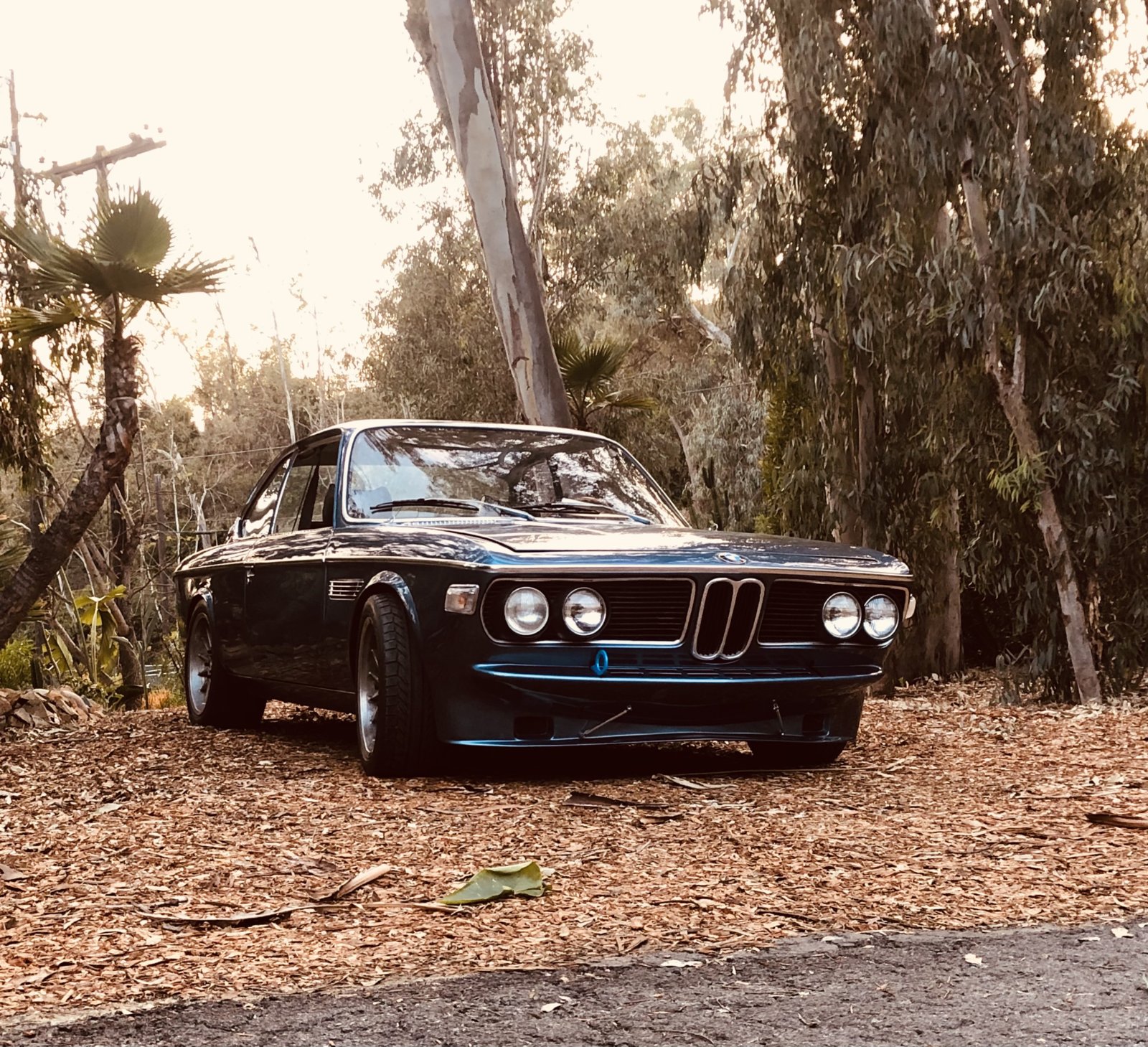

Hello everyone, roughly a year ago we purchased a 1972 Bmw 3.0 csi. It has often been our wish to post a build thread here on the forum, but we haven’t had the chance. Now that time is permitting, we’re going to start. They say better late than never!
Anyway, I’ll take you up to where we are now.

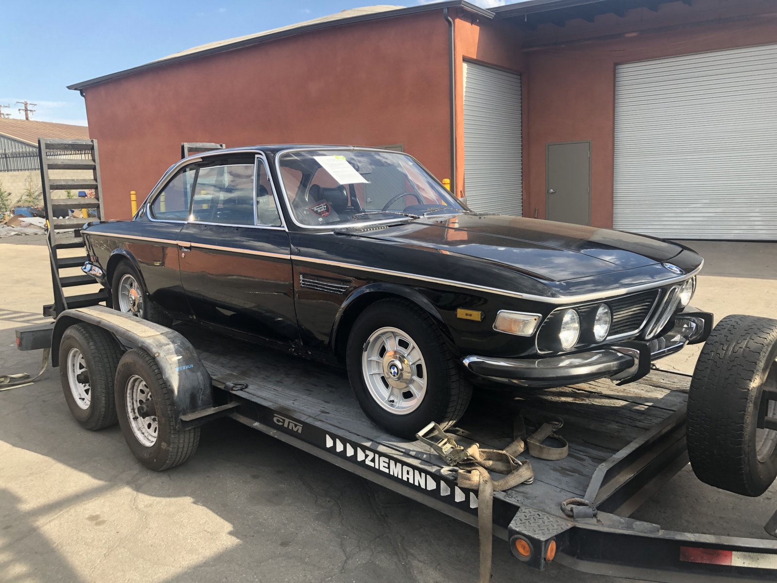

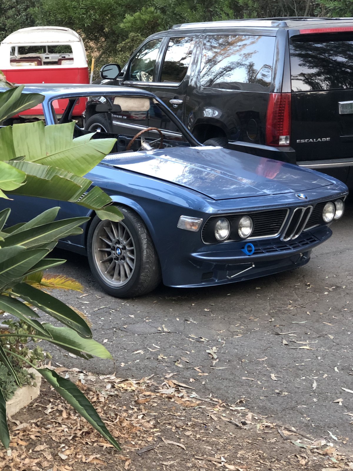

The car on the trailer ready to come home.

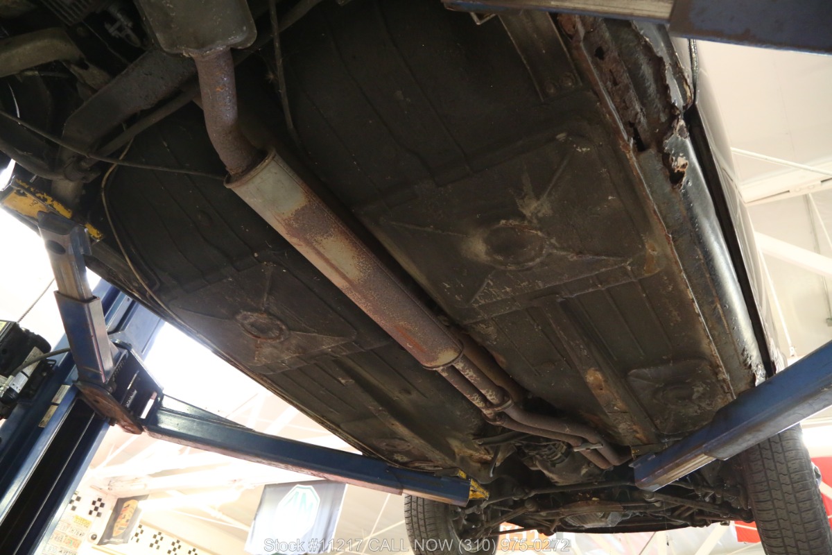

From that distance it looks pretty clean and complete, while it was pretty complete, like most e9’s it is littered with rust.

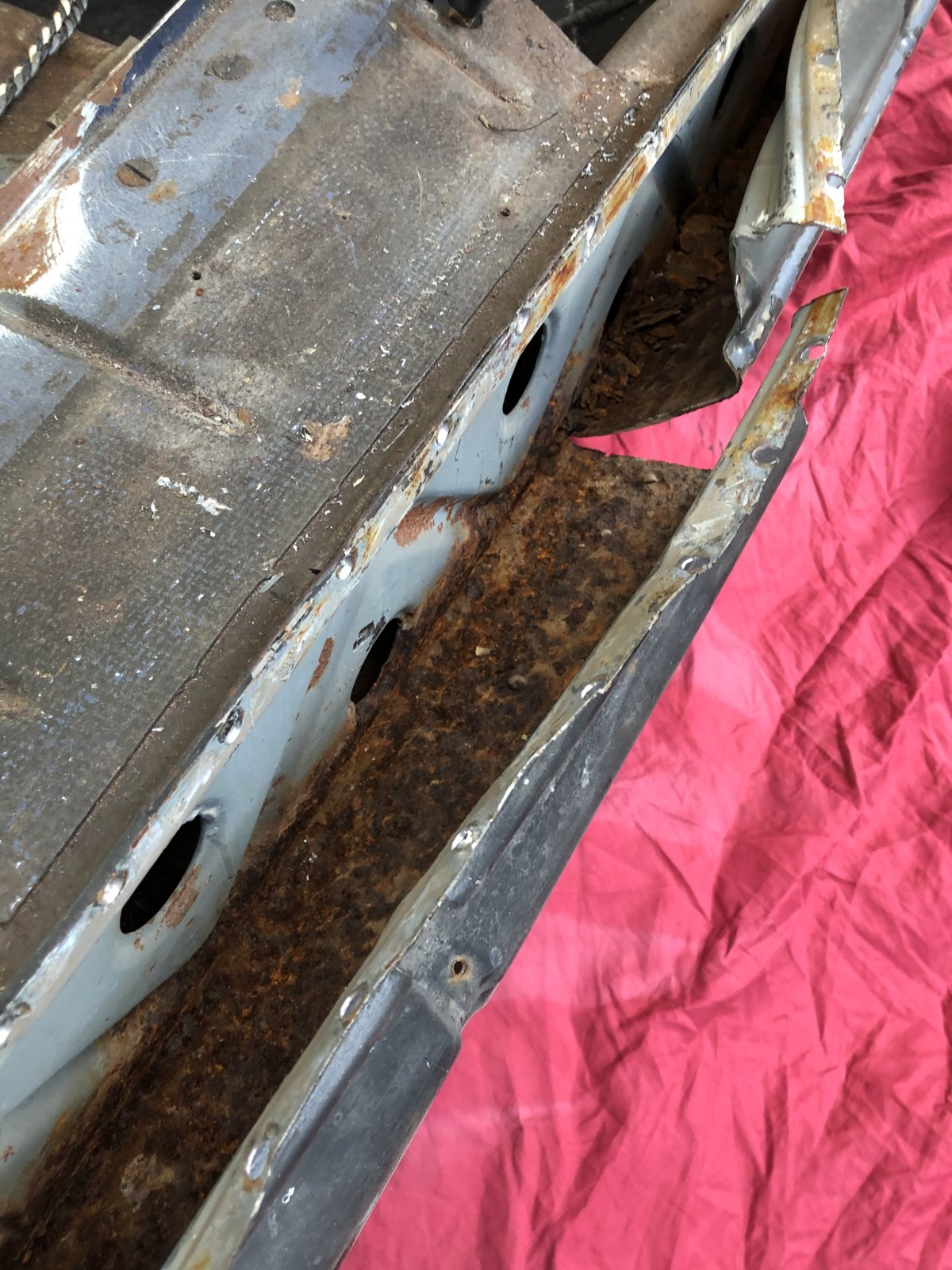

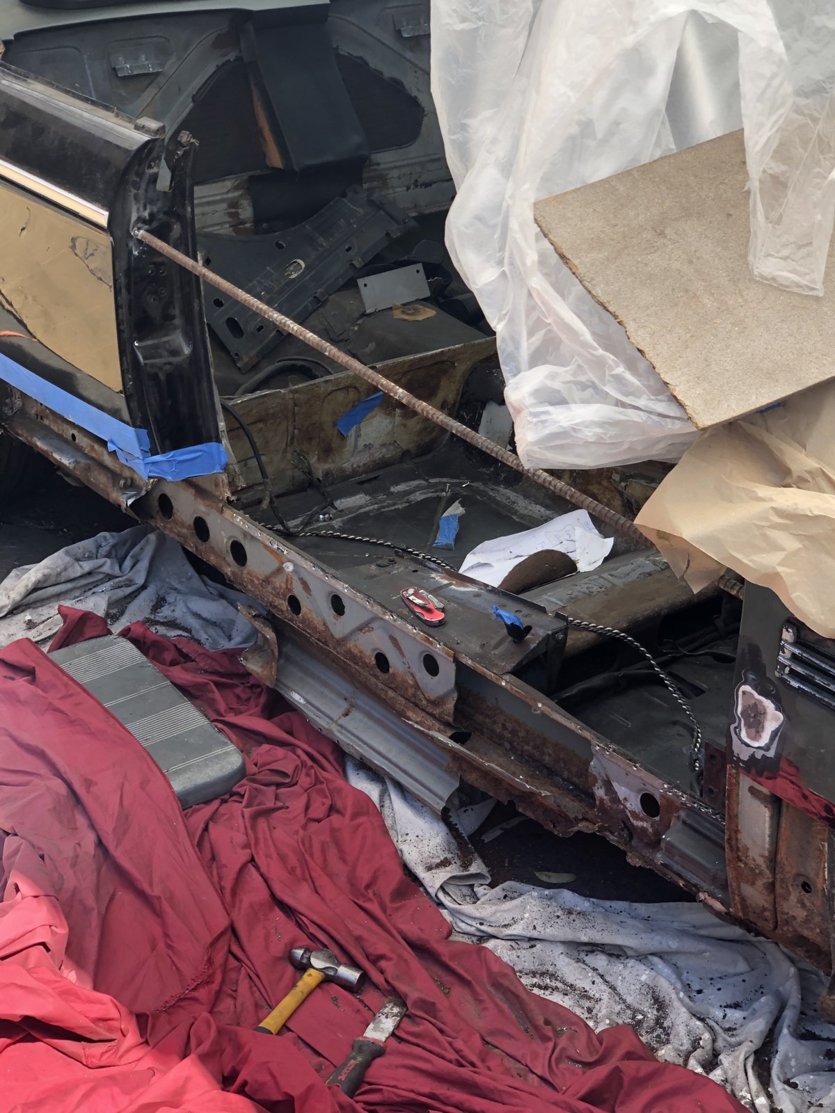

Rusty rockers— this is a preview for coming attractions

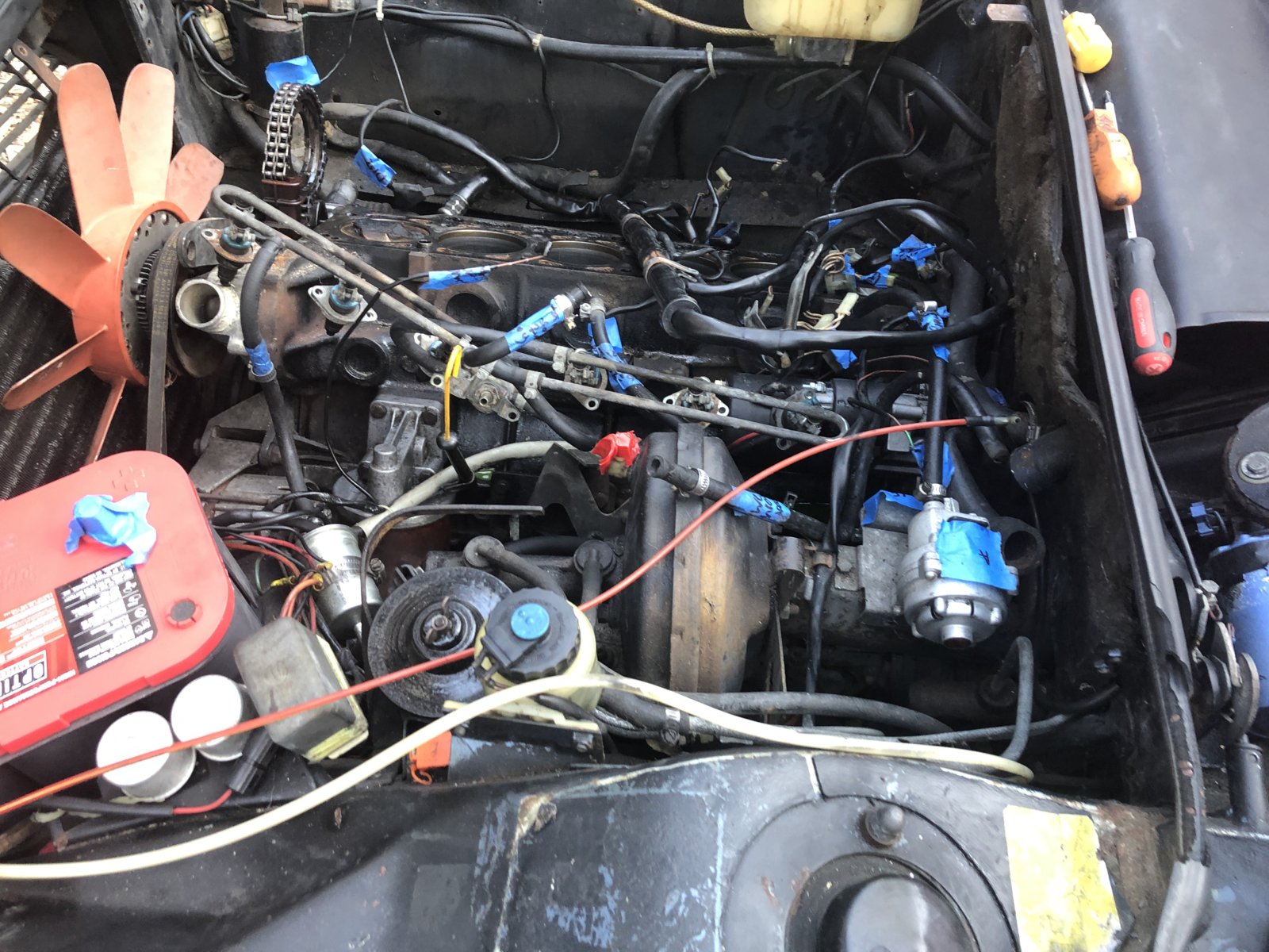

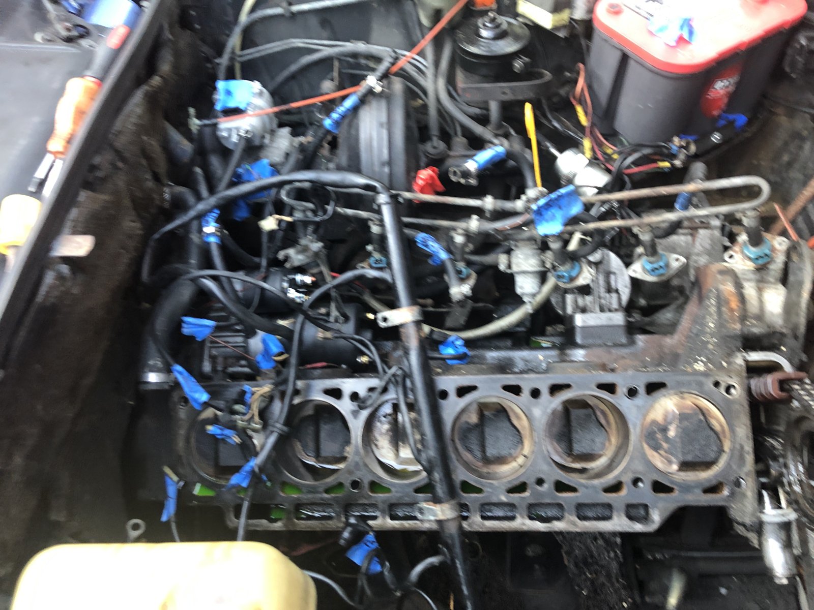

Originally the plan was to make it run and drive it, but our curious and thorough nature made us take a look under the head. To our dismay, it was filled with coolant. A pressure test revealed it was cracked.

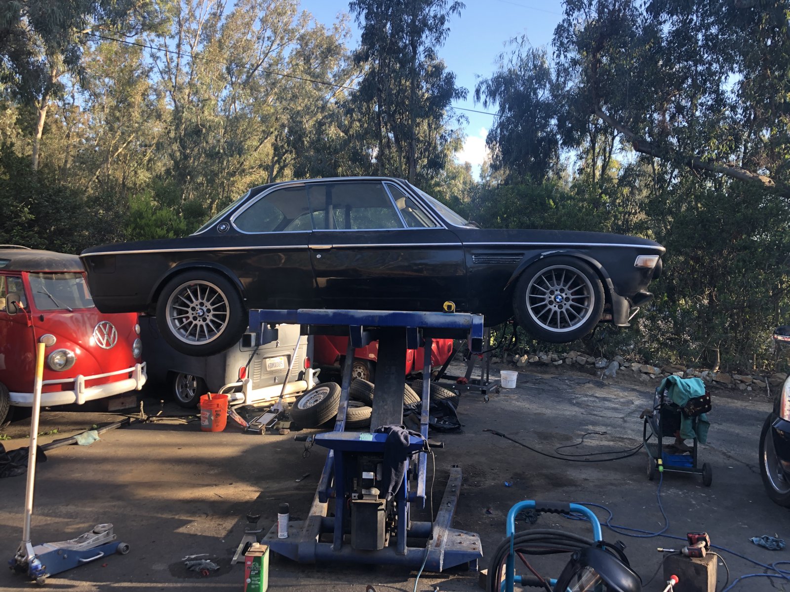

First time on our lift

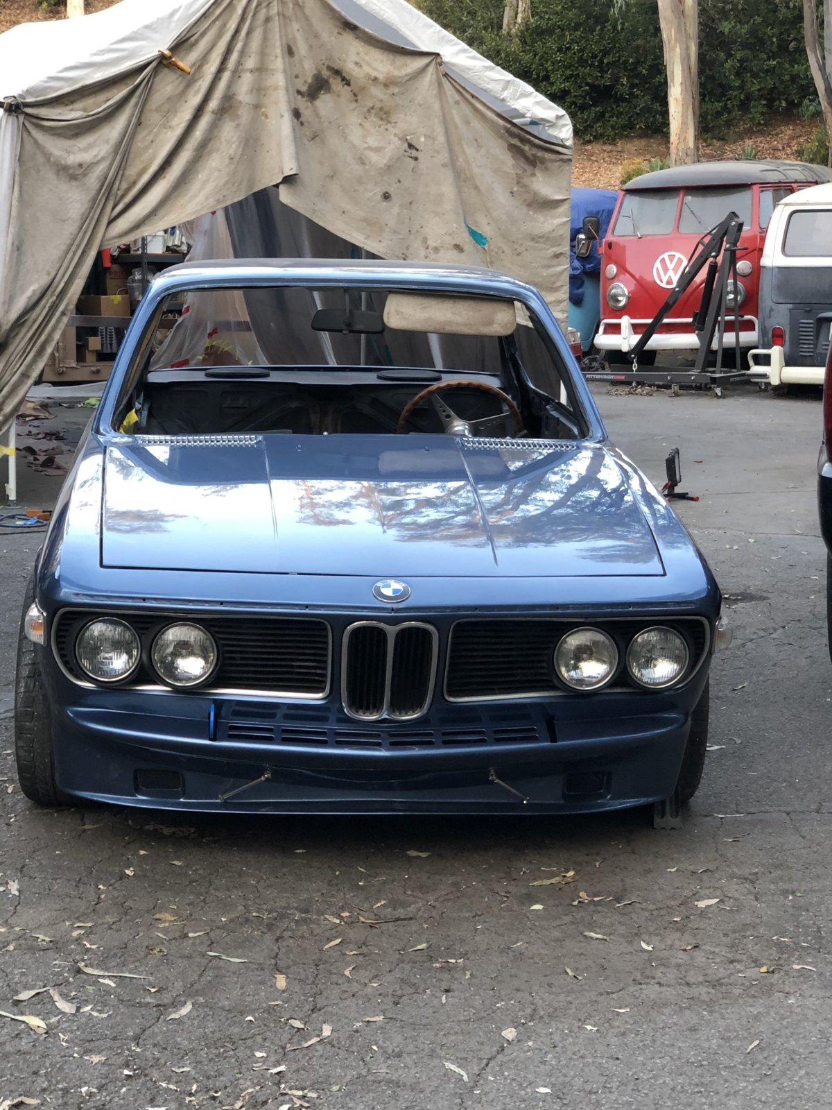

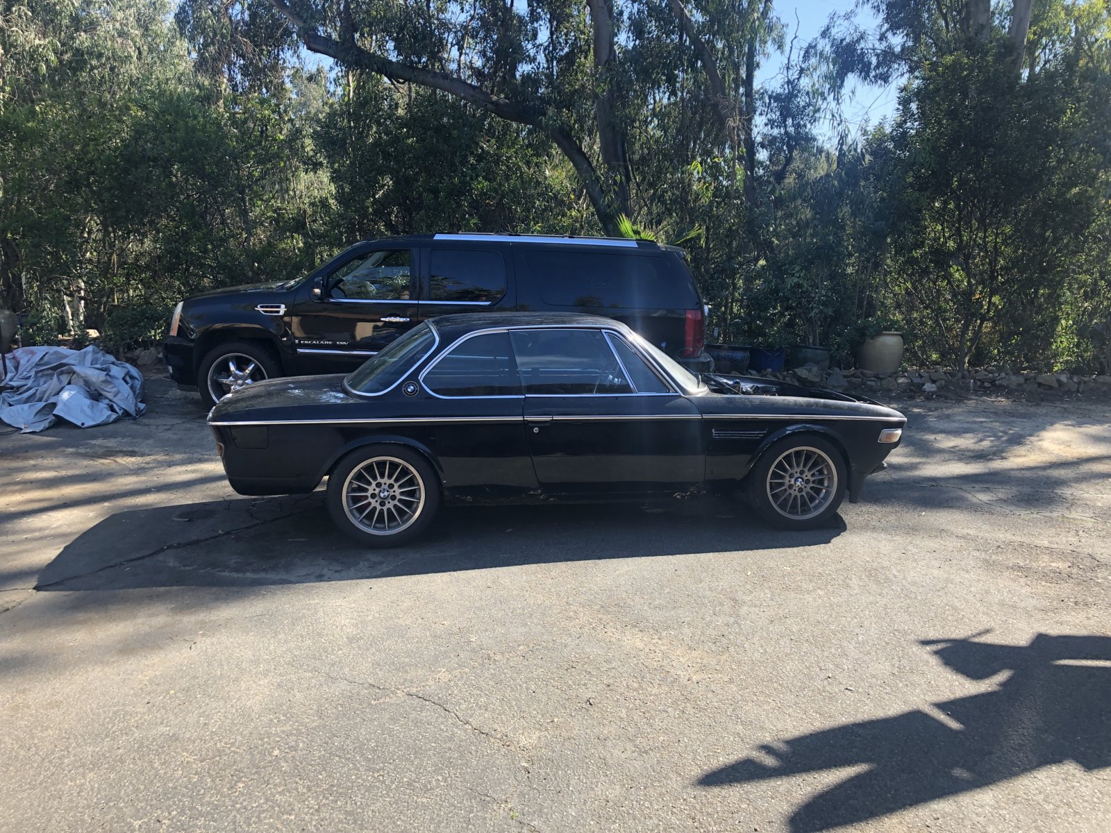

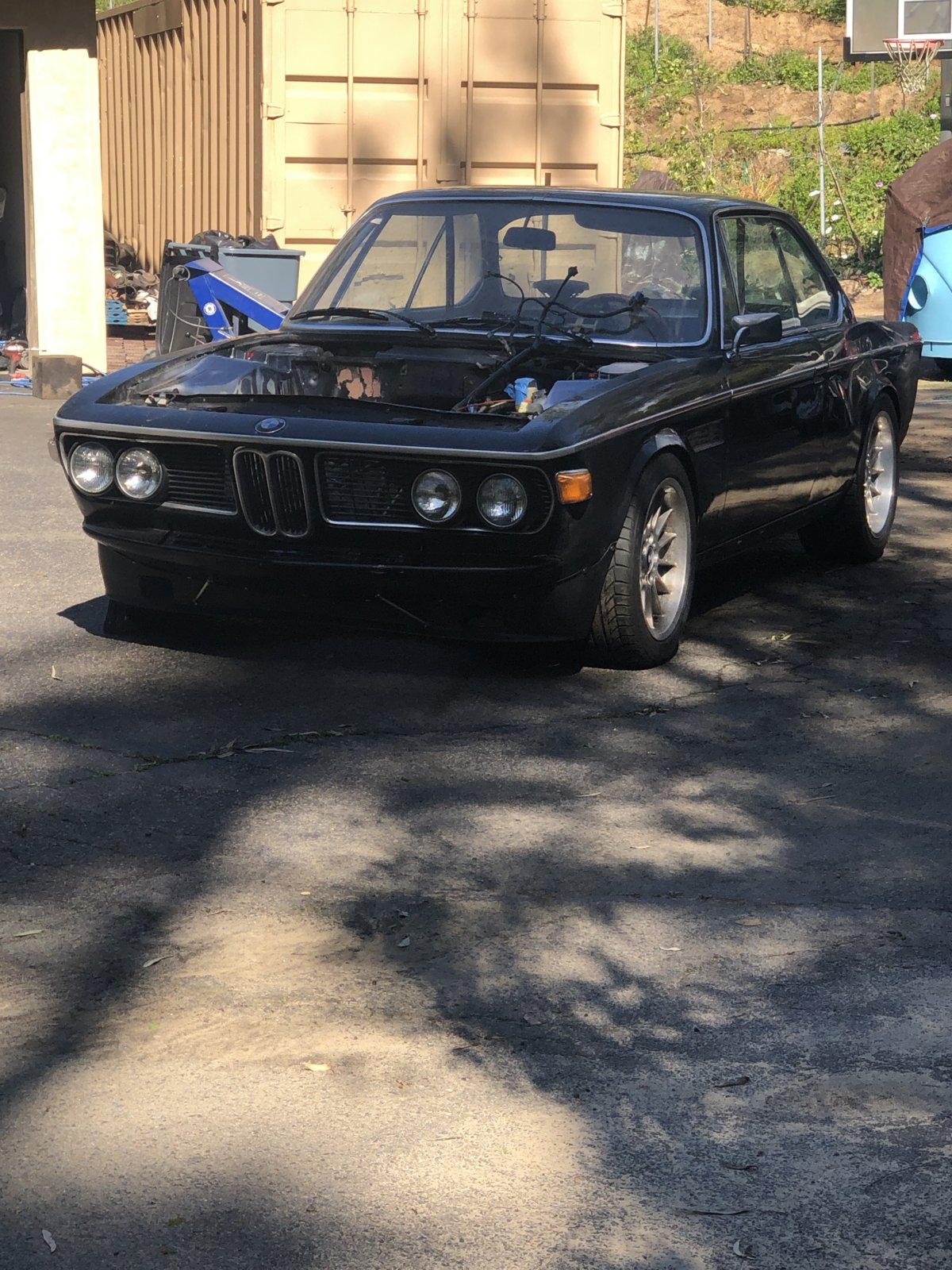

Side view showing off the car lowered. All thanks to fully adjustable racing coil overs.
We also put on a front spoiler And changed out the wheels and tires. Meanwhile the engine is out and ready for a replacement.

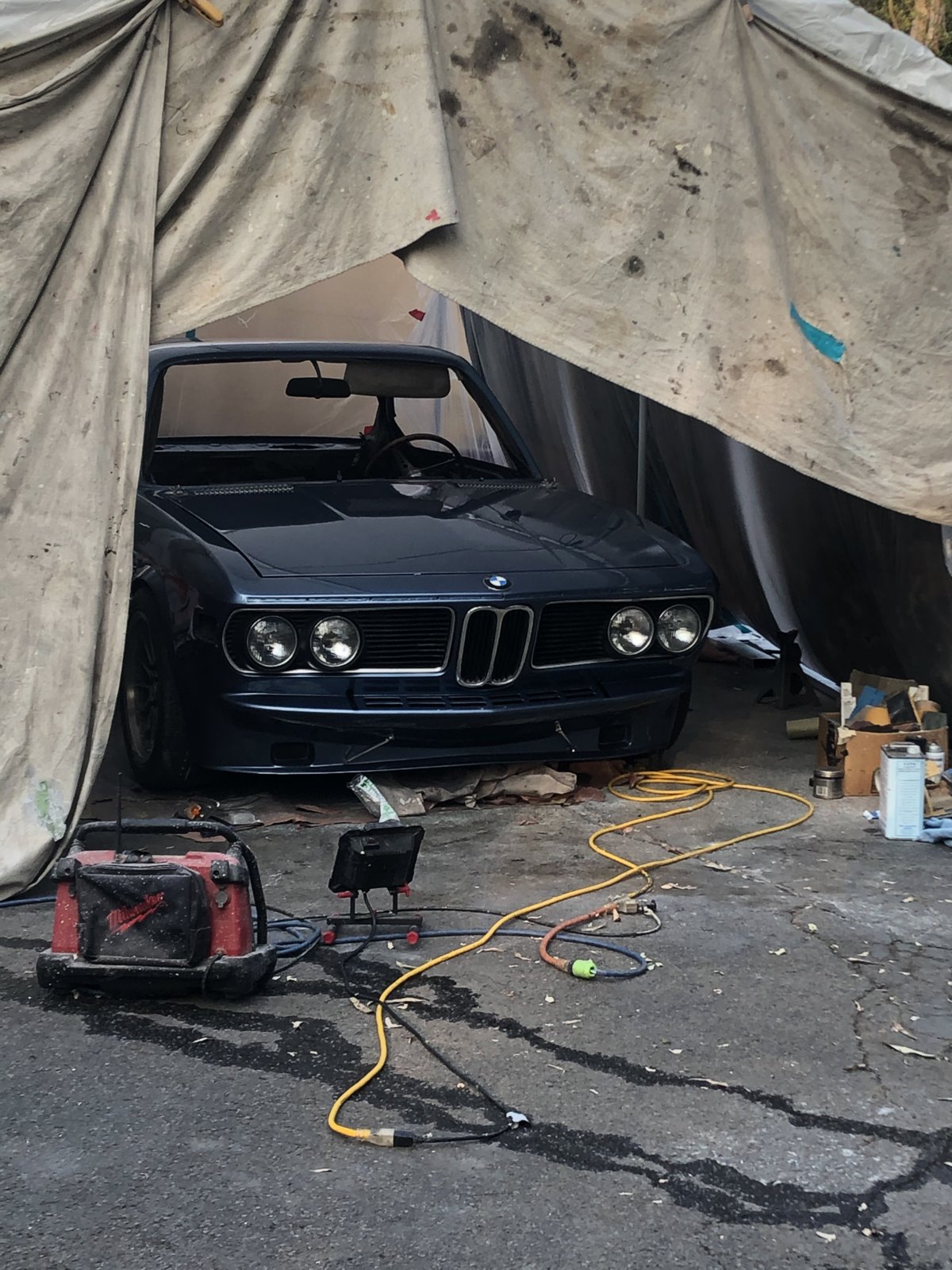

First day under the car cover

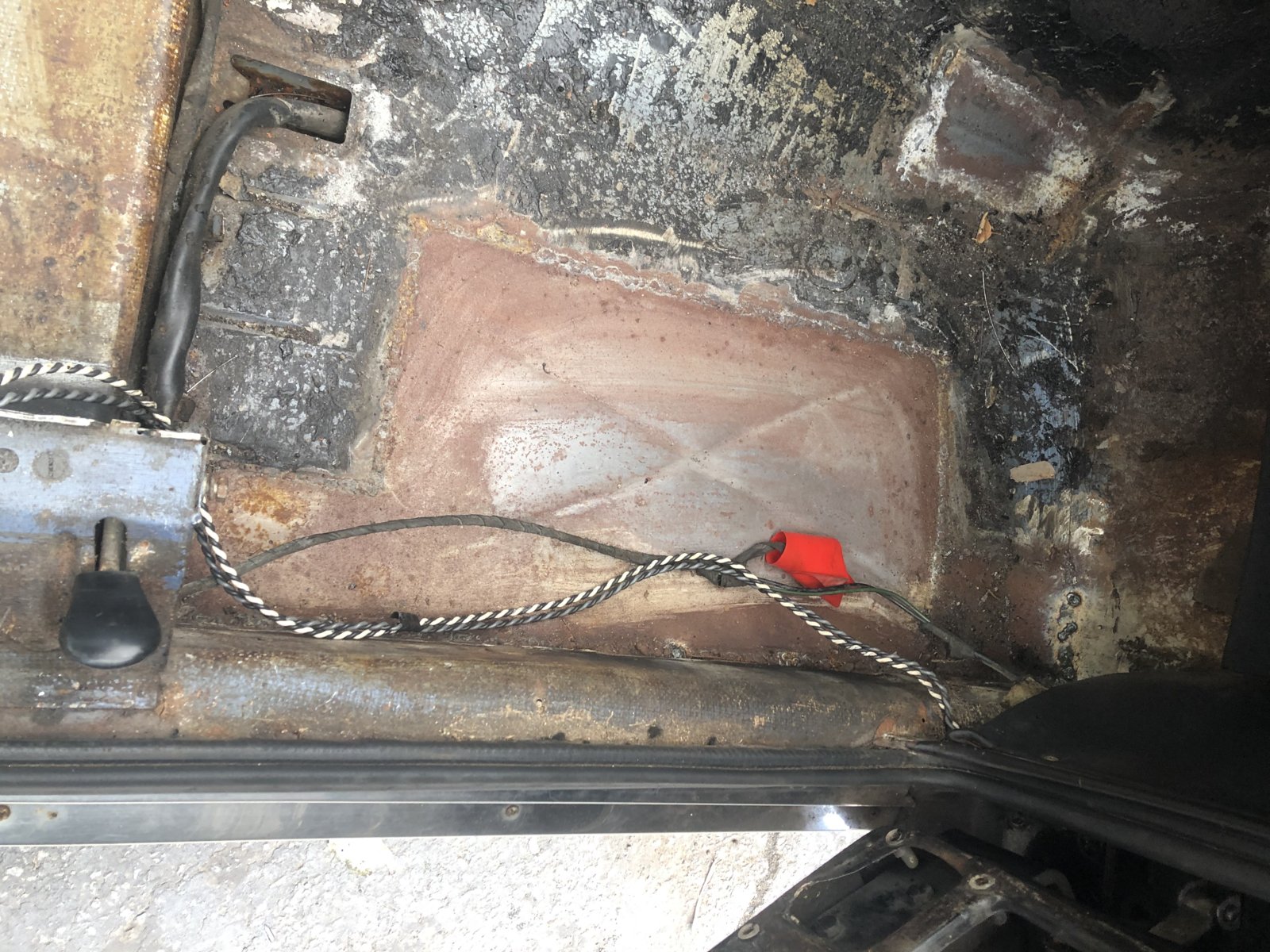

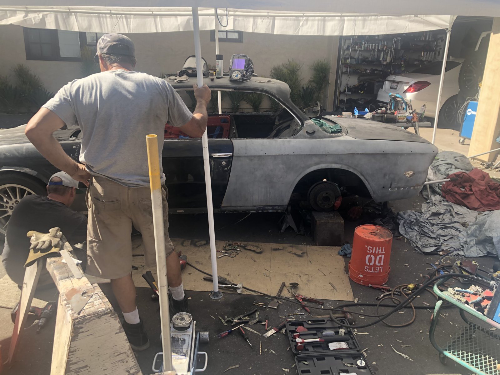

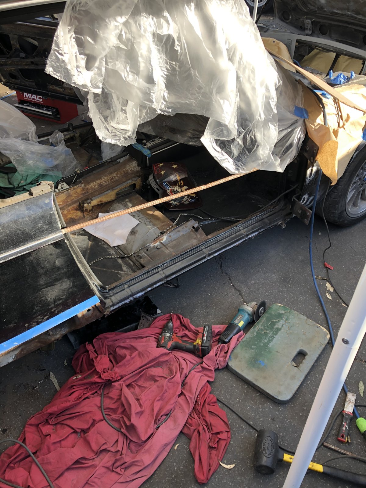

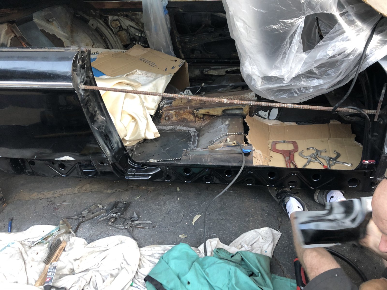

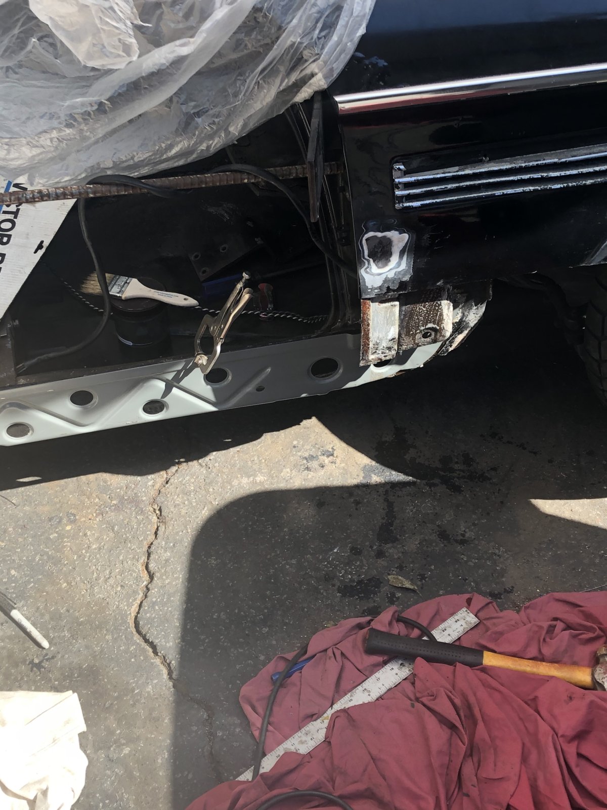

Rust repair begins
We used a bead roller and made all of the pieces ourselves

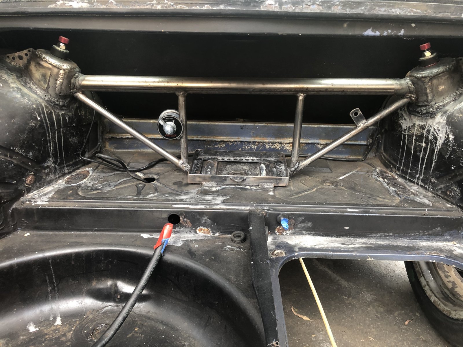

Taking a break from rust repairs to do something cool, rear brace !

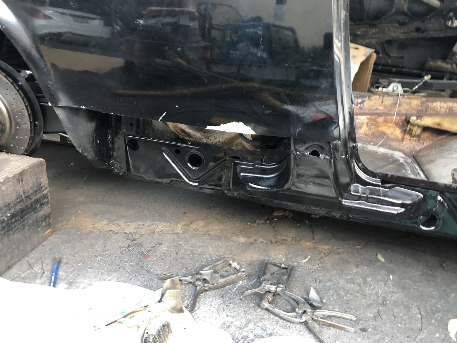

Time for the rockers

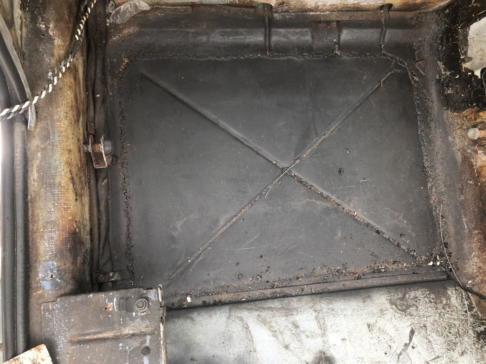

Inside the beast

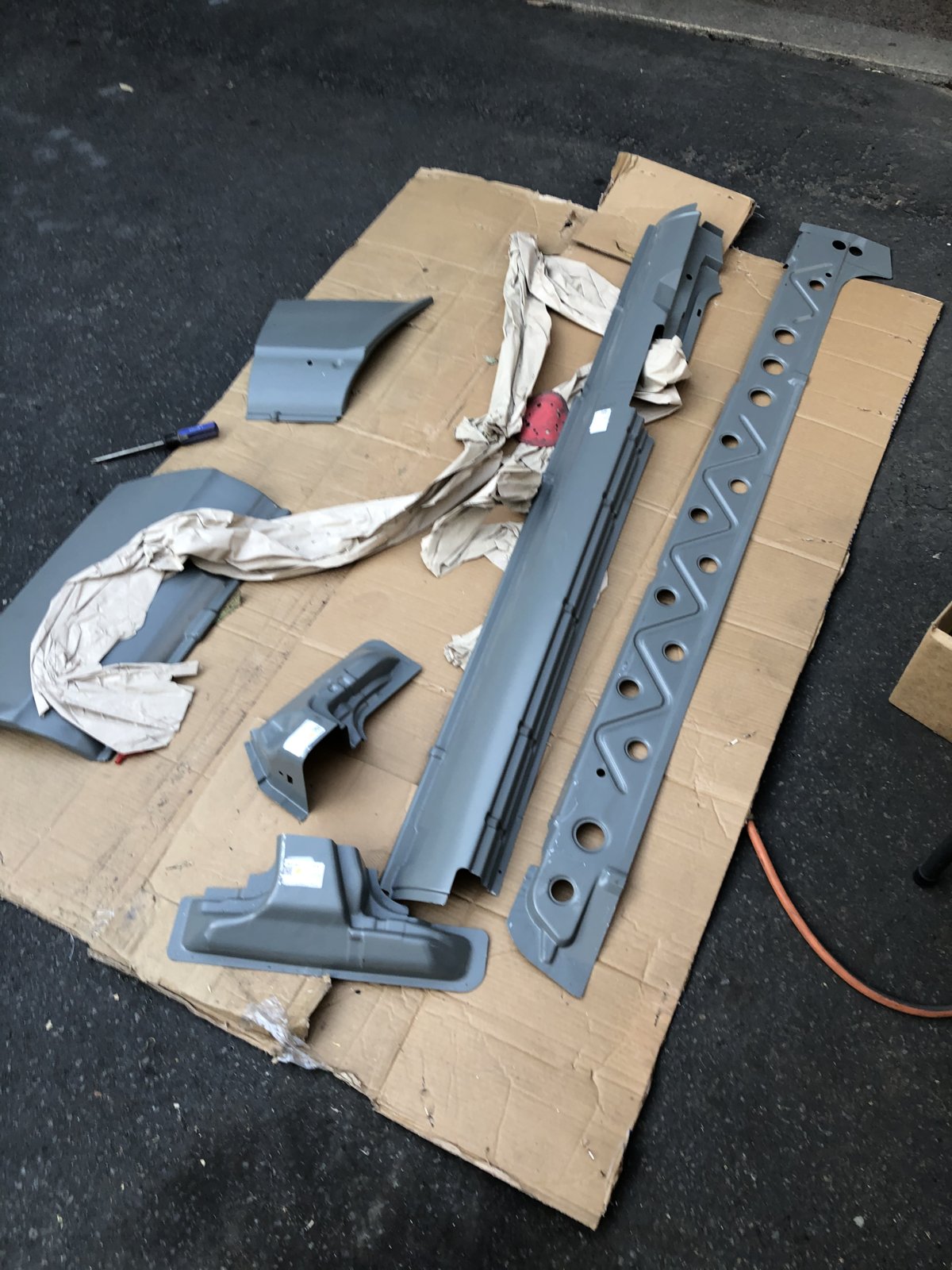

Replacements from Germany
Passenger side almost finished

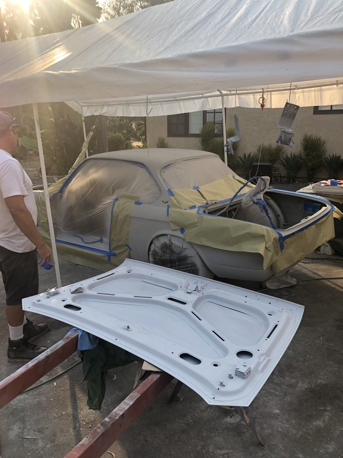

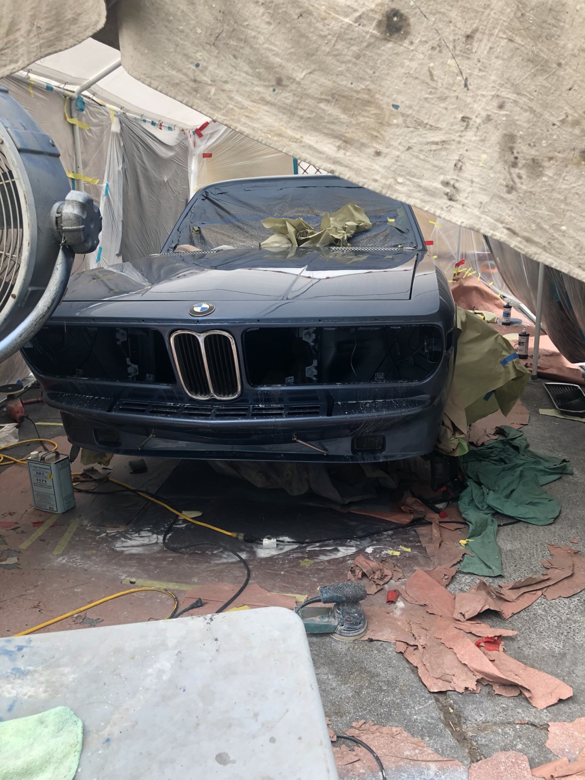

Primer and blocking sanding, lots of block sanding.

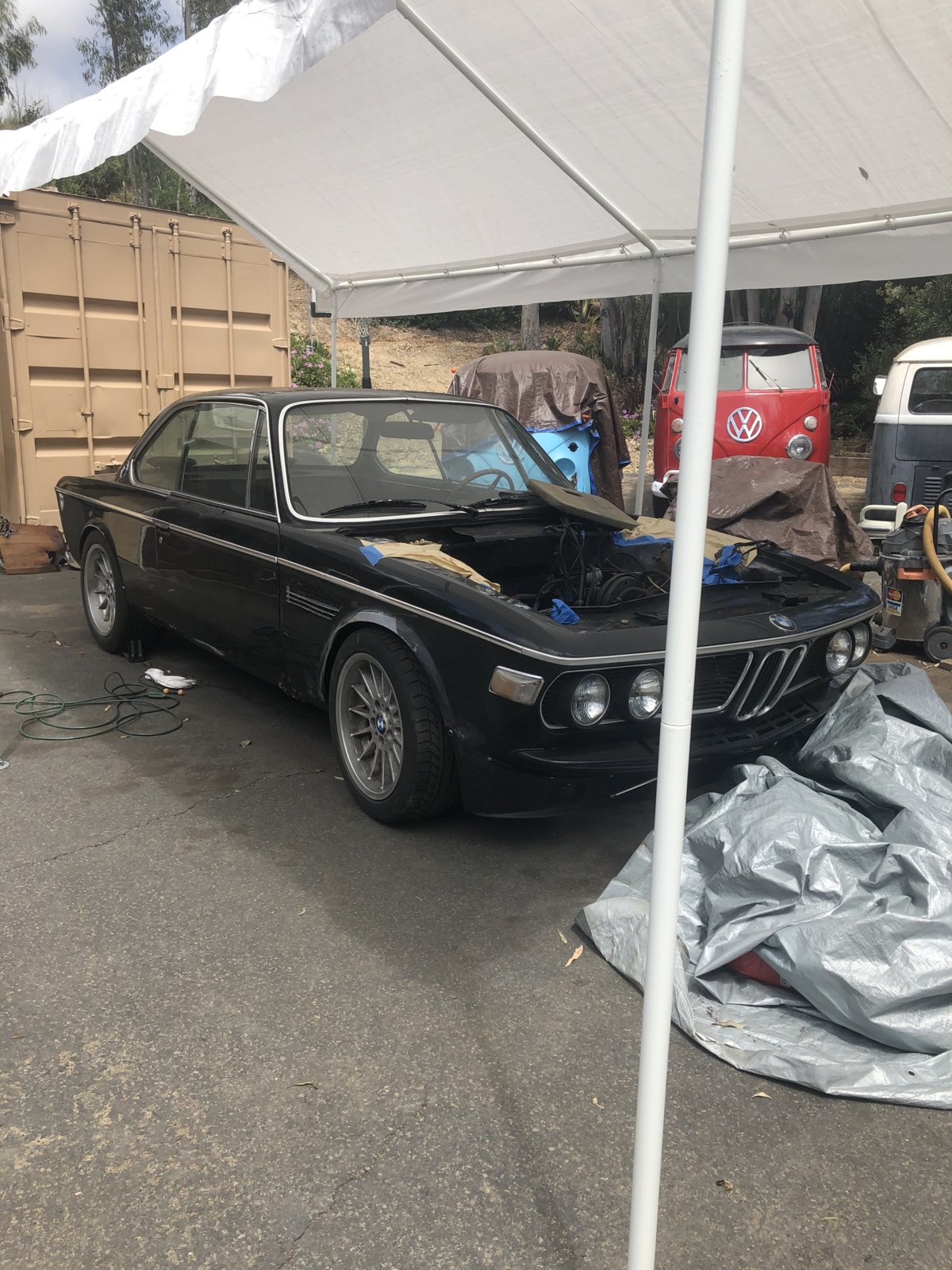

We covered the sides of the pop up cover and made a paint booth. It can great for a backyard paint job

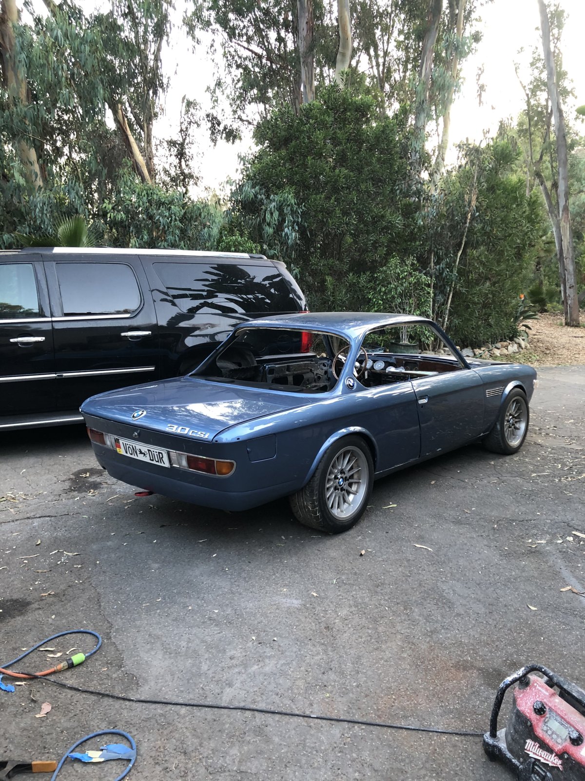

After block sanding and polishing reassembly begins
You can see the blue tow hook for a 2002, it fits great and is totally functional!

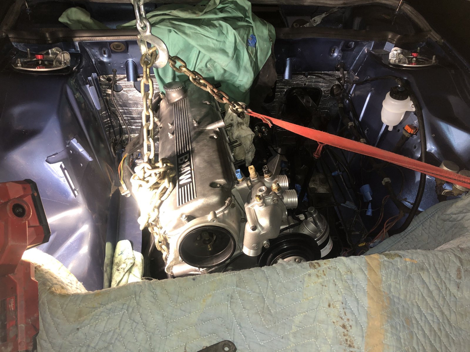

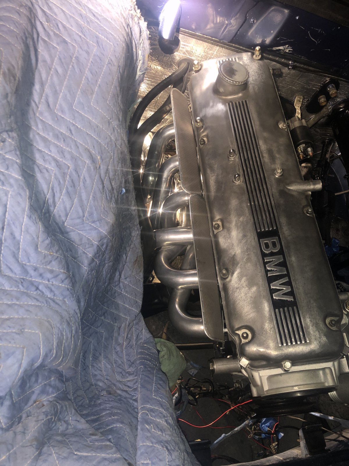

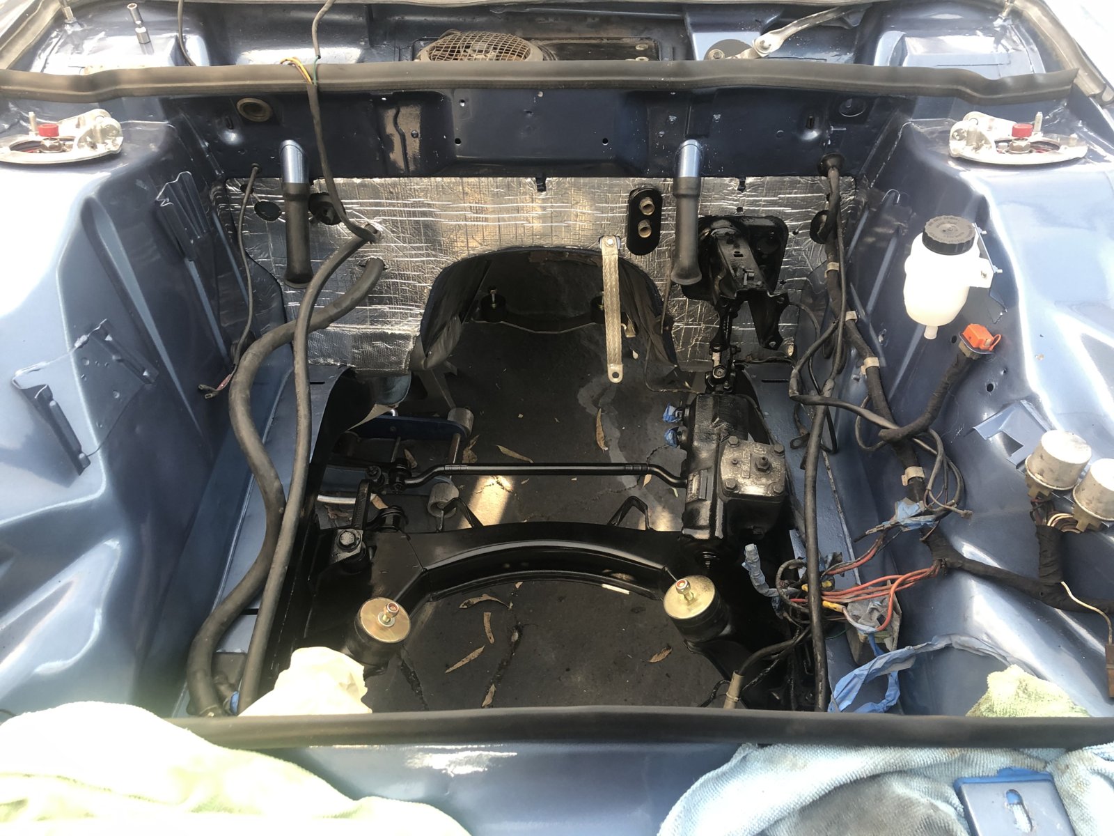

Working on the engine bay,
Coupeking heat shield installed

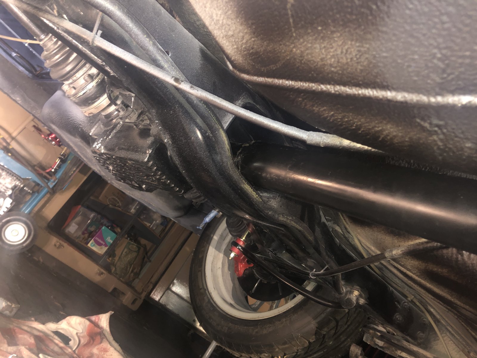

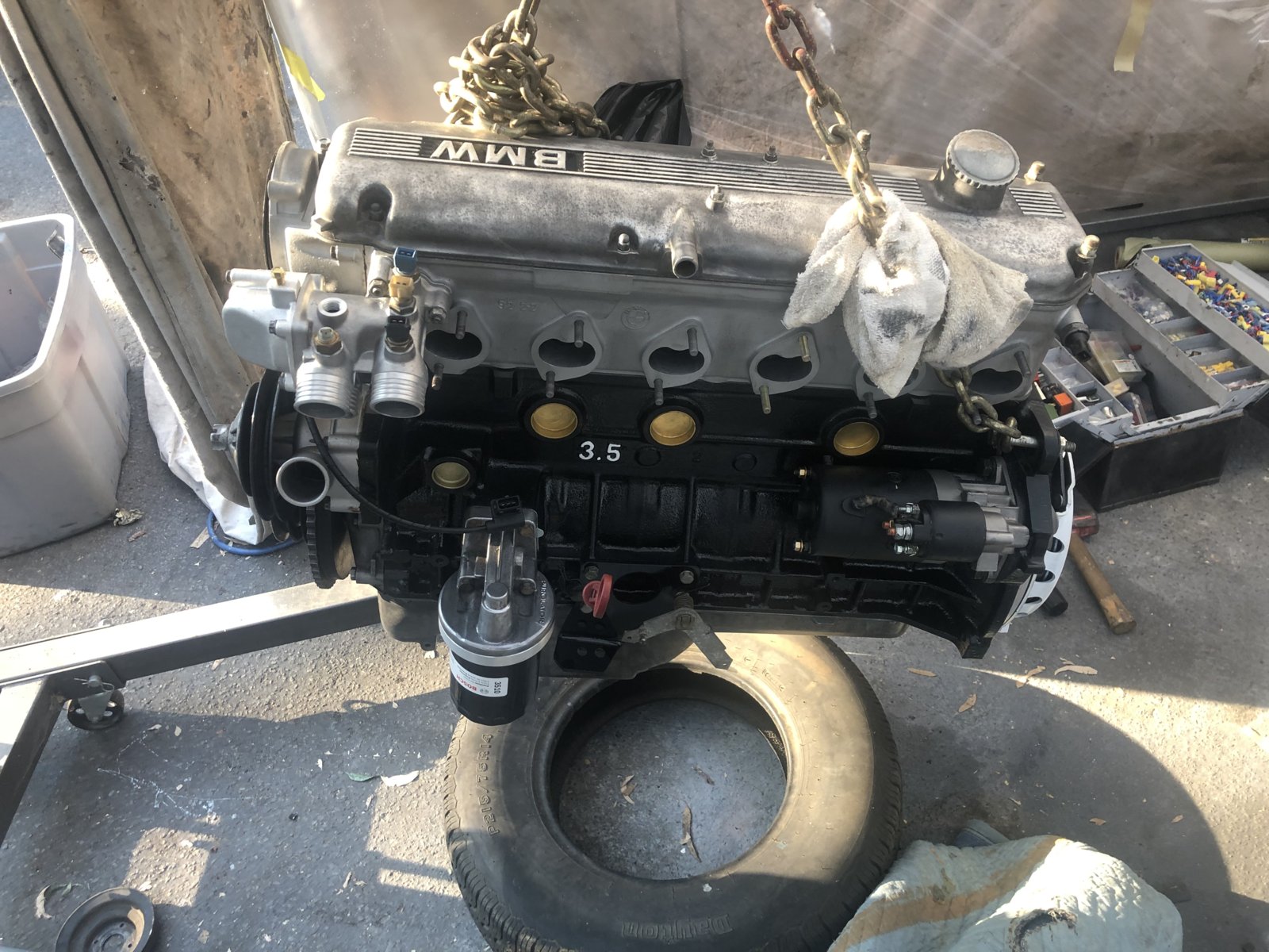

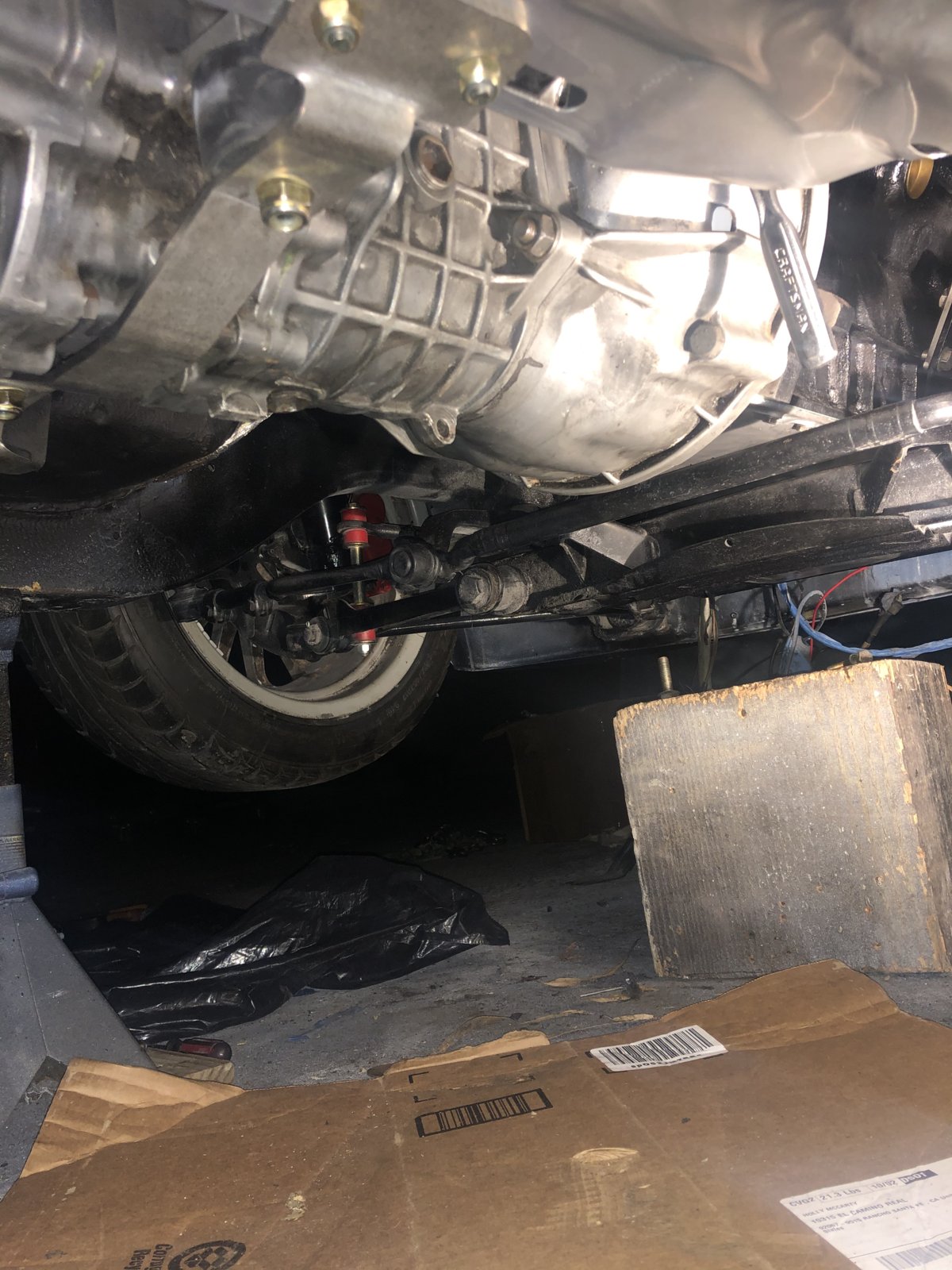

Rebuilt 1992 3.5 with custom JE forged aluminum pistons. It’s going to be paired with a five speed and limited slip differential
Engine, tranny, and differential are finally in the car as of two days ago
Ceramic coated tubular headers

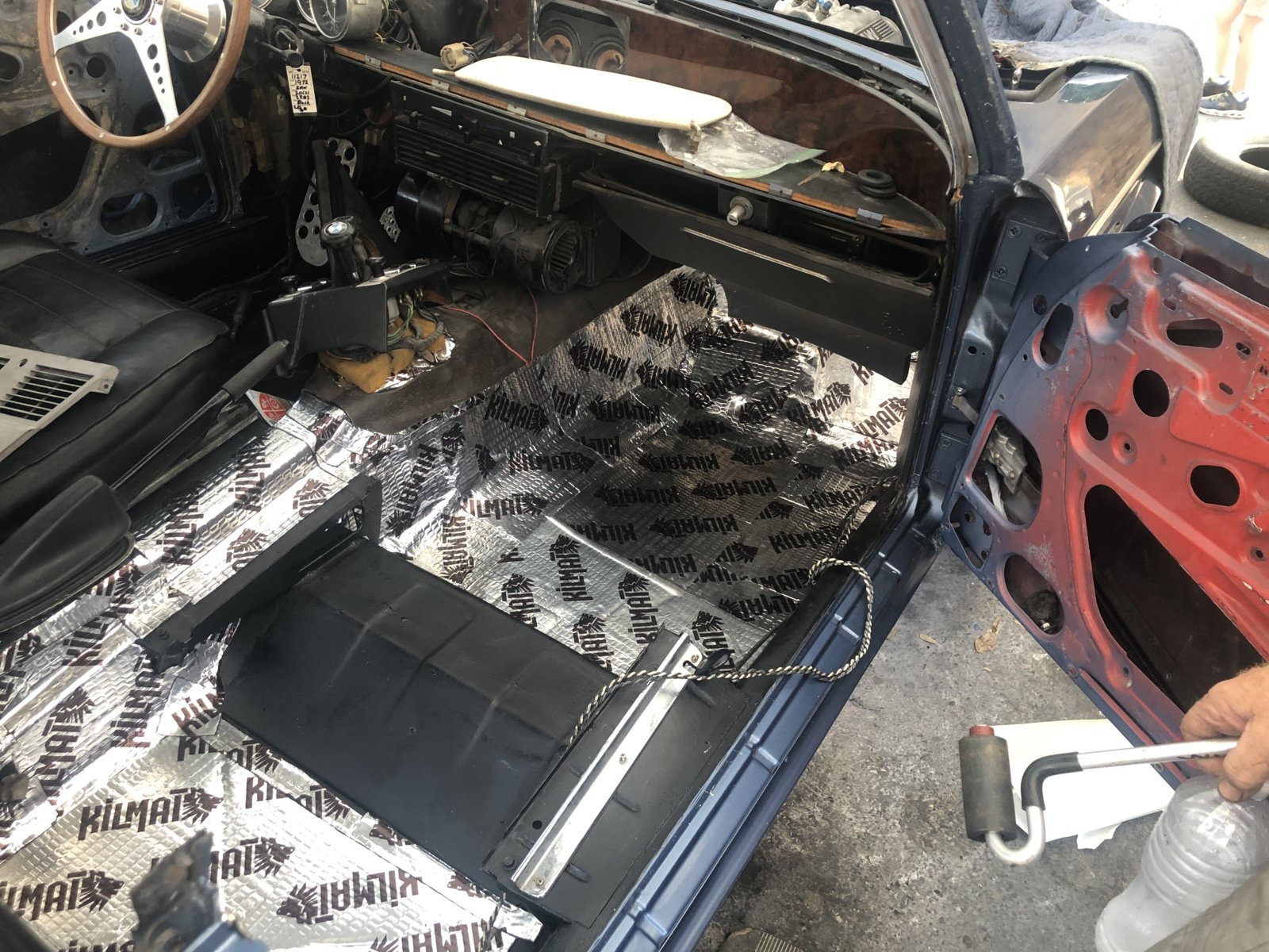

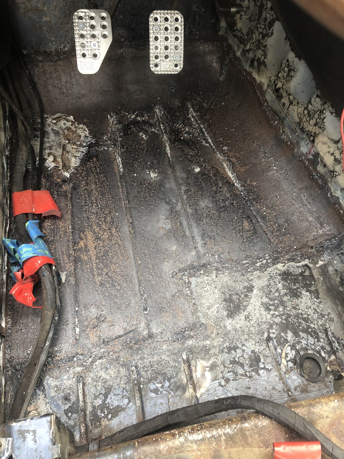

We placed dynomat like stuff down yesterday

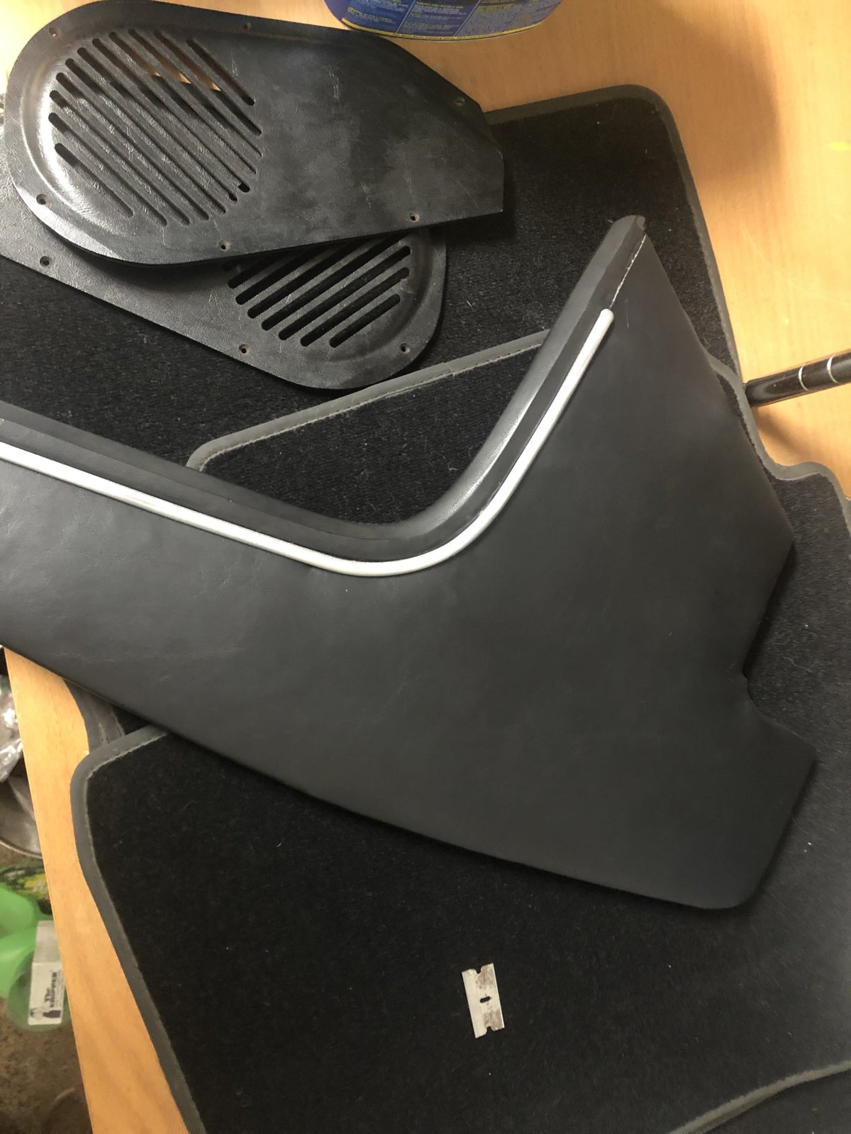

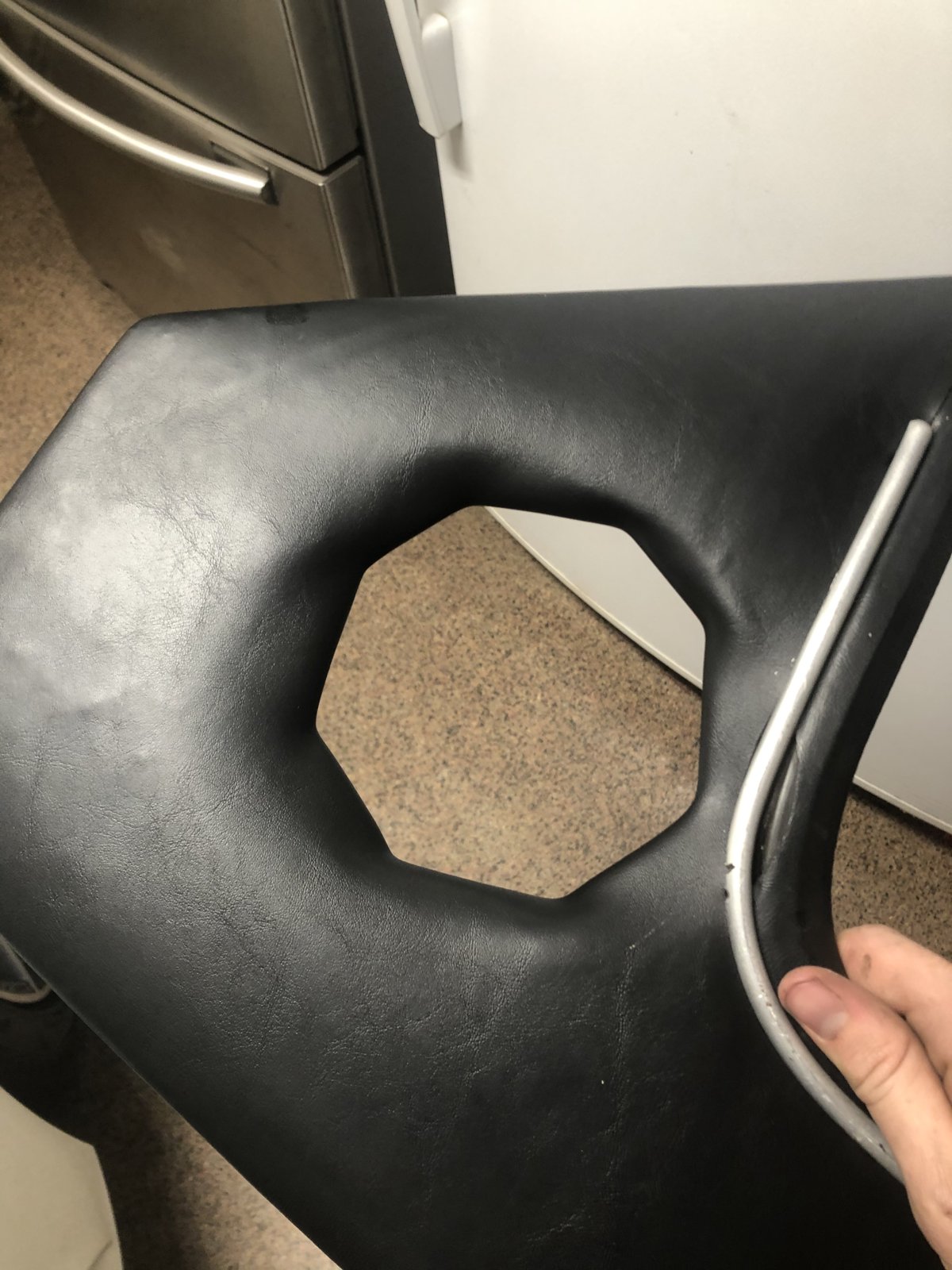

Previous owner ruined the side panels messing with the ac. A lot of stuff is missing, so I recovered the sides and am goin to use e3 side vents, looks like it’s going to workout just fine.
