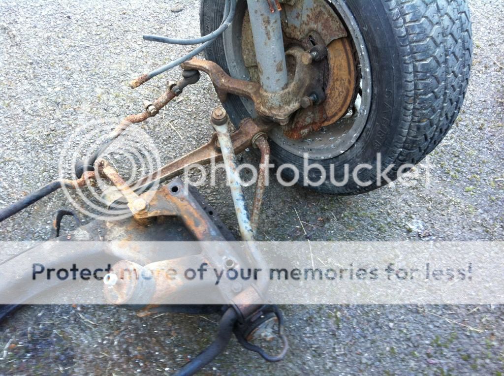

Where can i get hold of new ball joints? I dont want to have to buy new wishbones, and track control arms!
Chris (UK)
Your control arm looks to be in pretty bad shape as well, bushings have all dried out. You can buy both together with new bushings. Looks like you need tie rods as well?
My thoughts were to sandblast & powder coat. Then fit new bushings and ball joints.

Reviving this: is it possible to replace just the ball joint rubber seal? My joints are tight but my rubbers are cracked. And in any case, i can't find a source of ball joints or even complete control arms (only find the left side).
A long time ago I got a bunch of "rubber" seals for ball joints, etc in two sizes from a place in TX whose name I don't immediately remember. They were a fairly popular parts source then.... I eventually used all I had among various 2002s, 533i, 635CSI, 3.0CS and who recalls what else. So they are (were) available), I just don't remember where.
