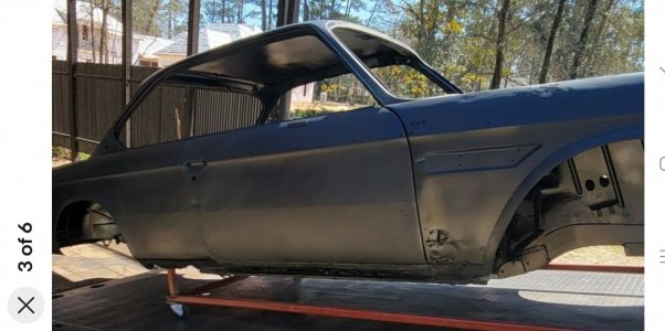

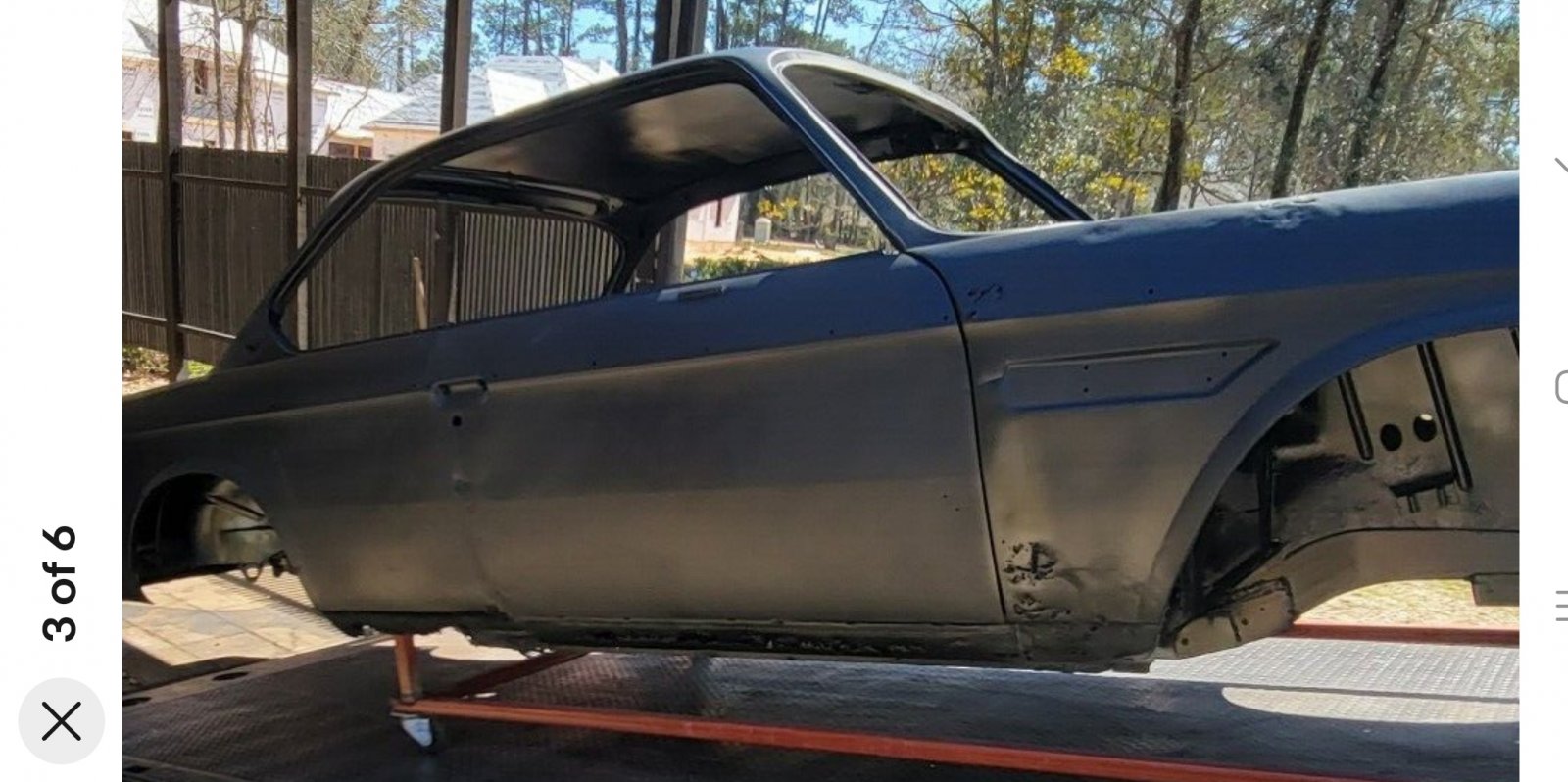

Ok, I see why they want to get rid of it.
Swiss cheese has less holes.
Top of fender
Middle of fender
Bottom of fender
frame rails patched
whole sill
a pillar lower
doorskin has holes

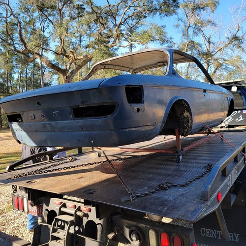

Rear sill / subframe mount gone
Rear fender left side is missing a piece. Left has holes.
Trunklid edge.
And that is what is visible on the pictures.
There's >1000 hours of metalwork.
Good thing is that this seems to be blasted, so zero surprises. No pig with lipstick on.
