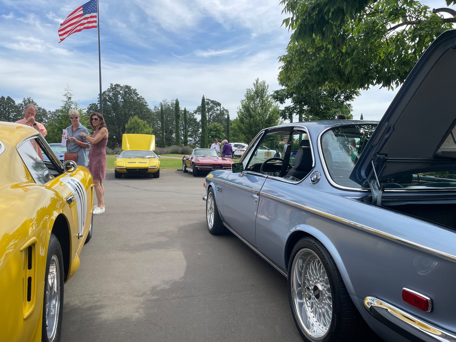

I have seen a few coupe’s with 17s - this one most easily comes to mind:
I have never tried 17s. I suspect, depending on the tires, the rear will fit, but you may have trouble up front.

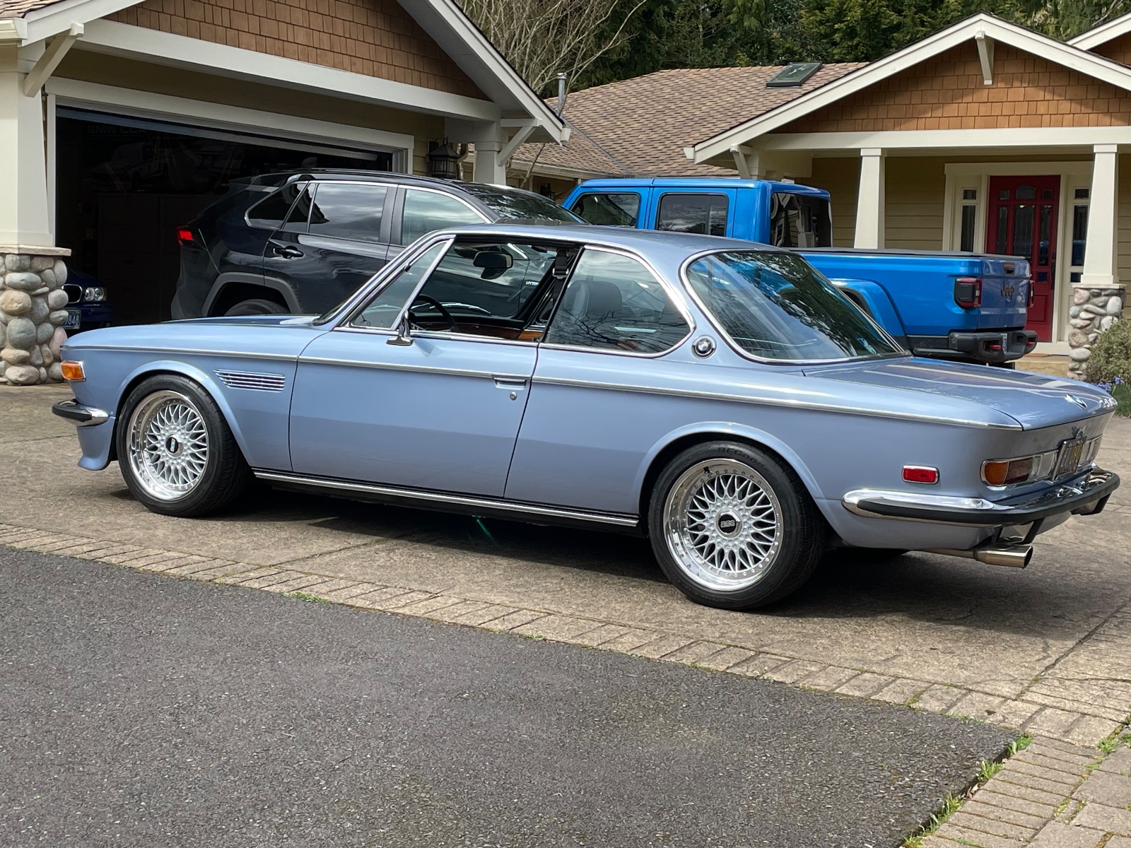

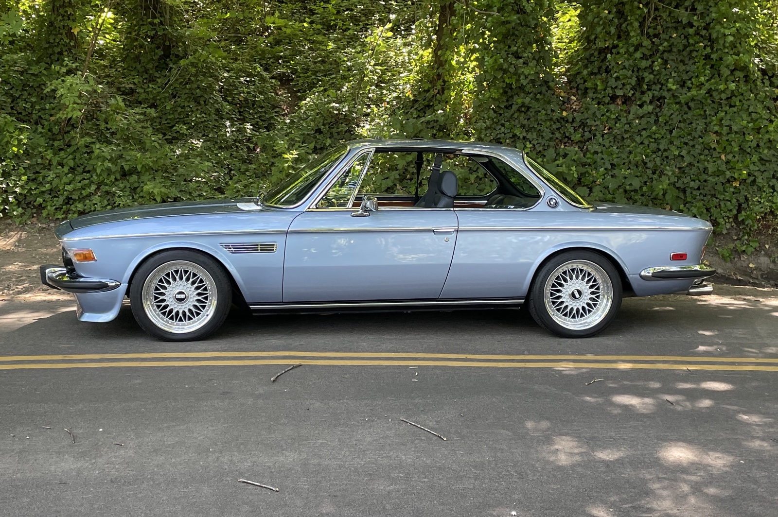

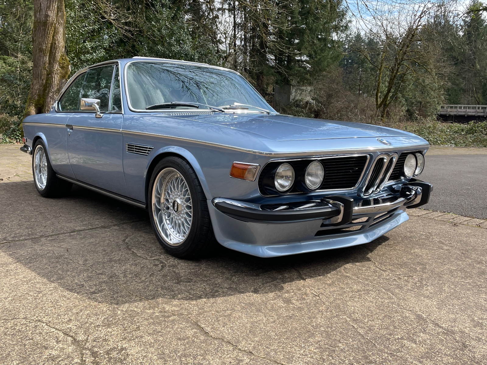

Thanks Scott! One of these days I'll get some updated pictures of my coupe. The wheels are staggered 17 inch style 5s (8&9s) with RS center cap conversion. You would definitely need to roll the front fenders to accommodate 17 inch wheels.
