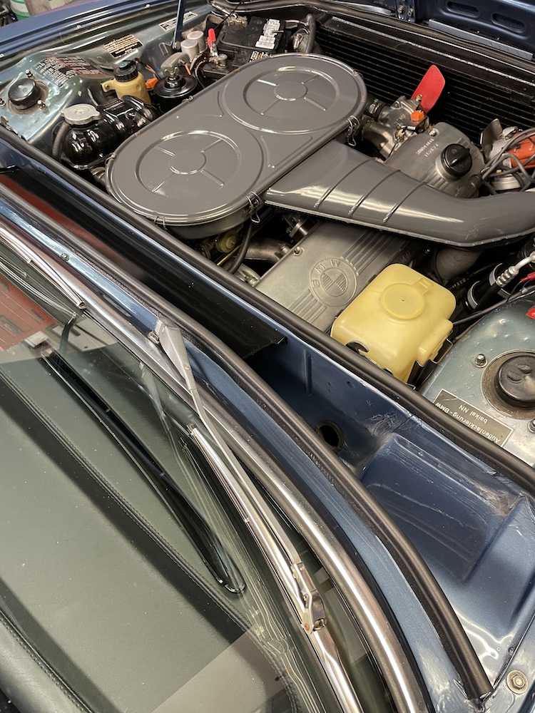

Hello all,
I'm looking to get replacement rubber seals for the engine bay of my 72 Bavaria. This is in reference to the front/forward (grille) and back (windshield side ) areas where the hood rests upon when closed. Even if I can't get the original, I'd like to determine what the proper shape / design is in order to get something comparable if needed.
Thanks for any help!

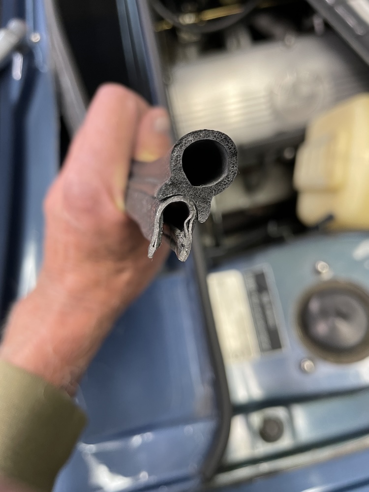

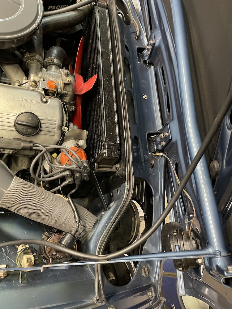

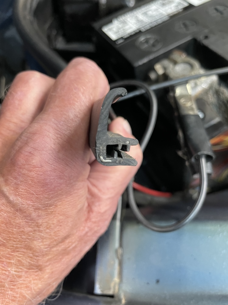

The seal on the front of the engine bay on my car is the original....
The profile is a little unique since it installs on a horizontal flange...
When I did my car, the seals at the back of the engine bay were missing and I couldn't find new. I did find one that I felt was close and seems to seal OK. I think I got them from Mesa. I used the same seal profile for the trunk seal.
Thank you! Thank you! Thank you! That's exactly what I was looking for! I may be able to find something similar now - McMaster-Carr has a potential for the front area style. I'll keep looking.
