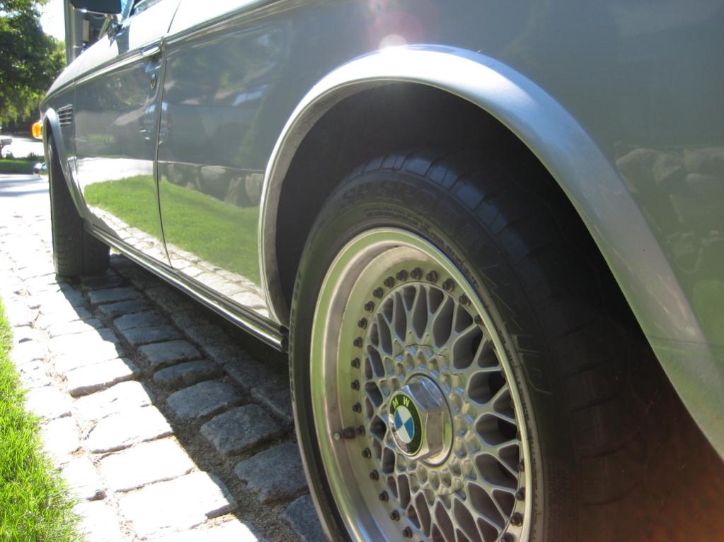

I have seen a few coupes with staggered 16" BBS RS wheels. Most are 16 x 7 (et11) and rears are 16 x 8 (et24). If you don't want staggered wheels would you just put on 16 x 7s (et11) all around? Sounds like you would but just looking for confirmation.
short answer: yes, 7" with et11 on back is fine.
photo of example: my car years ago with 7" BBS all around.
