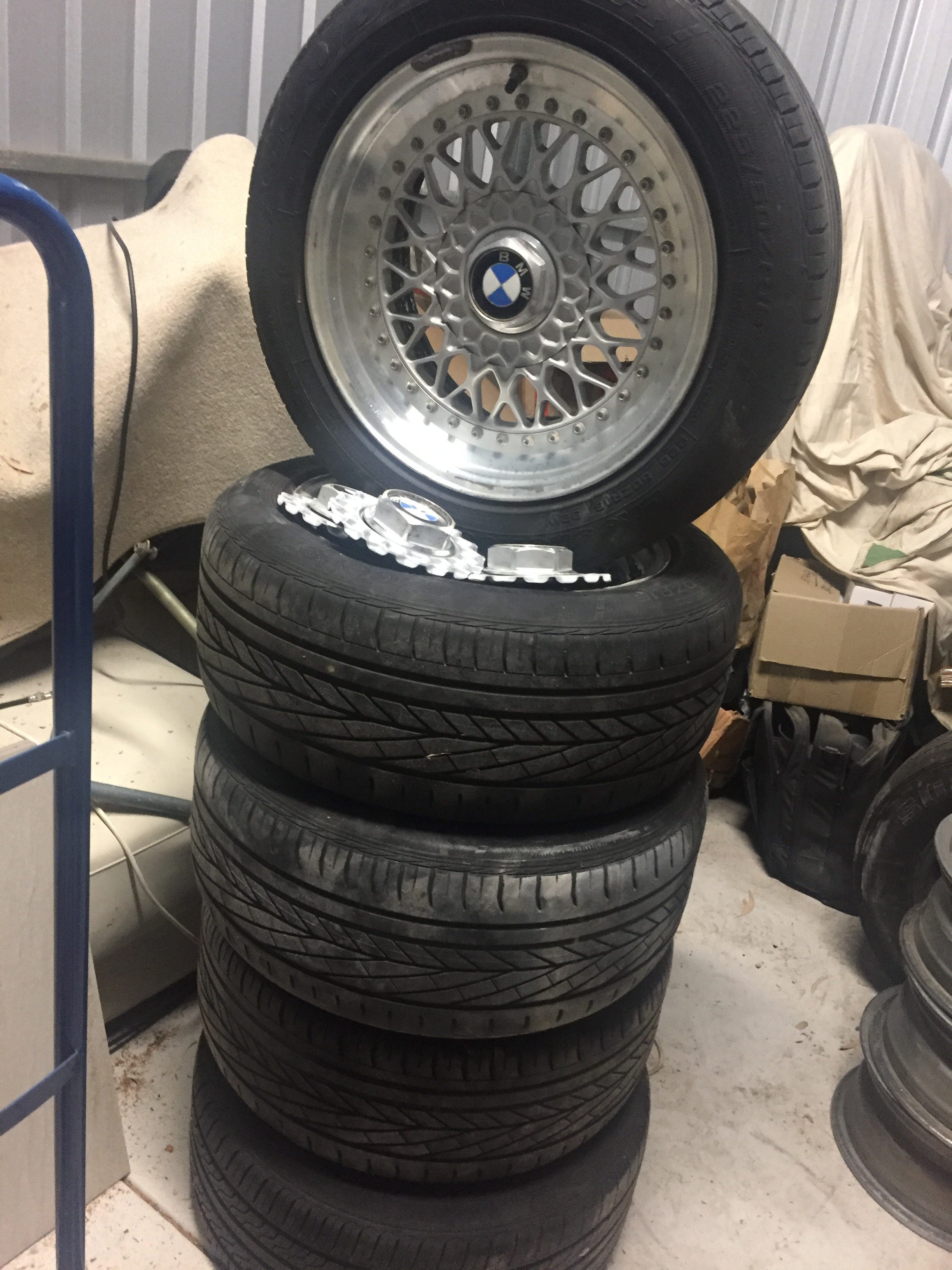

I have 5 BBS mags From my old BMW E24 1986 Australian delivered highline. MARKINGS on all 5 wheels are BBS 8J x 16H2 ET20 mag wheels. Made is W Germany
Are these worth more or less than a genuine set of period correct CSL Alpinas ?
They are in good original condition but they have never been restored. They looked amazing on the 635 as well as the e9
