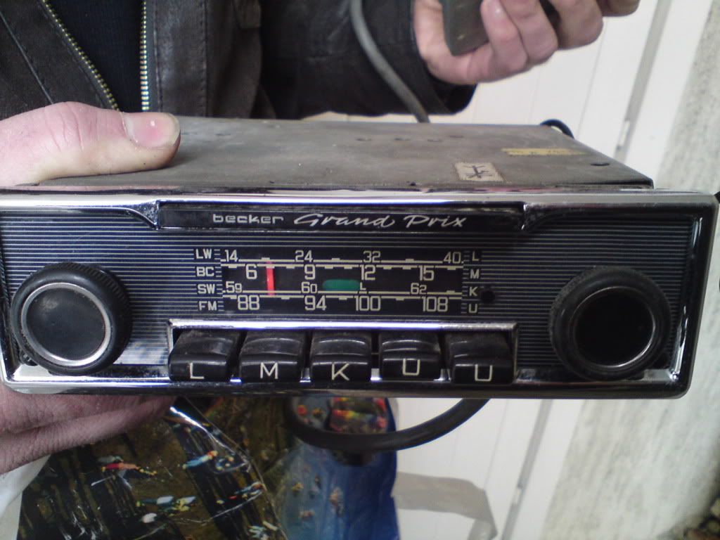

Could any of you post a pic of the above radio installed in a coupe?I just can't figure out how the face plate should be installed on the black front panel of the radio holder.

Which model number or a picture would help. There are several coupe owners who have Beckers of the early 70's type including the seperate cassette in the glove box. But the Grand Prix went through several changes, for instance Mercedes with a full face DIN; rather than the earlier versions.

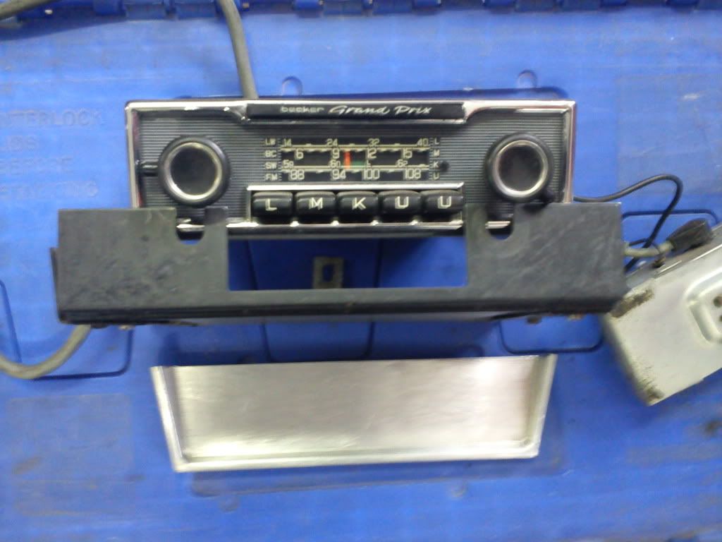

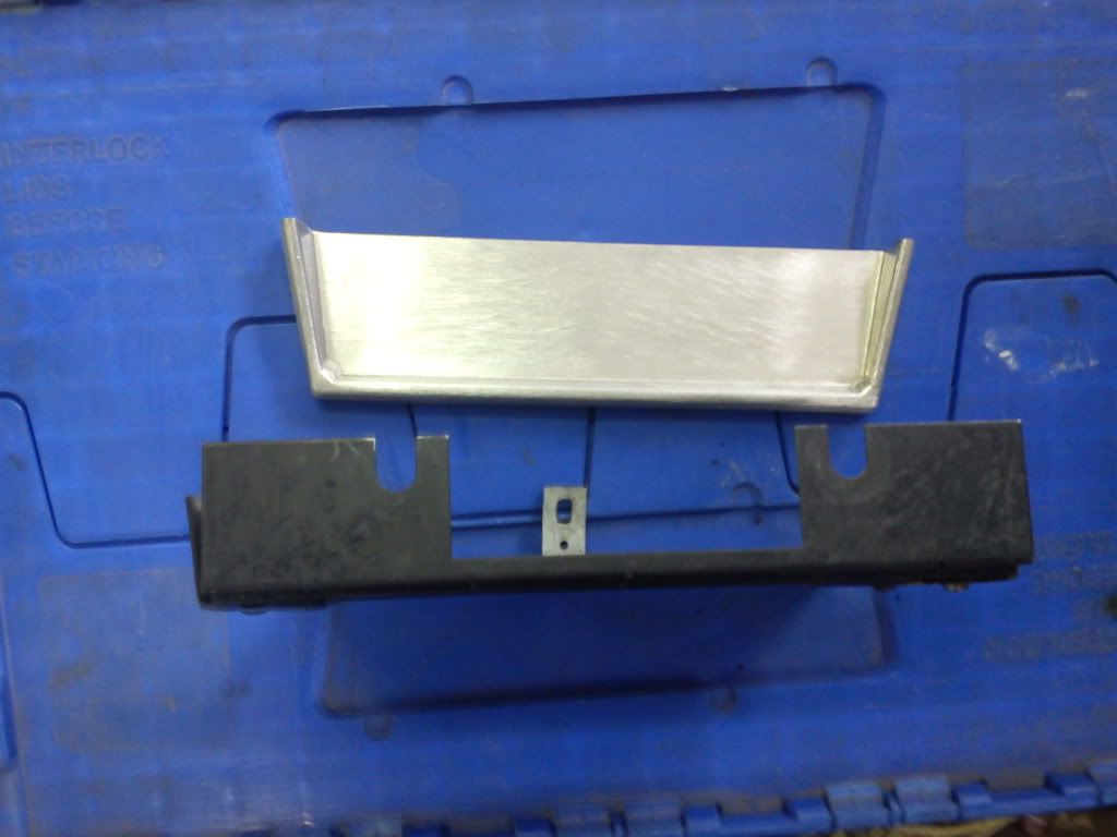

Do you already have a radio holder for non A/C console? I did not so I had one made. Later on I saw originals on Ebay.
Mine looks like:
http://home.earthlink.net/~b_jamin/sitebuildercontent/sitebuilderpictures/radio.jpg

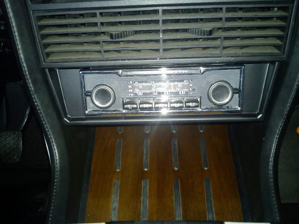

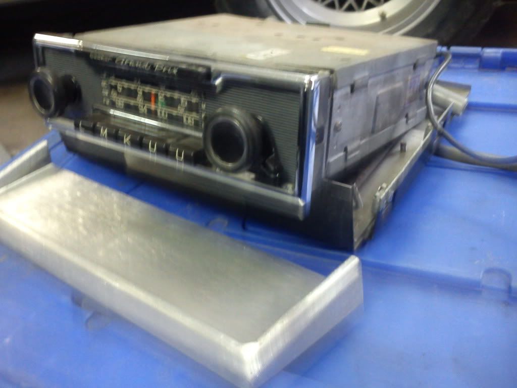

Once you have the radio holder you remove the knobs and faceplate from your radio, present your radio from the inside of the holder, the faceplate and knobs from the outside and button them up again. Depending on the holder you may have means for supporting the weight of the radio along its body.

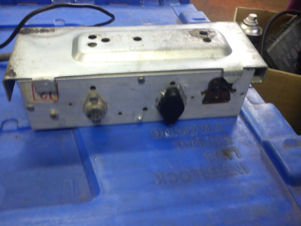

That extra box is the power supply and there should be a shielded cable that goes to the radio itself. Faceplates do come off but they are designed for a DIN sized opening to mount. I used a similar mount to yours for my Blaupunkt to mount in the 2002 console.

This will help too.. disregard the Bav and look for coupe console pictures.
