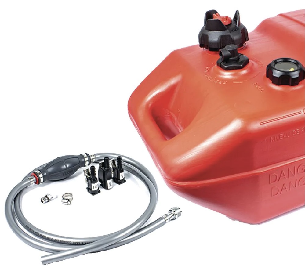

If your line seems okay, you can run a boat gas tank to the pump. Prime the line with the hand pump. This is how I drive my car home when I bought it. I didn’t want to run the old gas through the motor.
