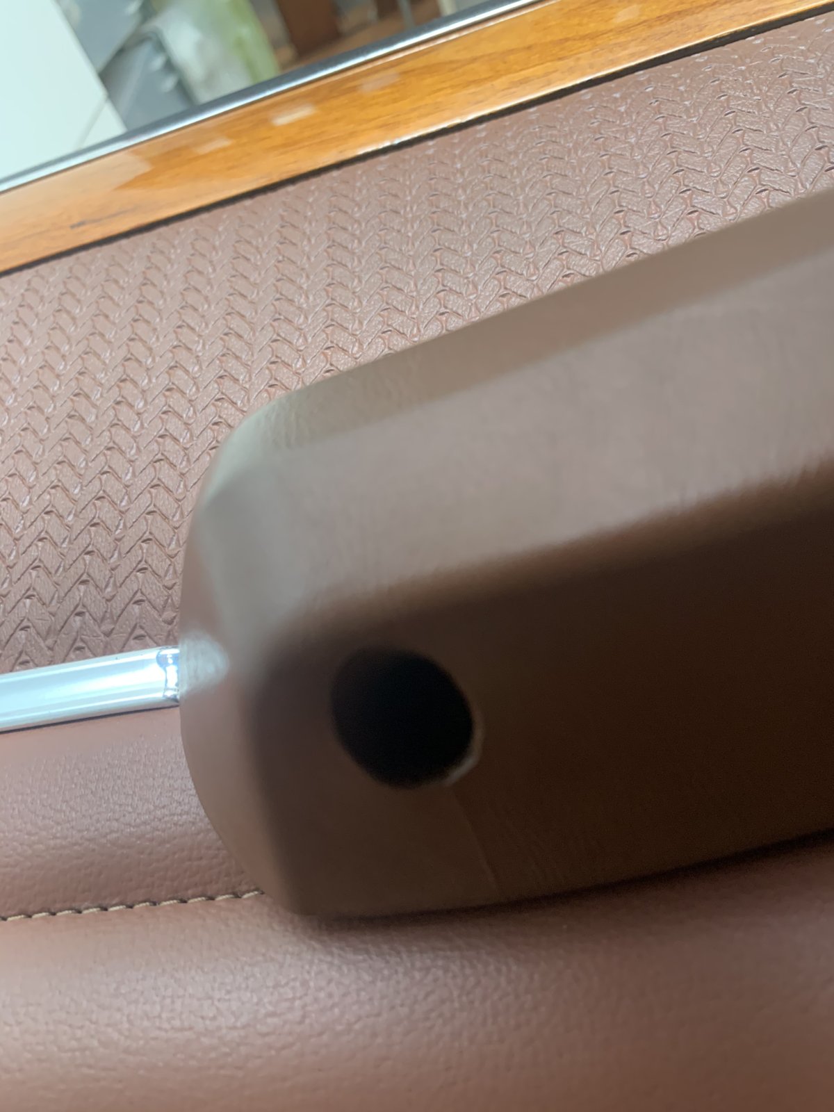

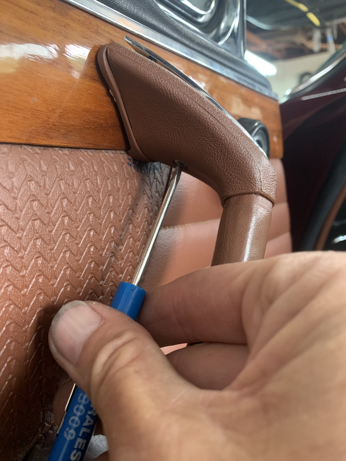

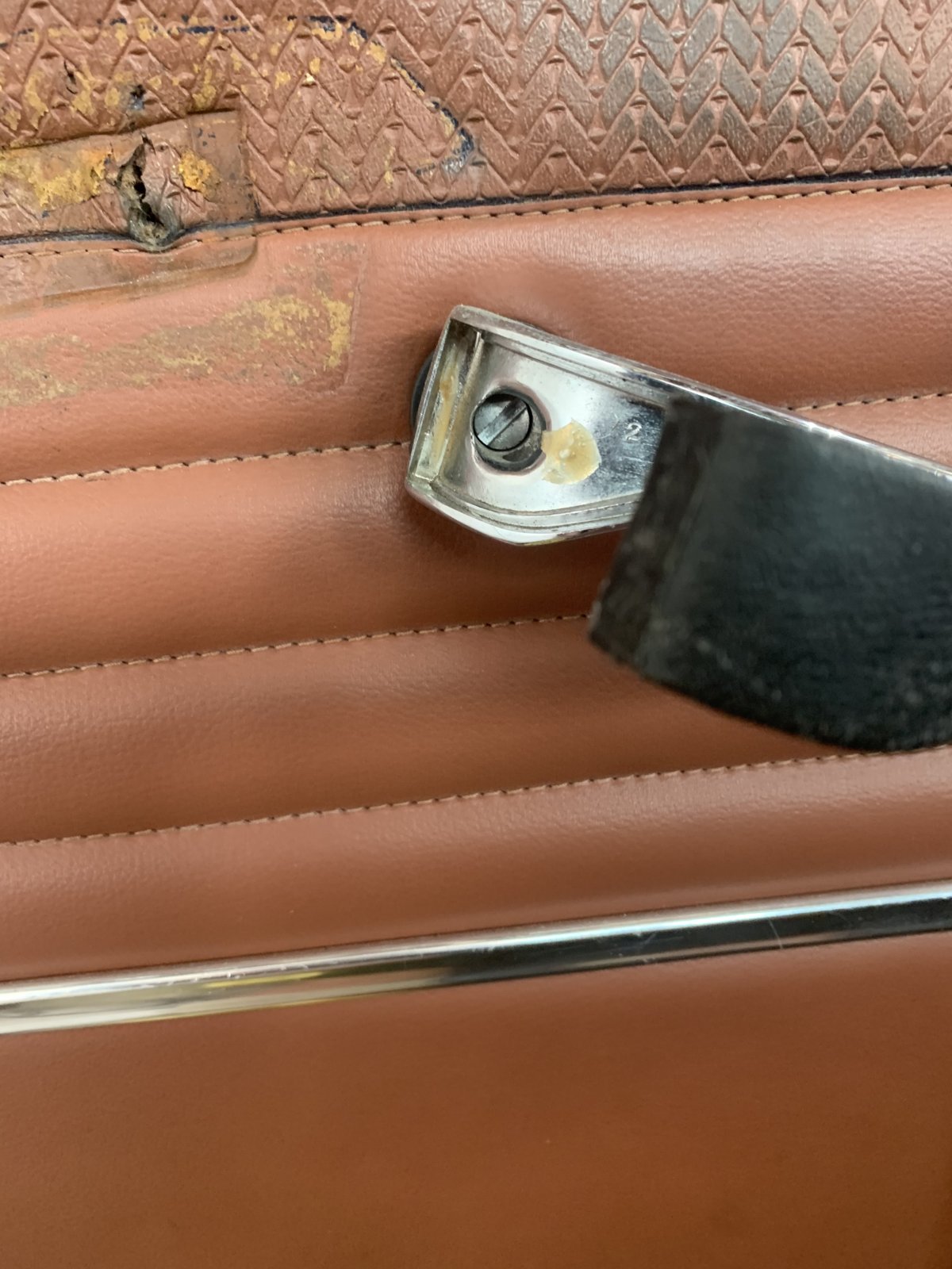

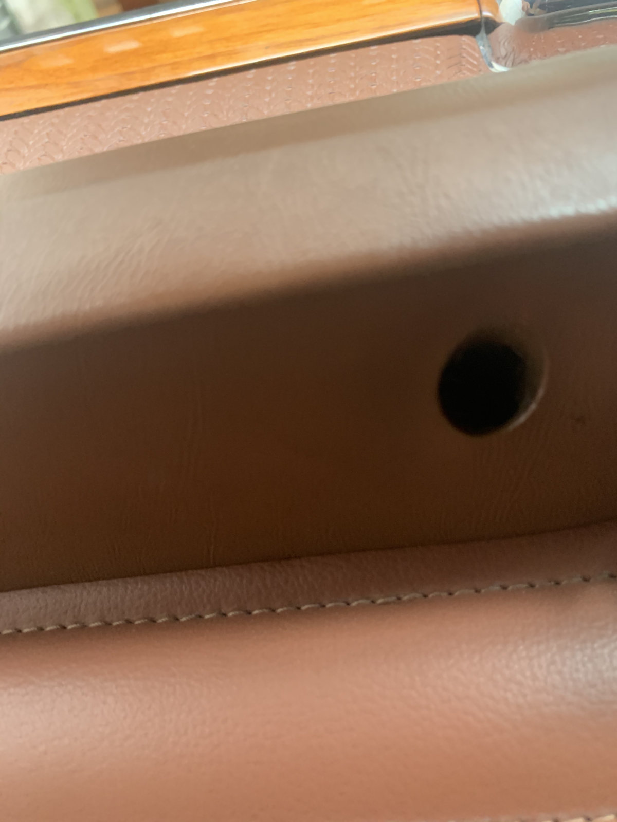

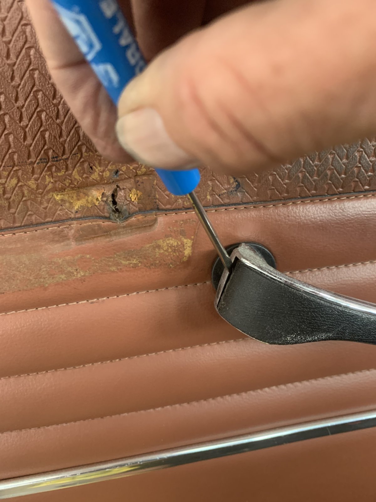

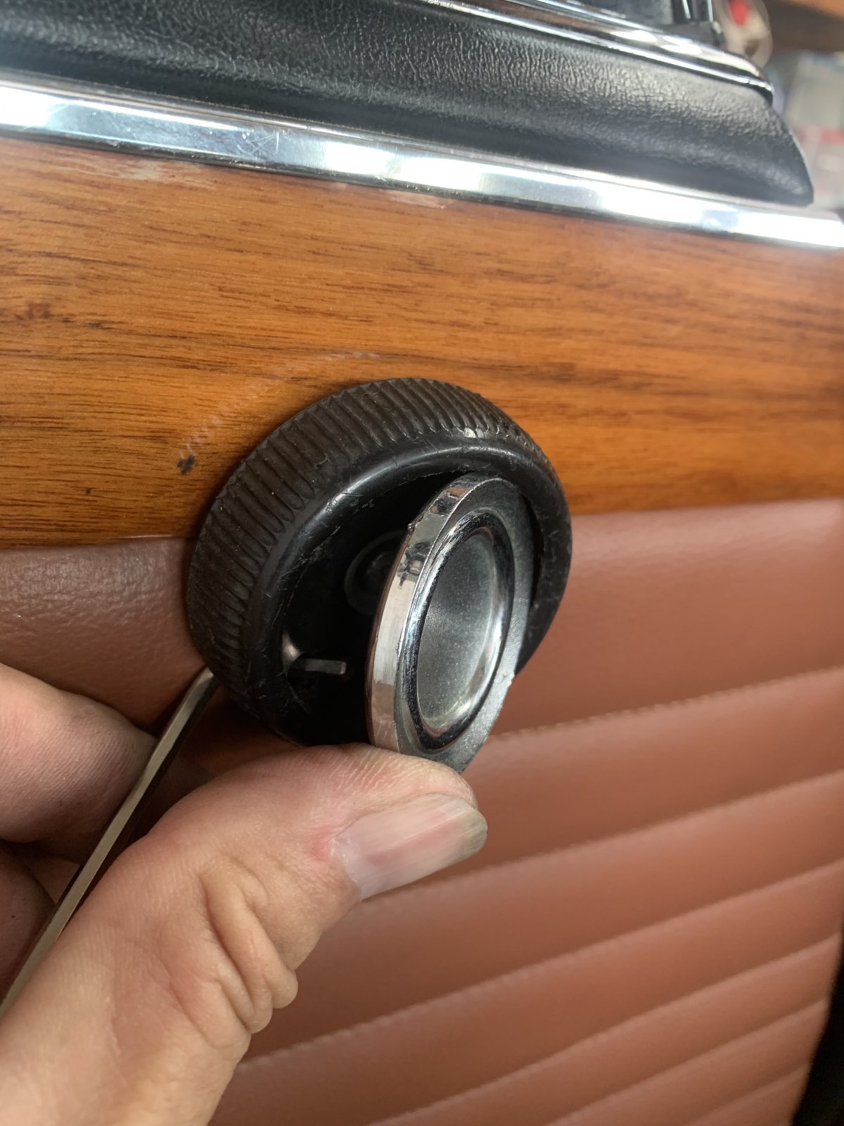

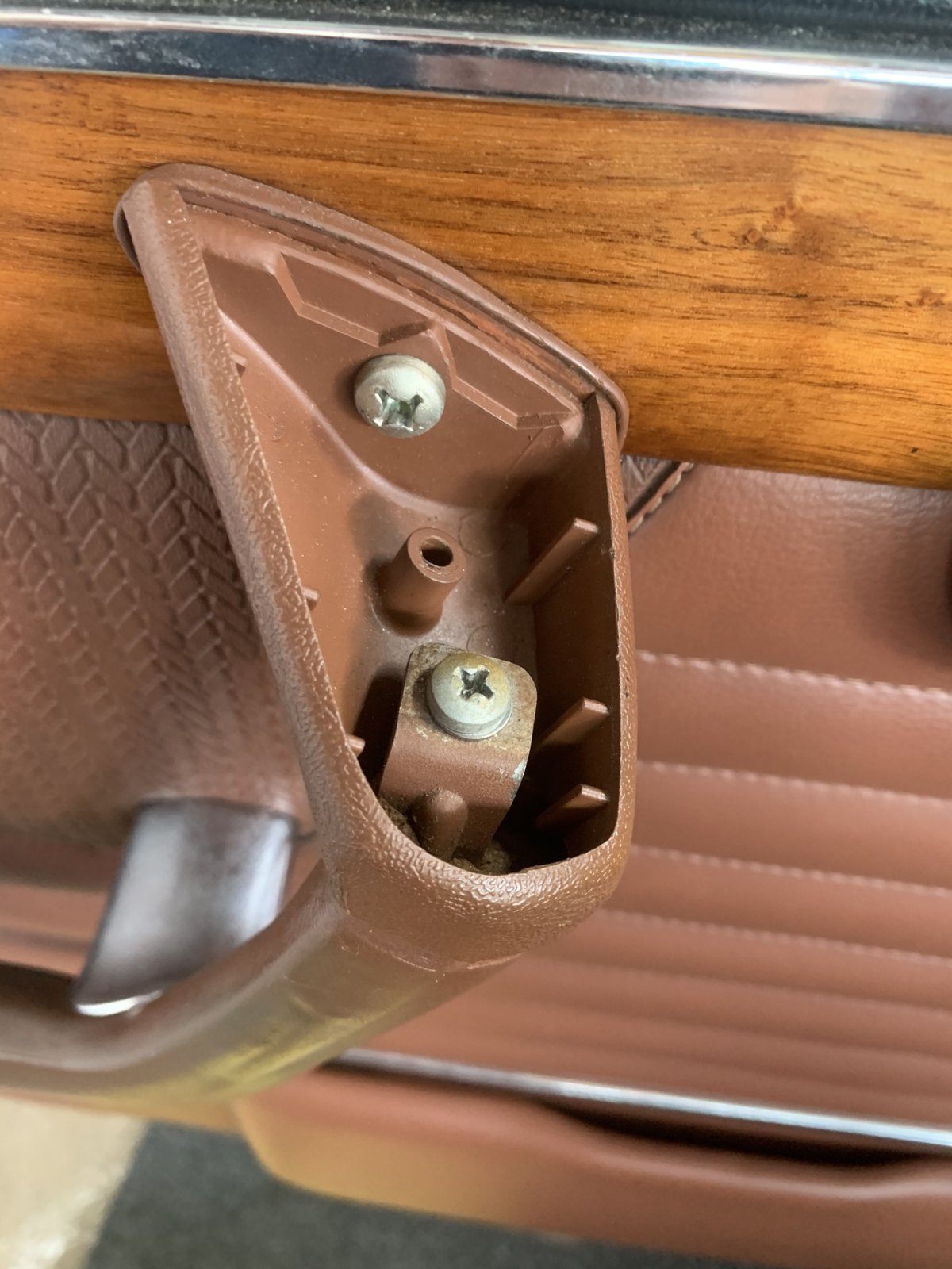

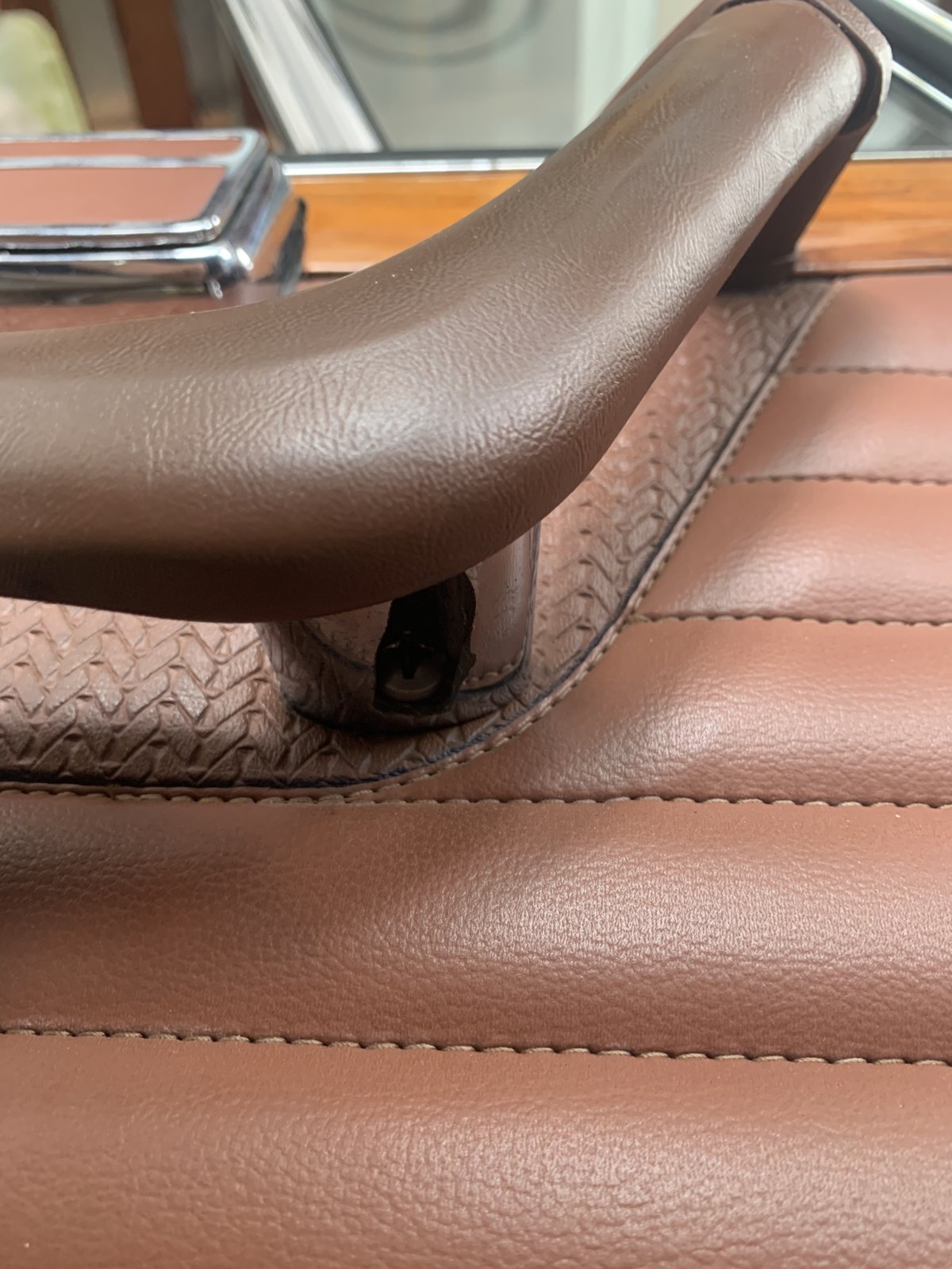

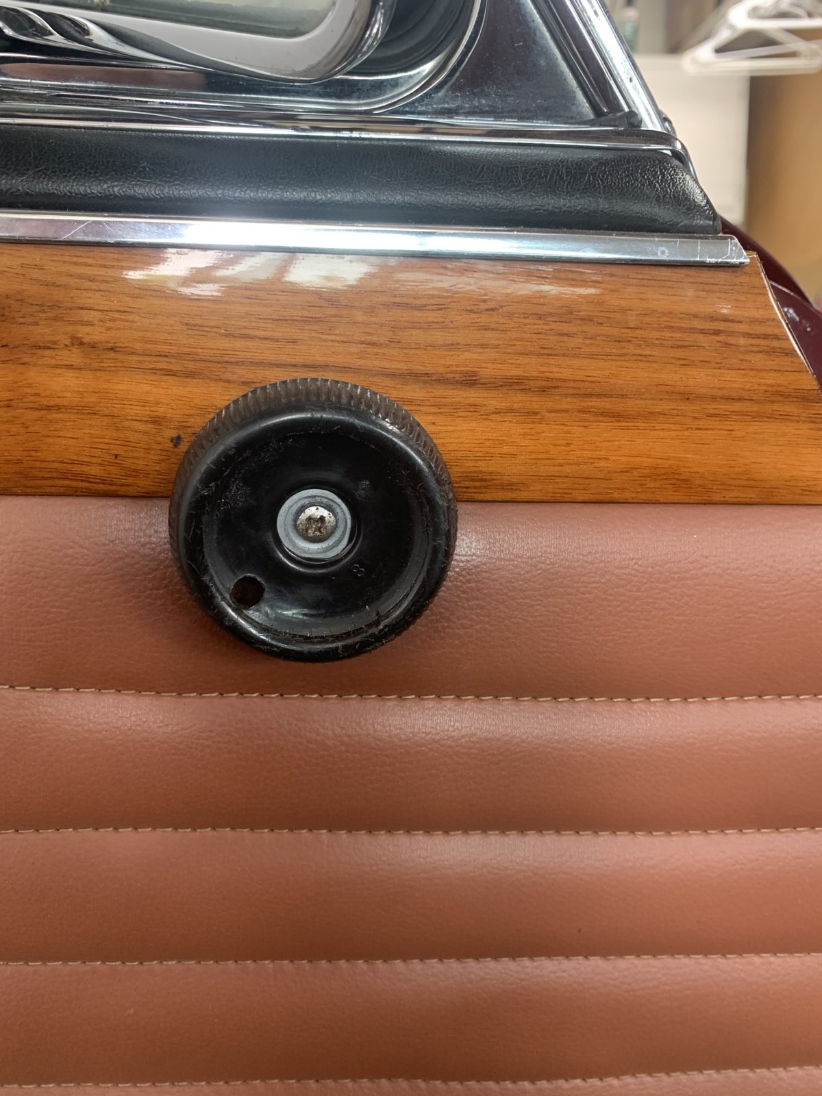

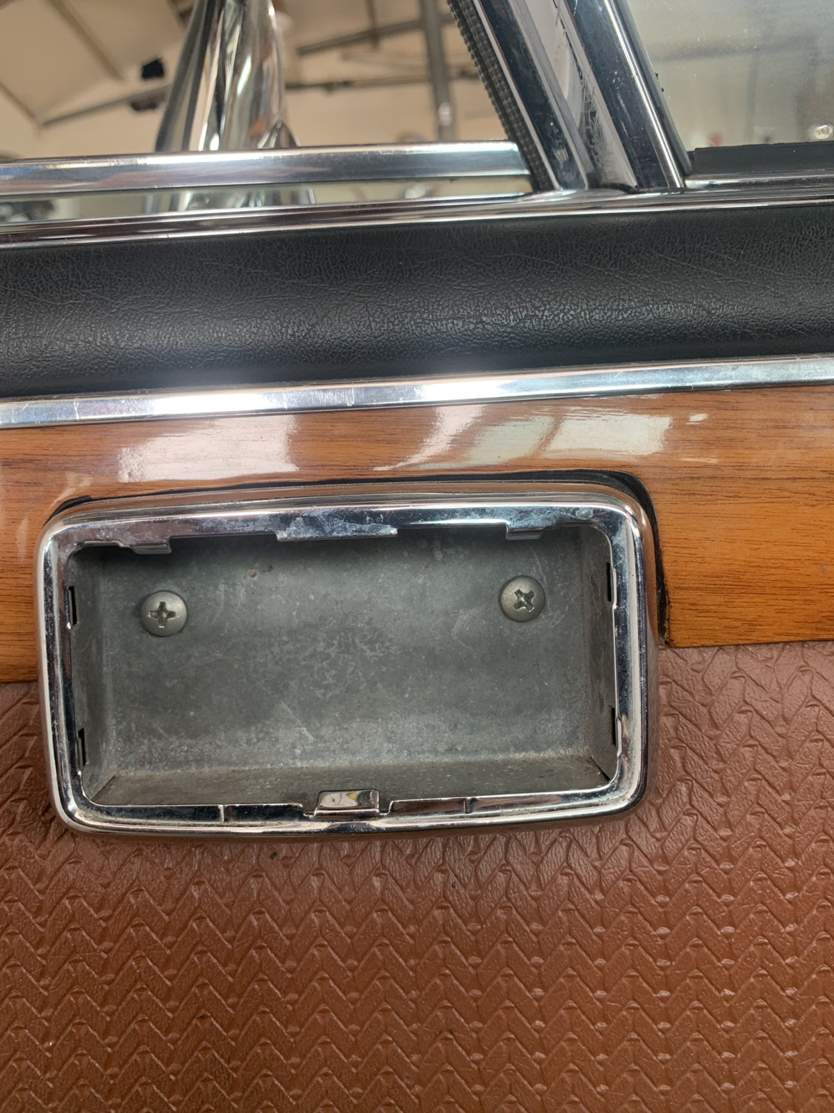

Chris' photos provide a great tutorial on where all the hidden fasteners are. Two more things from my experience:
- The ashtray and vent window knob don't need to come off - the door panel will slide out from below them.
- Lining up your philips screwdriver to catch the two, large, self-tapping screws that hold the armrest can be a bit of a pain. Easiest to do lying down / looking up, with a light in one hand and your screwdriver in the other. Replacing these screws can be tough as well - hard to get them at the right angle so they catch their receptacles.

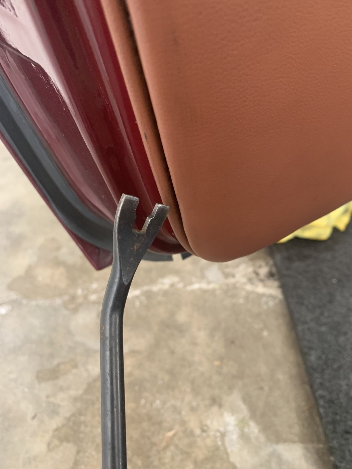

2 metal putty knives slid under on either side of each clip then simultaneously leveraged up will give you a decent chance of separating the card without breaking the now very fragile old clips.
Thank you Chris for these great photos! A picture tells a thousand words!!! Is that pry bar a special item so you don't break the clips? Where does someone get a hold of one of these contraptions?
Yes, made for panel clips, probably at Autozone and such but I like Steve’s suggestion better.
