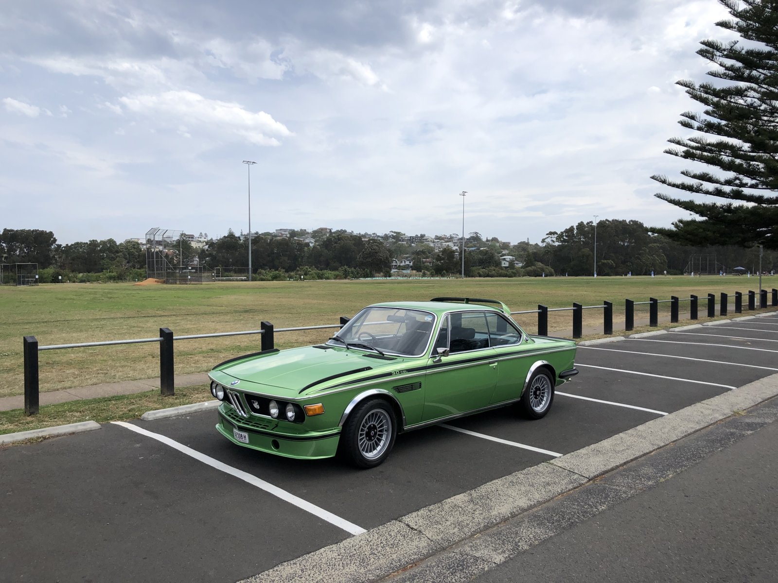

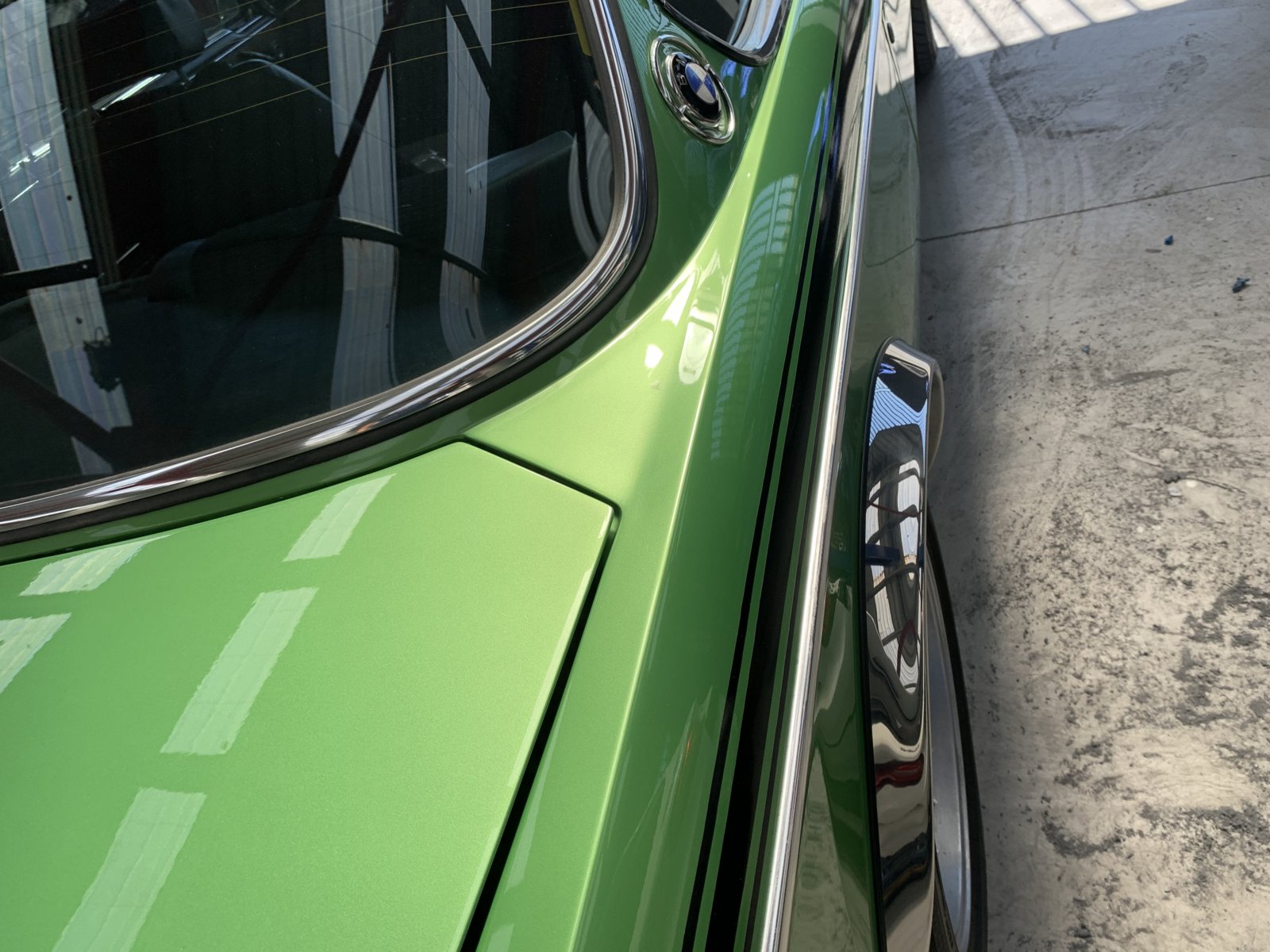

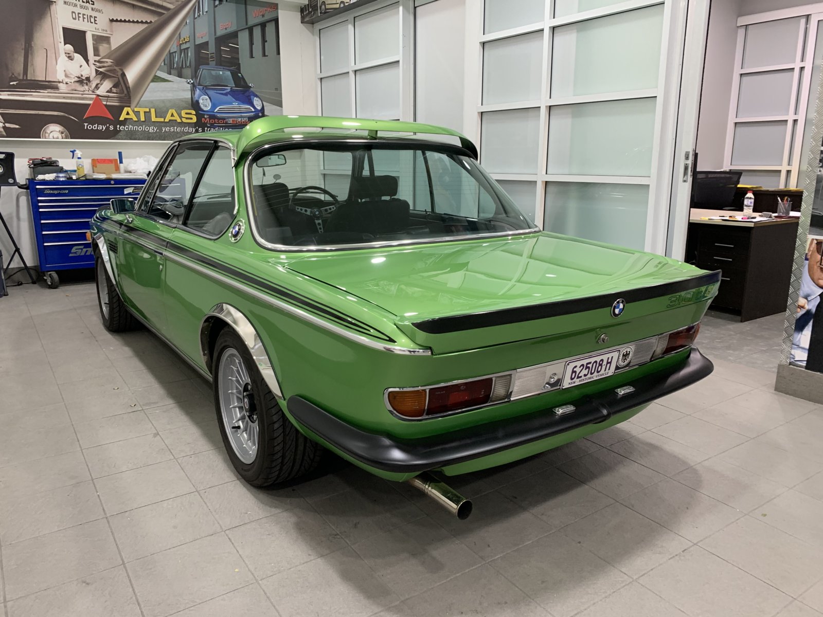

I have just gone through such an exercise as I needed to get my alloy boot painted and a spoiler installed. My body shop used Glasurit (BASF) so I would recommend this. I had a lot of hassle with the matching of the metallic paint. My body shop had to call in the senior tech guy from Glasurit Australia to help in the matching. Whilst they start with using a computer in the end the Glasurit guy's human eye was needed for the final adjustment and he was more accurate than the computer. Many attempts at colour cards before they finally got it right. He told me it was a 100% match but in the end I would say about 99.8%. Me and the bodyshop owner know it's not 100% but no one else would notice. It's just the way the silver metallic flakes sit apparently, and no-matter if the colour is 100% the tiny sliver metallic flakes are troublesome little buggers.
I could have got the whole rear blended up to the C pillars and down to the belt trim but that would have been more expensive and I would need to replace my decals too.
Due to the kinks at the sides of the boot this helps avoid any sense of colour matching issues. However if I was doing a door or front fender like you are Steve 100% you should blend into other panels otherwise I think different paint would be noticeable.
