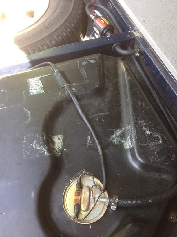

I'm using a rotary Facet pump, which is smaller than the Carter. Nice and quiet. I used existing holes between the fuel tank side and the spare tire side.
