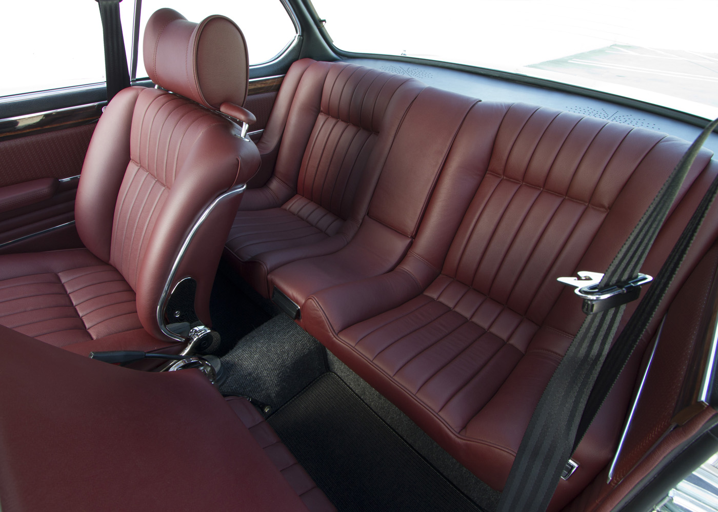

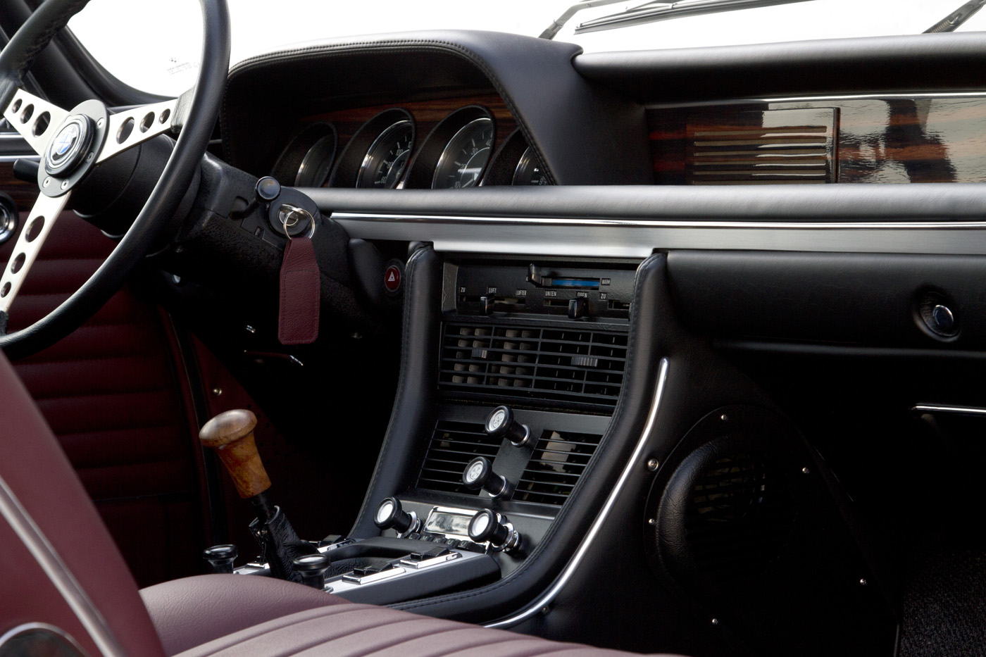

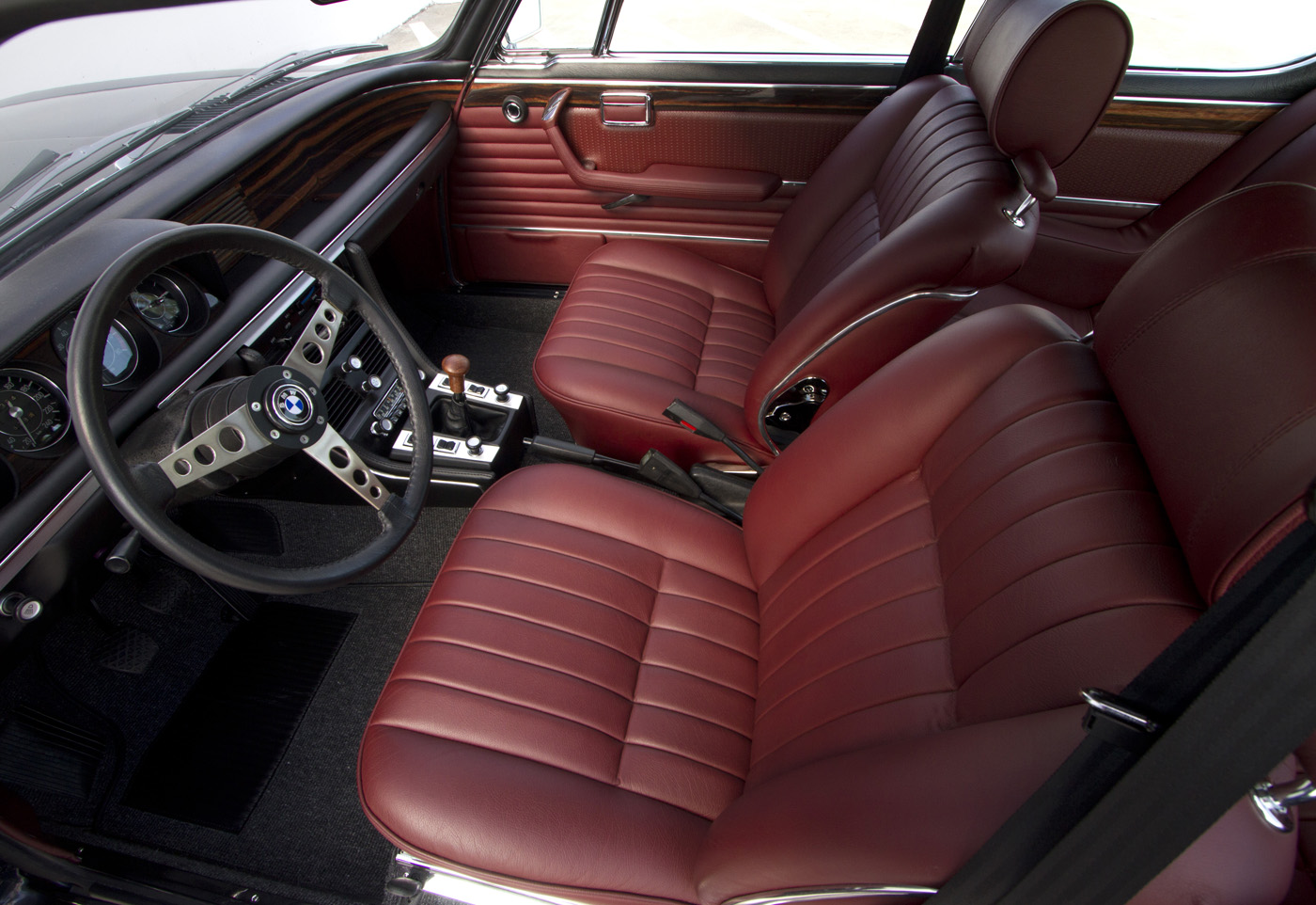

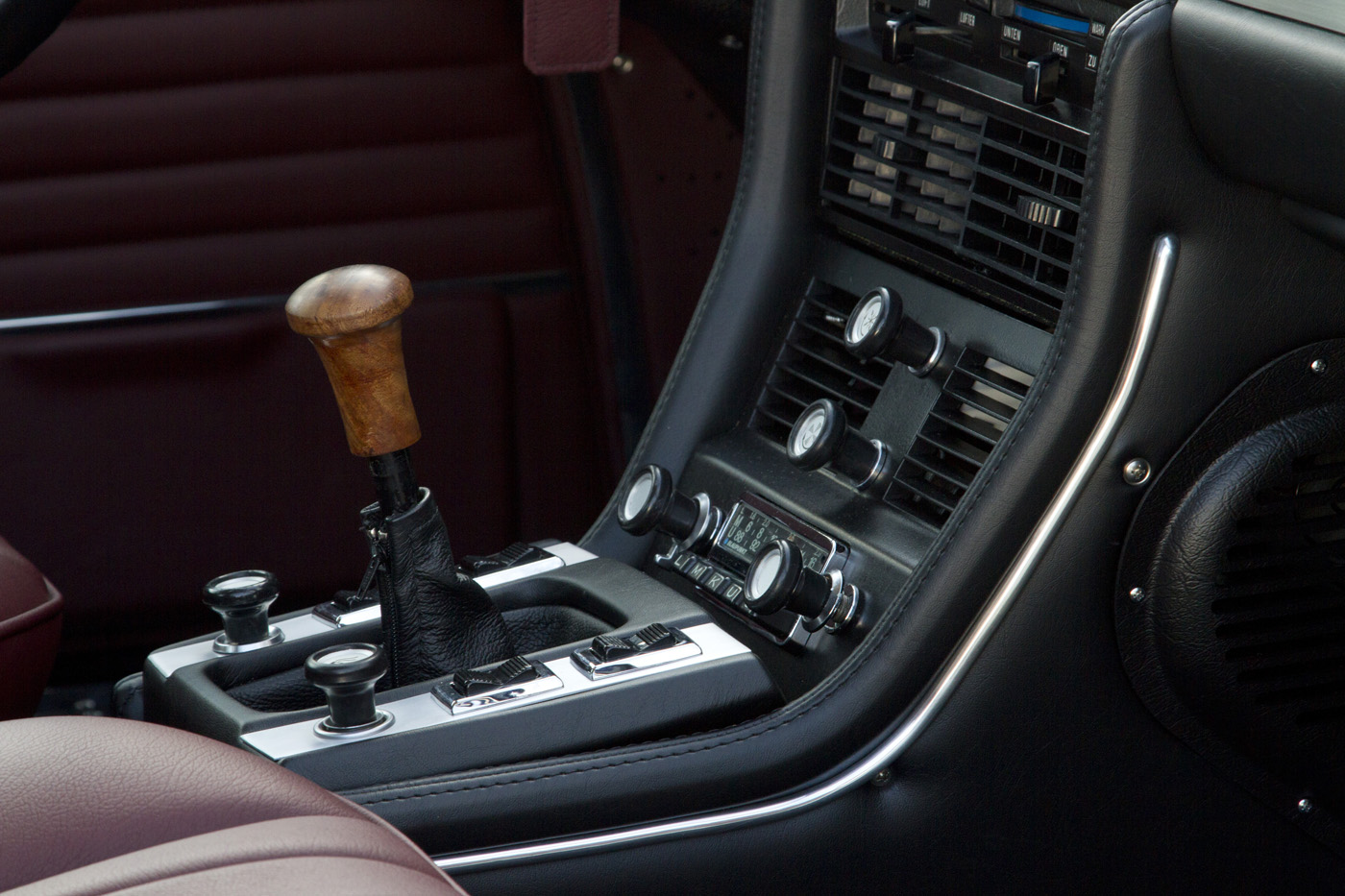

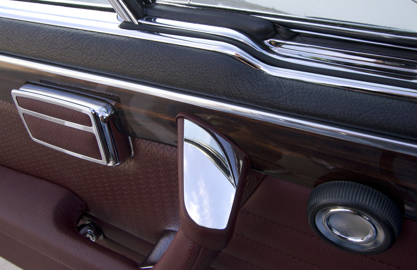

Hello all. I have been able to work first hand with Mauro, ( correct spelling ), who is in Alameda, close to Don. I have been impressed with his attention to detail. On my Granatrot CSI he basically did the whole interior except for cleaning up the seats. This included dash, under panel, doors, carpets, hat rack et al. I am very happy with the results. Next week my son's car goes in to have its interior tlced. I will organize some pictures to post of his work. Cheers, Tim.

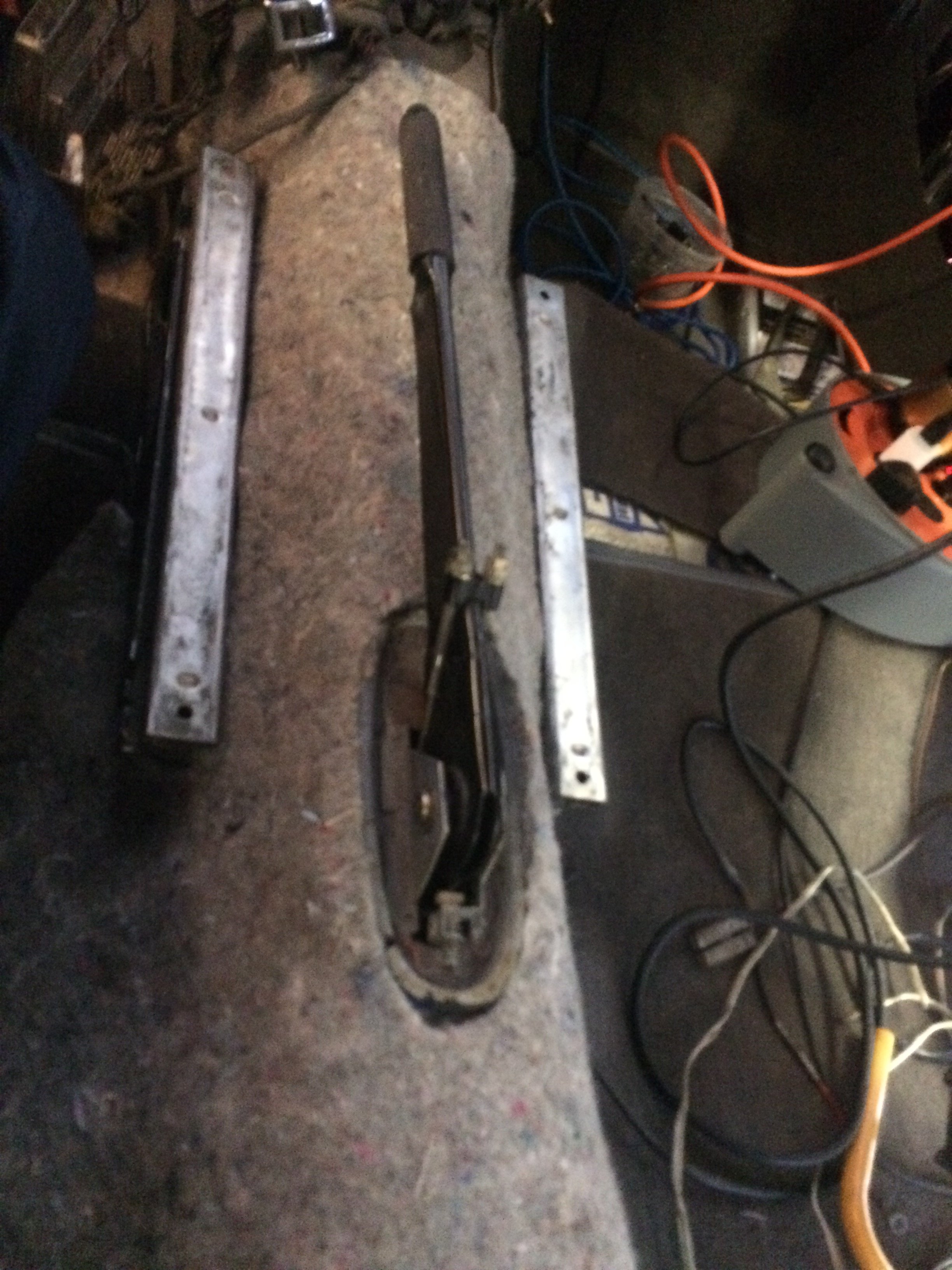

since we're on the subject of interior, is anyone installing sound proofing matts under the carpet? Dynamat or like kind material.
yep ... its a wide range ... and it can be that variable, in fact it can be more than my top number.
my concern with dynamat has always been the large amount of weight that it adds to the car ... and the thickness makes carpet and other finish materials not fit so well. you could easily put several hundred pounds of dynamat in a coupe. anybody in the know of a better way to go about this that isn't so heavy?
I know there's alternative materials and substitute that are a lot lighter and come close in sound deadening, but I haven't played with any of them. Weight is a concern, but enjoying with added comforts is more important to me.

Here are some pictures.

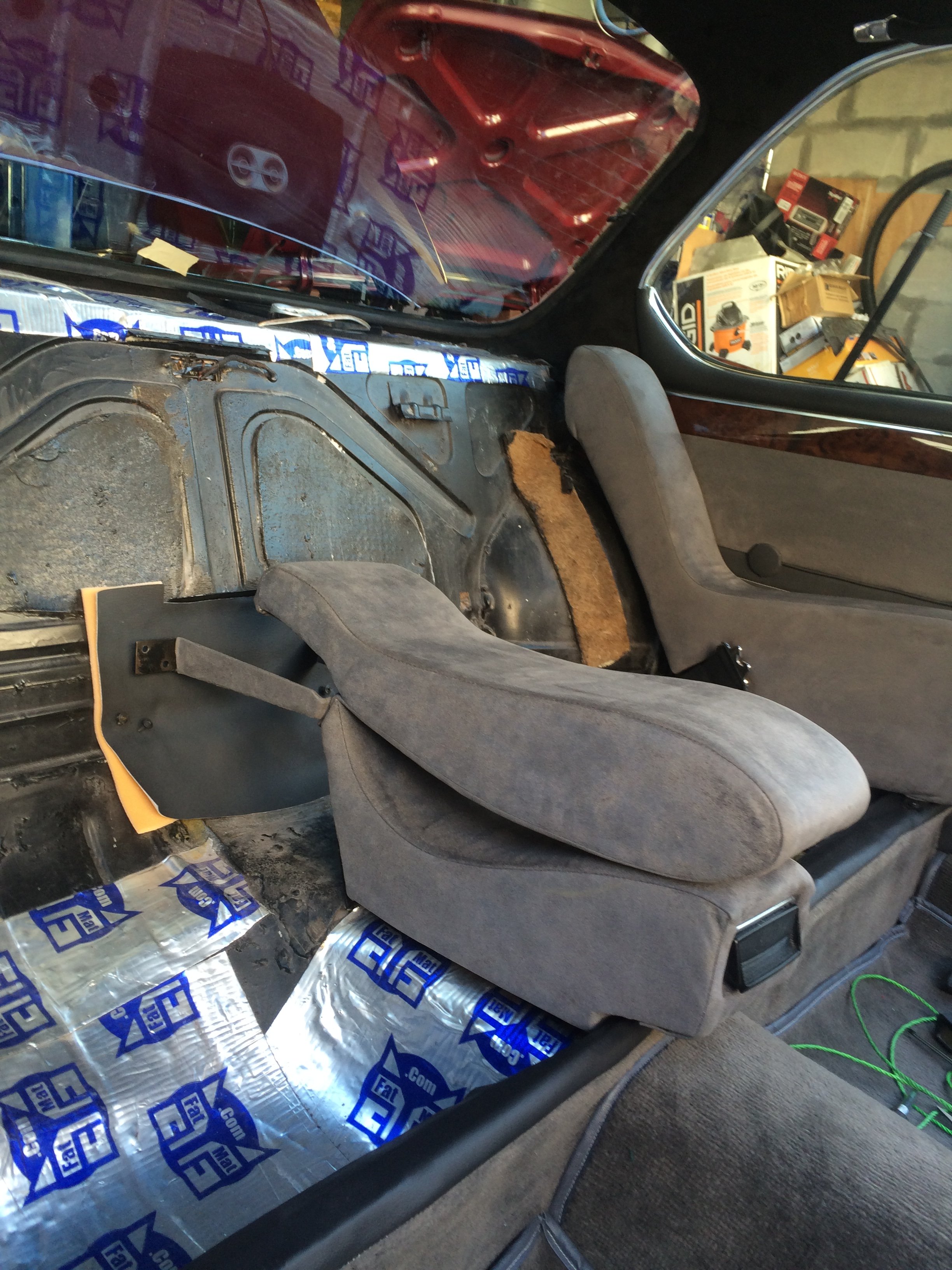

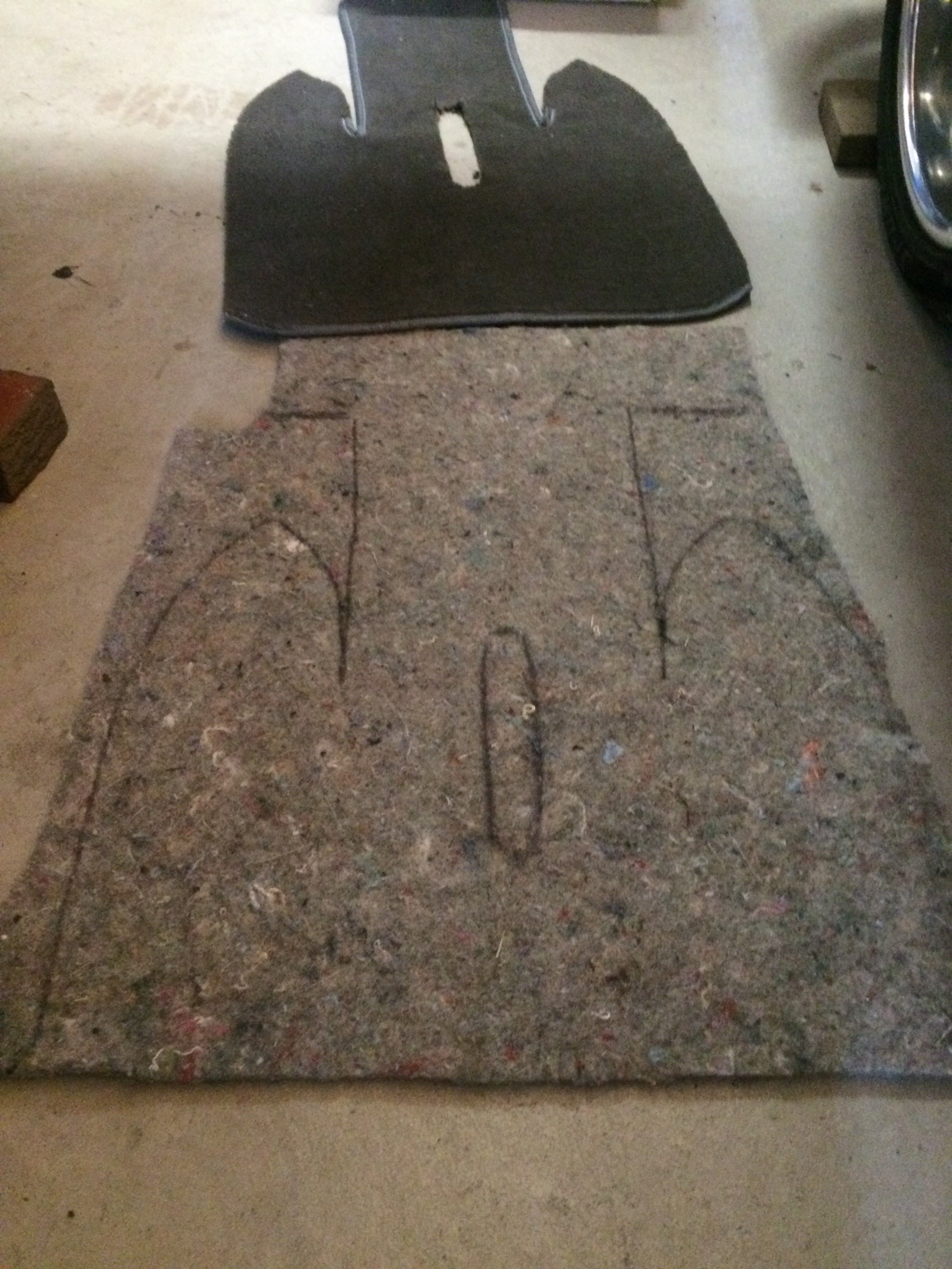

Scott hit the nail on the head but I have to add factoring the carpet underlay.
I've had success using FatMat. It's a little thinner while blocking heat transfer and providing some sound deadening. When coupled with the carpet underlay, it has worked well for me but I've been doing my own install and there is a lot of trimming, and in many instances recreation, design and/or production. You cannot be afraid to cut, even on kits from the usual suspects.
You must take note of where you remove the factory sound deadening, i.e., the contours. The sound deadening on the vertical of rear seat panel can be retained. In some spaces, carpet underlay will need to be doubled. If you are putting in any type of sound system, you have to factor sound deadening on those panels and fitment (trim, trim, trim).
The downside of doing your own trimwork is obvious, if you mess up, you must purchase more material and commission new work. I've purchased roles of material to ensure color consistency. I learned the hard way doing my Buick. I bought two carpet sets and had to go to my upholsterer to save me when I just couldn't get something. Ten years later, my coupes have benefitted from my attention to detail. I love doing my own work (mechanical, eh) and it's fun but you've got to be limber (I'm not - neurological condition), take your time, and have great patience.
