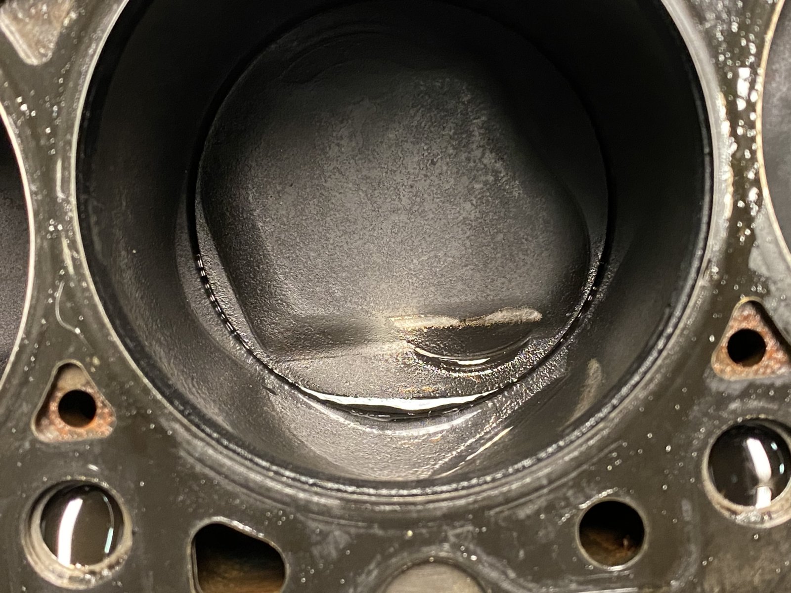

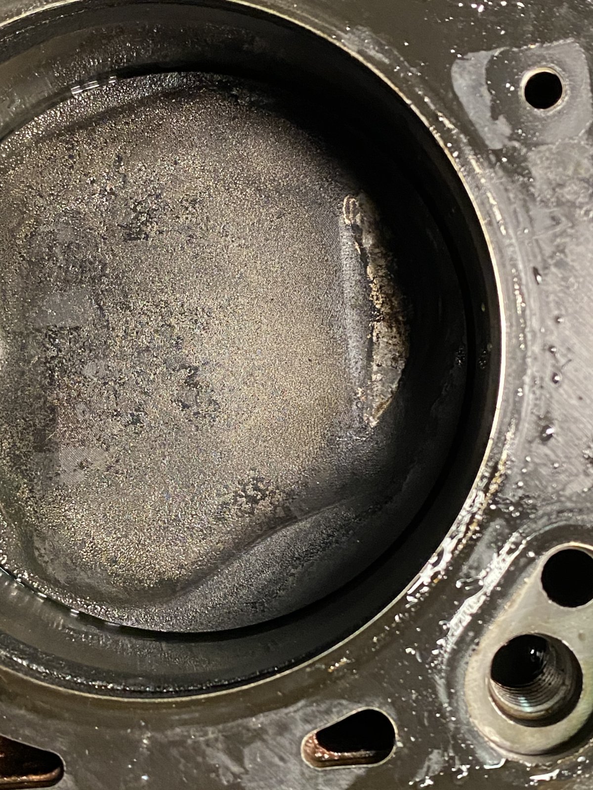

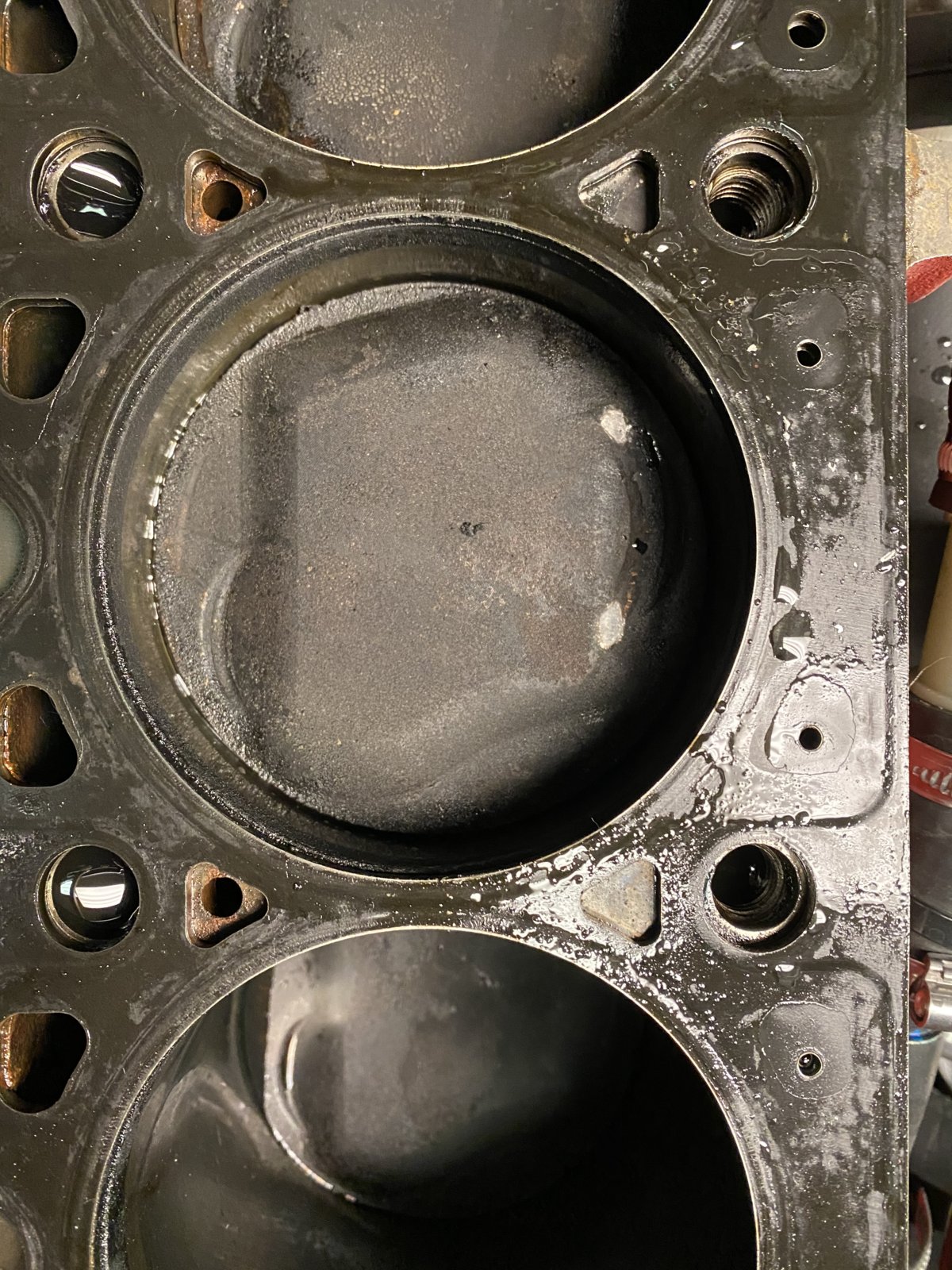

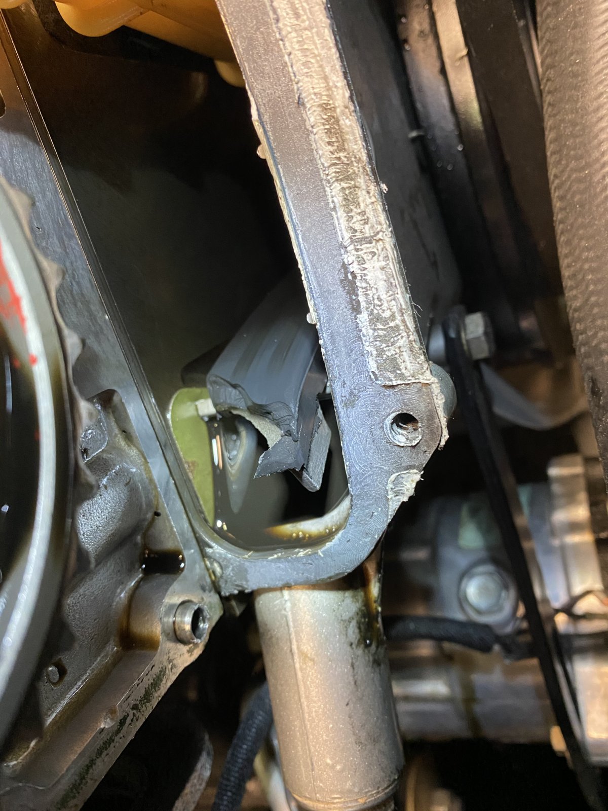

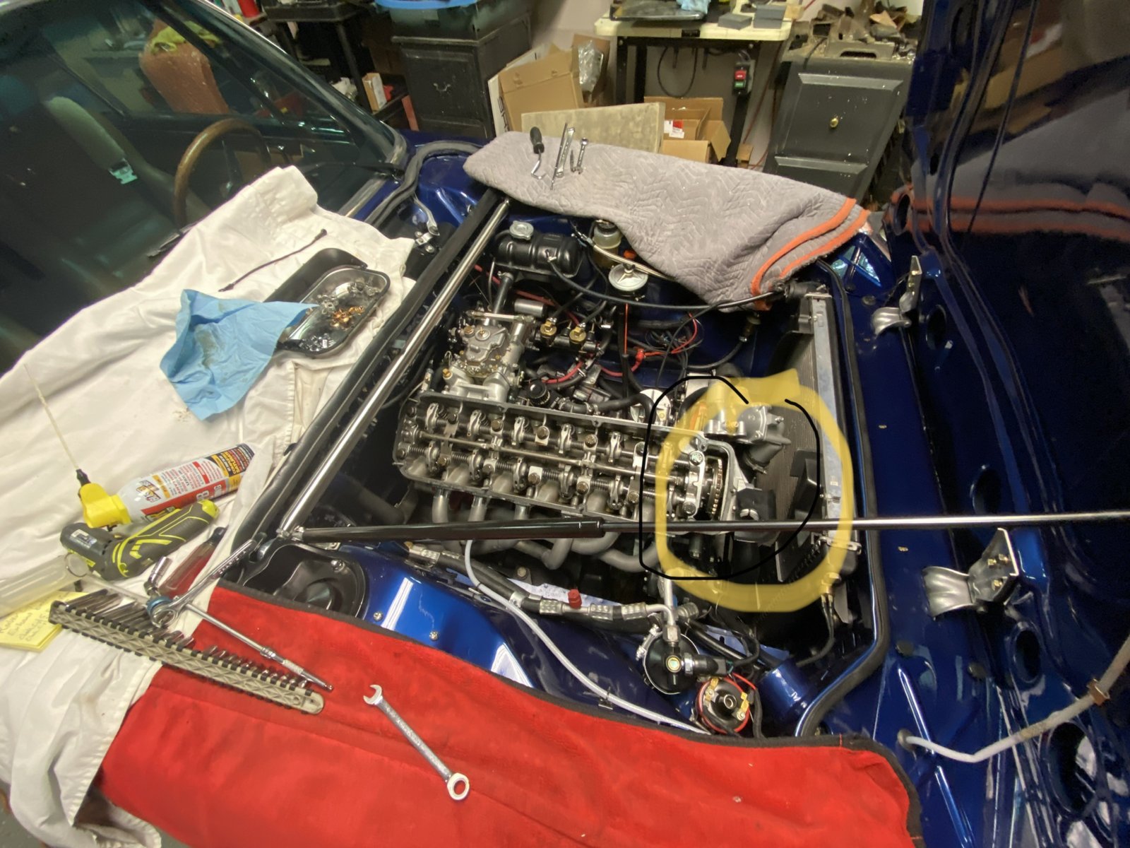

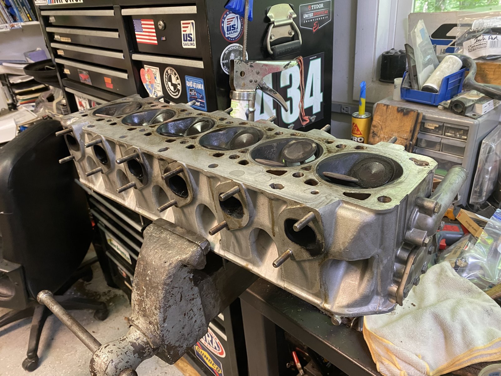

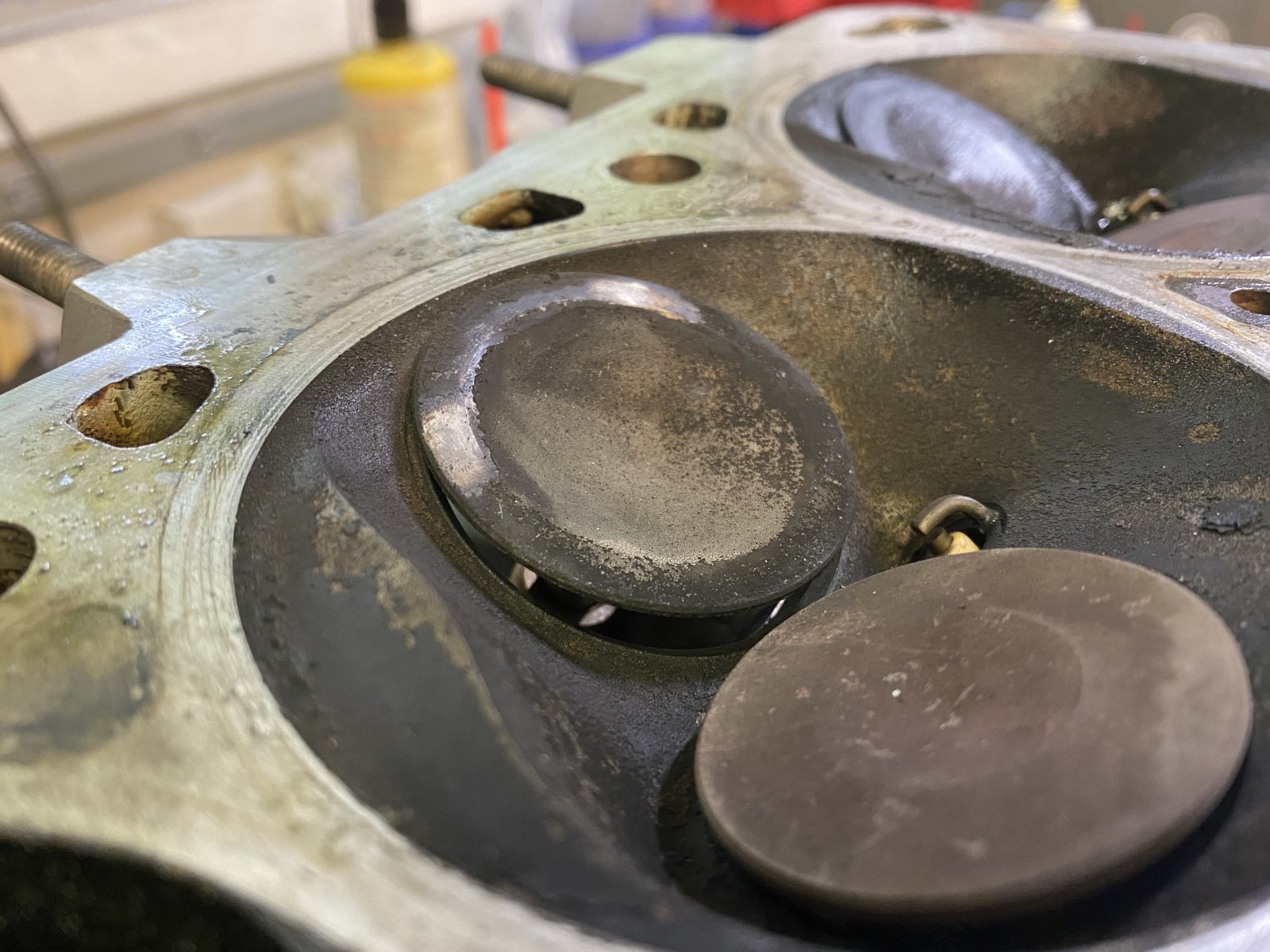

A couple days later I got the head off and discovered 3 bent valves and a broken rocker arm on cyl 3 exhaust and the chain guide was broken as well.
Oh whoop, let's spend more money on needless repairs.
Rounding up parts now and cyl head should go to machine shop by Friday.
I also need to check that piston to make sure the rings are not broken.
The surface is ok on all 3 just a mark where the valves hit.
Also find parts in oil pan and fix an annoying oil leak.
So to pull the piston I need to remove the pan and to remove the pan I pull the engine or drop the subframe.

I have a brace that goes across like your 2x4 idea. Will just drop the subframe. Easier and not have to disconnect the drive shaft and pull the trans.
Subframe is just 4 bolts and the shocks and probably the steering box to the steering wheel shaft.
I'm afraid if I don't check the piston I will just have to do it again later.

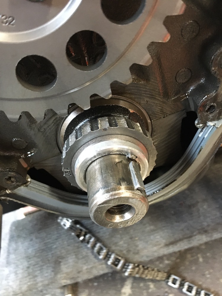

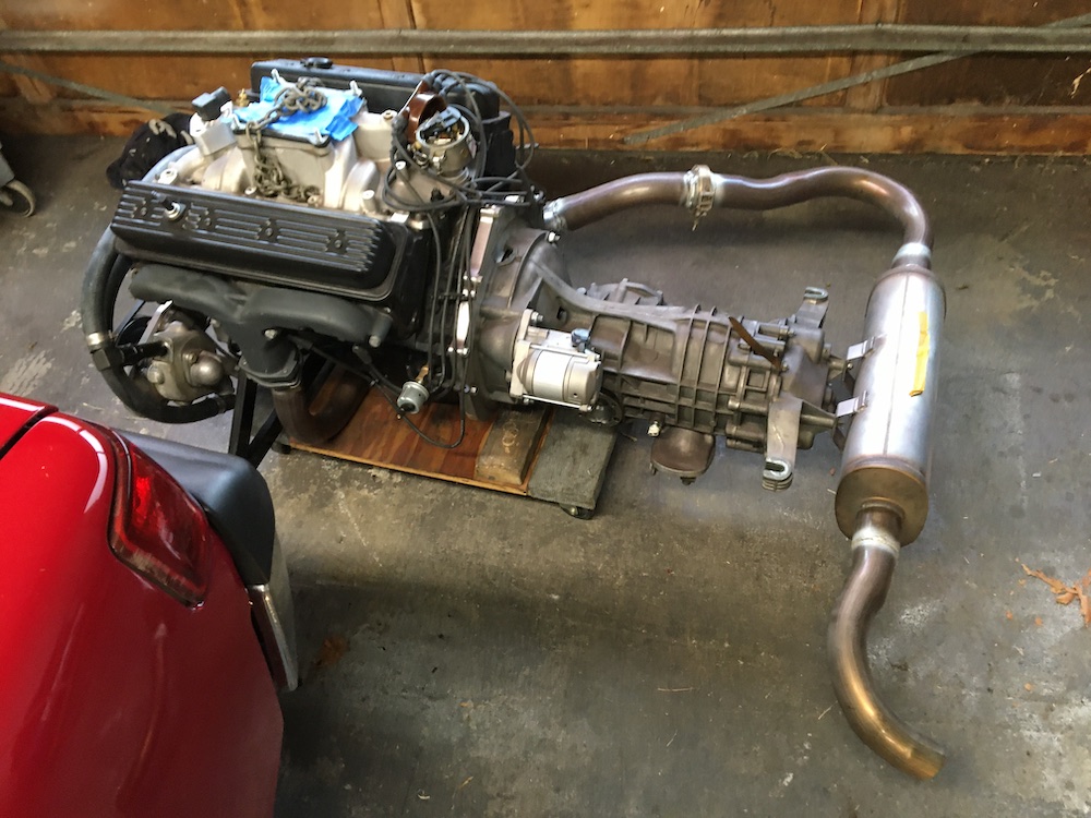

A little OT, but I did exactly the same thing with my small block Chevy powered 914 recently. Getting on the freeway, the top of 3rd gear and BANG!. I coasted to the next exit.
My engine/trans comes out pretty easy (through the bottom)...
The timing chain had broken, jammed against the cover, and took all the teeth off the crank gear. I don't know why I used a standard timing set, but a Cloyes double roller goes back in tomorrow (following a tear down and lots of inspection and cleaning)
