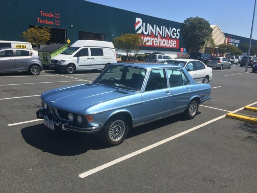

I am recommissioning the Behr unit on my '73 and the blower unit has failed - nearly seized, but not quite. RealOEM shows the part as "ended" so I was wondering if there was a suitable replacement for it in aftermarket that people here have had experience with.
Its a nice car and summer has started in this part of the world so hoping to resolve this if I can.
