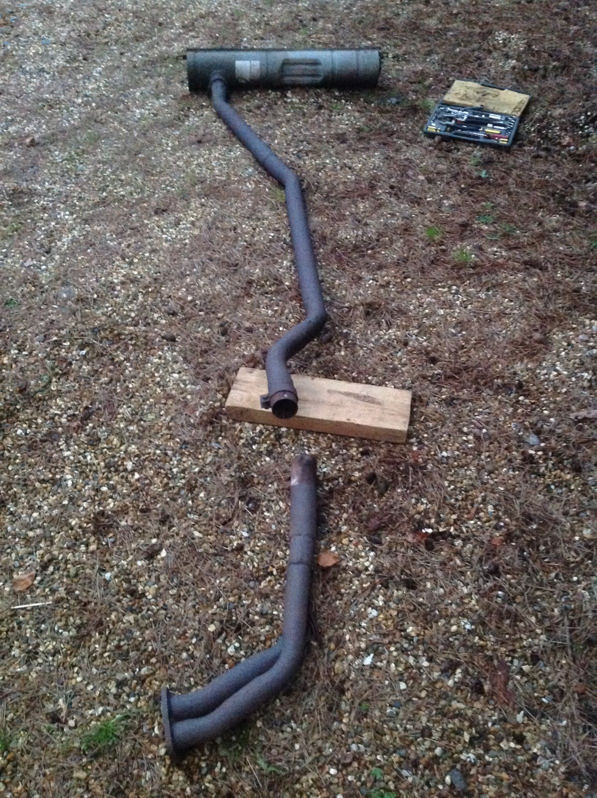

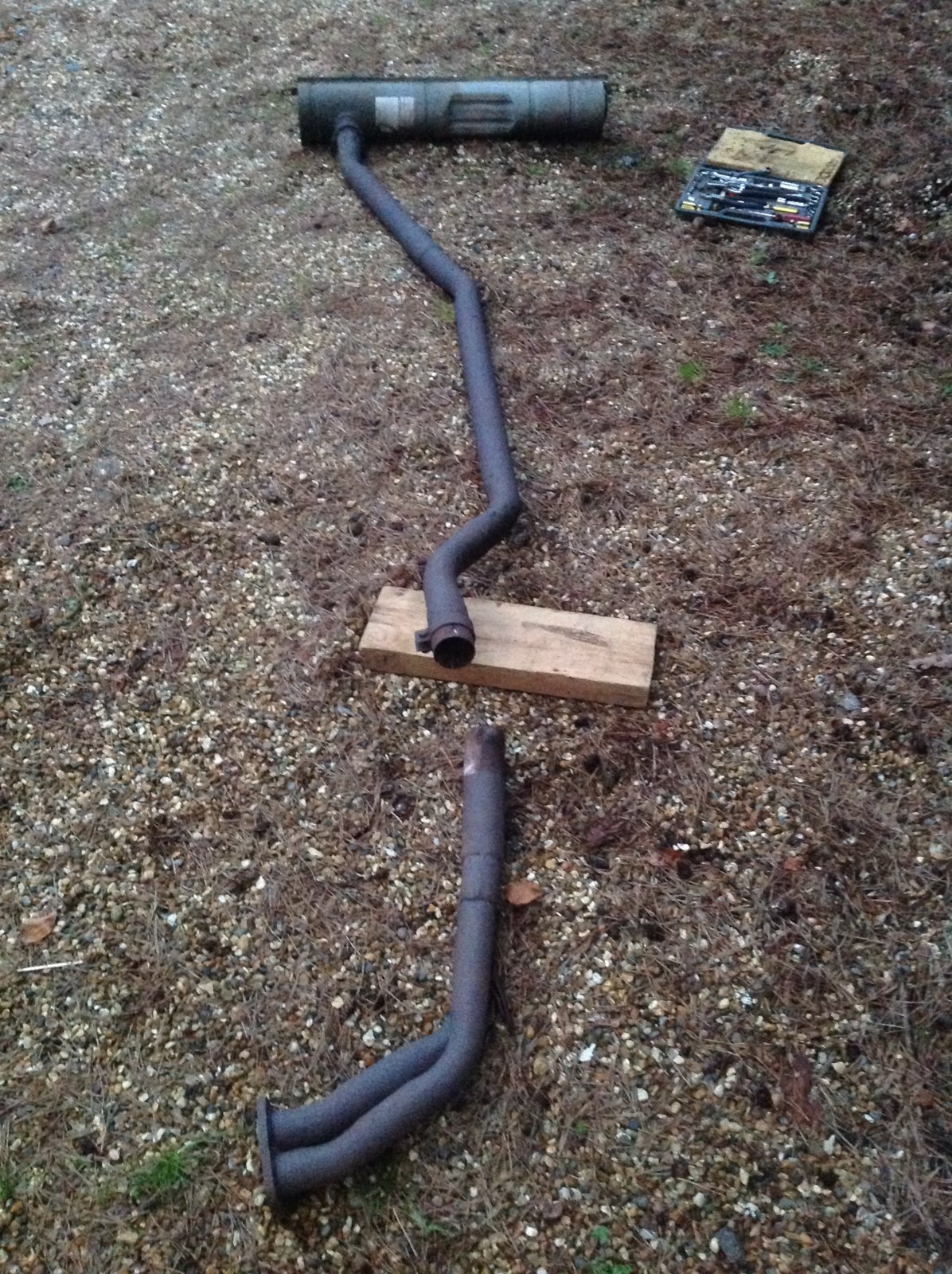

Dropped the exhaust today; the winter project is to fix the blow (MOT failure) and tidy it all up. As you can see, the front silencer and the small mid box have both been deleted and it now has a straight pipe to the large rear silencer. As you can also see the whole system except the rear silencer is rust coloured!! This is surface rust only, and doesn't cause me concern, except when I can see it. ;)

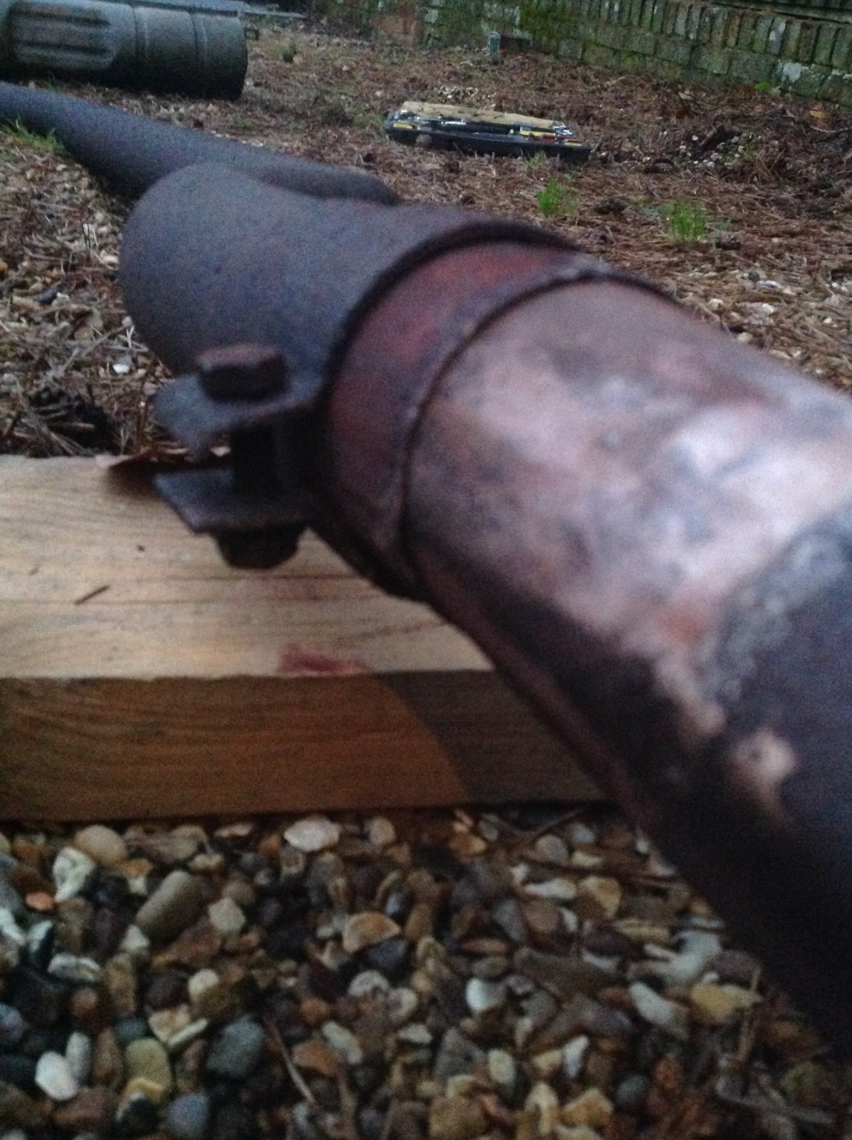

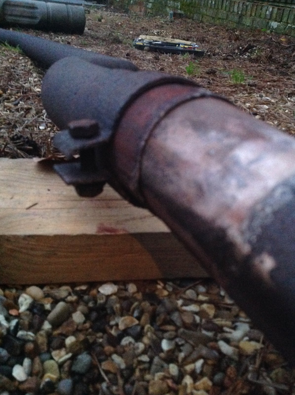

Of more concern to me is the blow coming from the joint between the modified downpipe and the straight pipe to the rear. This has been caused by a distortion of the joint by the seal clamp.

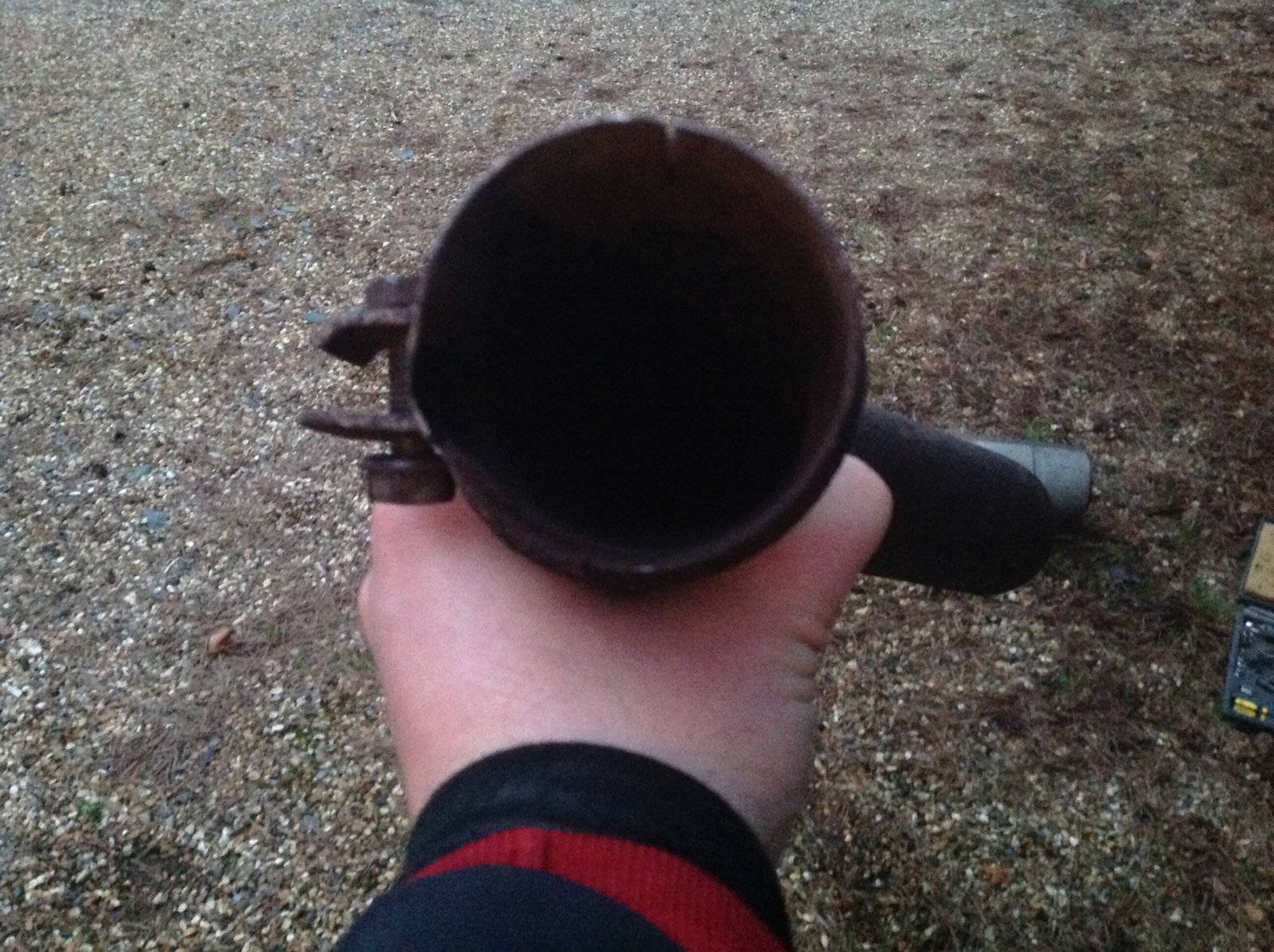

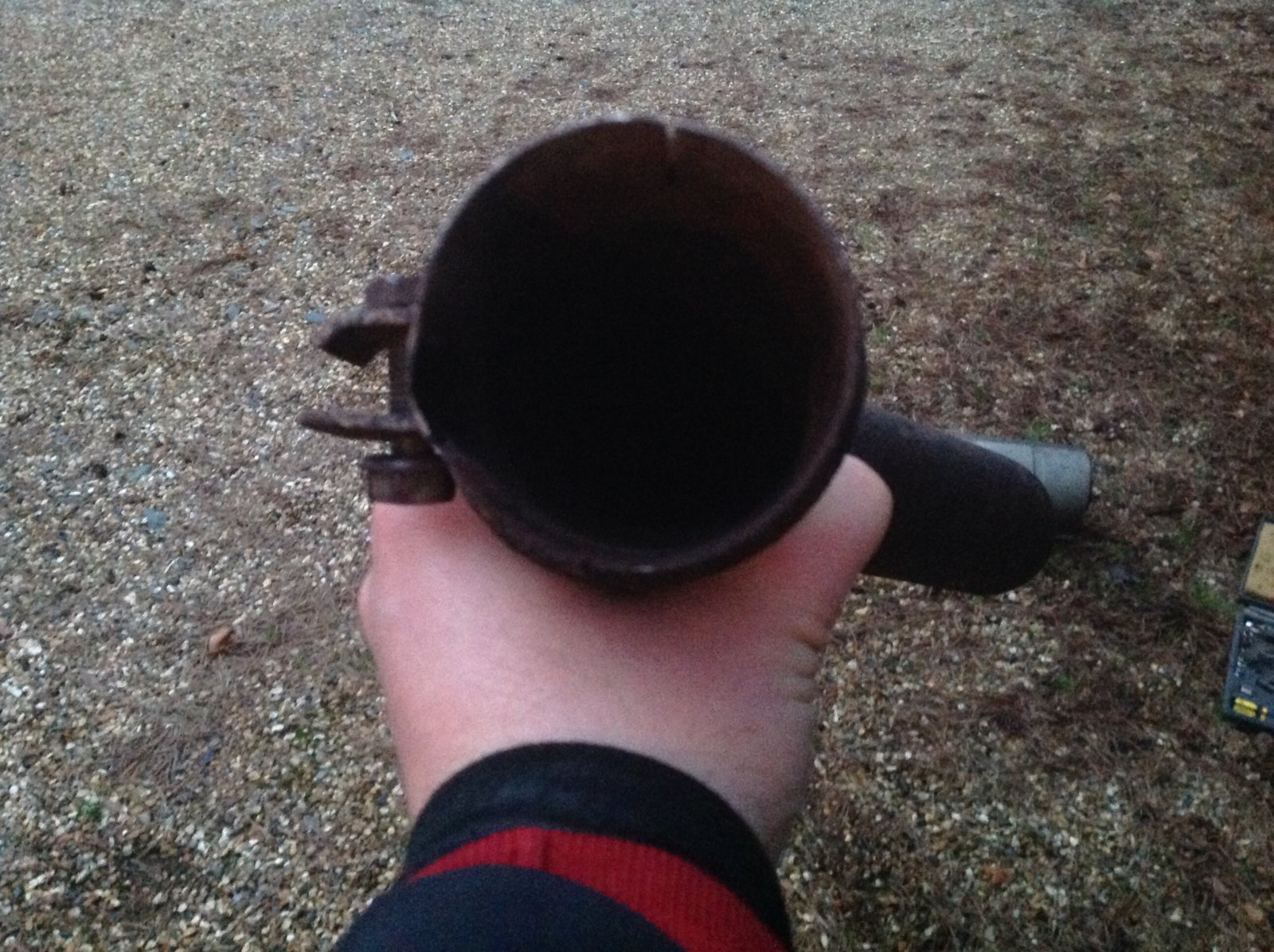

Questions: to fix the blow I plan to clean the surfaces, return the pipe to a true circle and rebuild the joint and clamp such that the clamp bolt aligns to the pipe's 'slot' (the slot cut in the pipe to allow for shrinkage as the clamp tightens). Thoughts?

Well I might need a plan B. Discovered a large hole in a weld in the straight section, an so am leaning towards replacing the system rather than throw more time and money at a system which has clearly seen better days, and has been chopped about a bit.
Think my options are W&N, fritzbits, or bmw/eberspacher (OEM). Price wise I think all 3 options are probably similar, but the OEM system might be hard to track down. My rear silencer looks in v good condition though, clearly not as old as the rest of the system.
