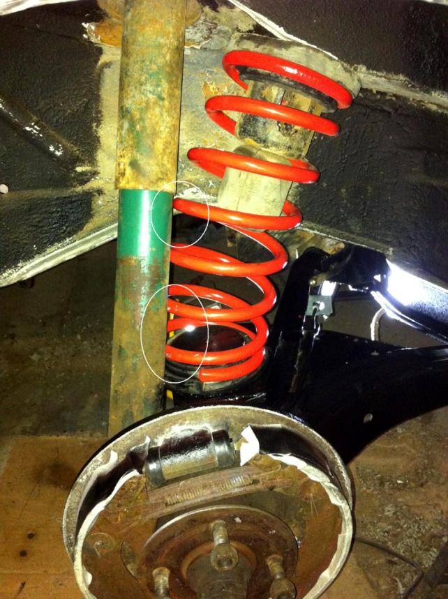

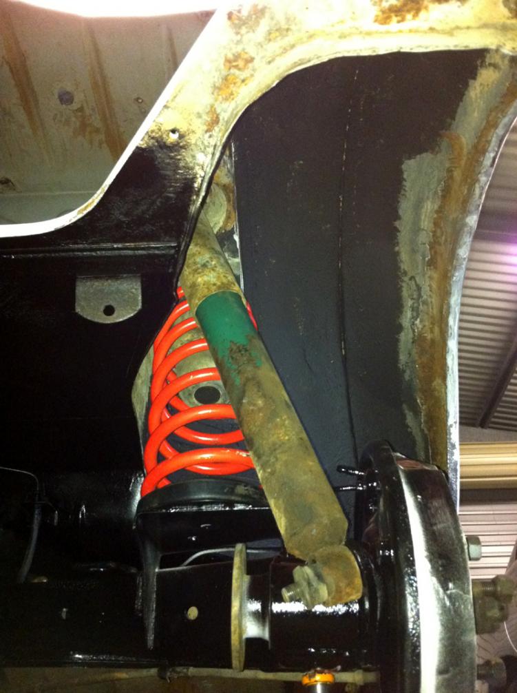

As you can see by the attached photos, something does not seem right, the original shock that is on the car at the moment seems to rub against the spring so i am thinking this cannot be the original part for this vehicle, there are no stickers or markings to let me know what sort of shocker it is. I am a little disappointed that the original spring i fully refurbished and trialed on the car is now scratched, (see pic attached) so its back to the garage for a repaint.
Does Koni, Eilbach, Boge or anyone else that i cannot think of make sport shocks to suit this vehicle?

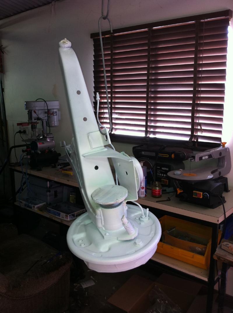

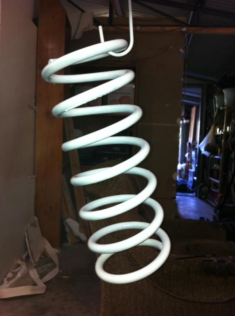

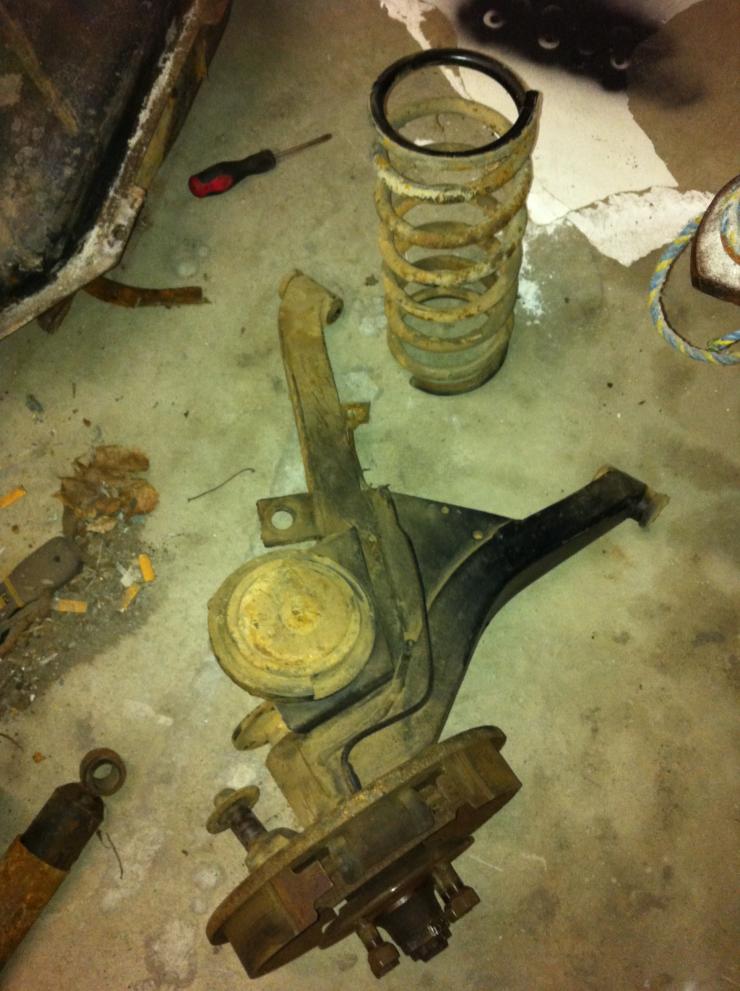

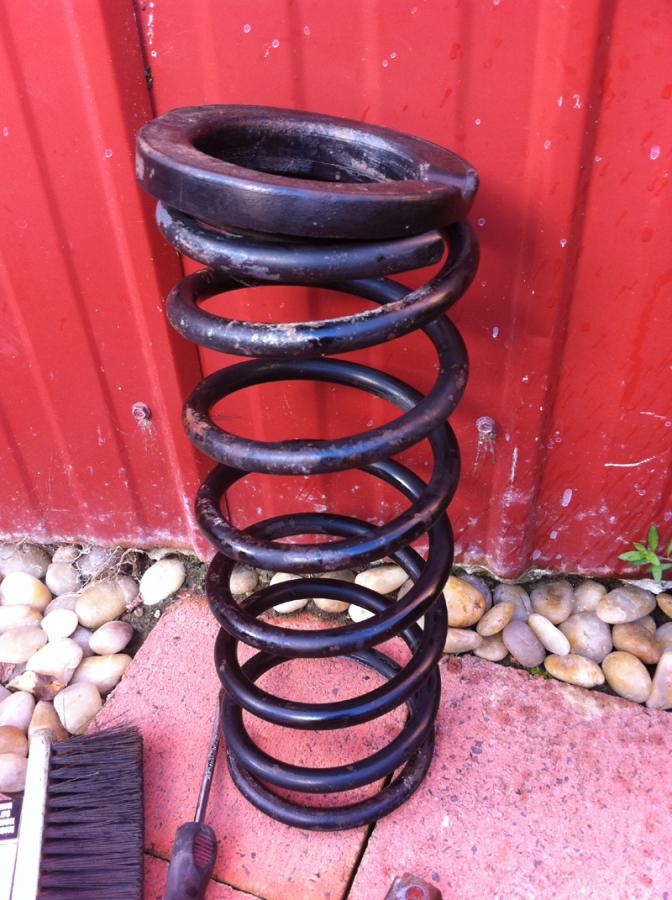

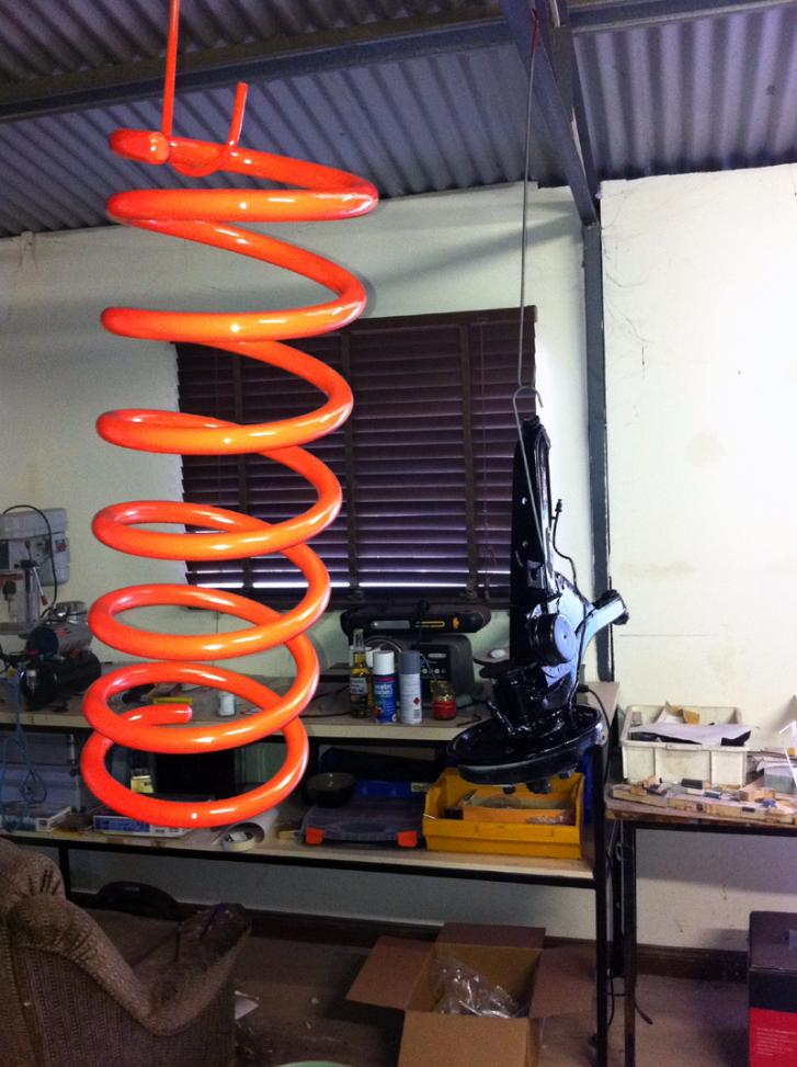

PS: some before and after pics of the suspension and trailing arm :-D IMG_0351.jpg

shocks
Don't know about part numbers, but if you get ahold of some try eshocks.com , they seem to have about the best prices that I've found. Might just give them a browse, they may have a listing for your car. And if you ever need gauges, try their sister website, egauges.com , they are about half of the price that I've found elsewhere. Good luck,Leroy
Shocks
Leroy!? You're a Godsend! thank you! I placed an order for the correct parts, sport shocks front and rear for just over $400.00. Having bought the sports shocks, it informed me to install lower springs which they have as well, i need to do some calculations before i order them for correct fitment.
Once again, you're a champion, thank you!
shortened springs & sport shocks
Perhaps you're aware that the above combination will be a very harsh riding E-9.
Most of us who have altered suspension--that is lowered the car--have gone with HD Bilsteins--I've had this setup for 15-16 years and it's plenty firm--JMT
