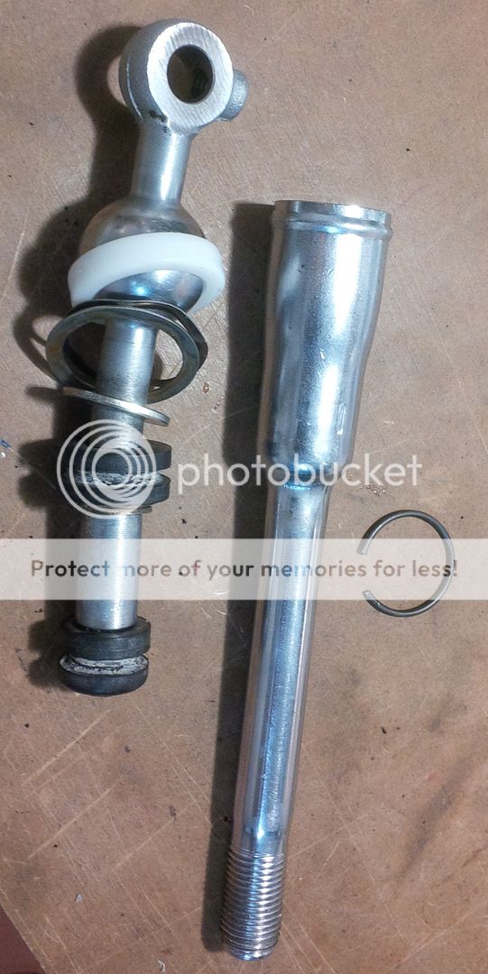

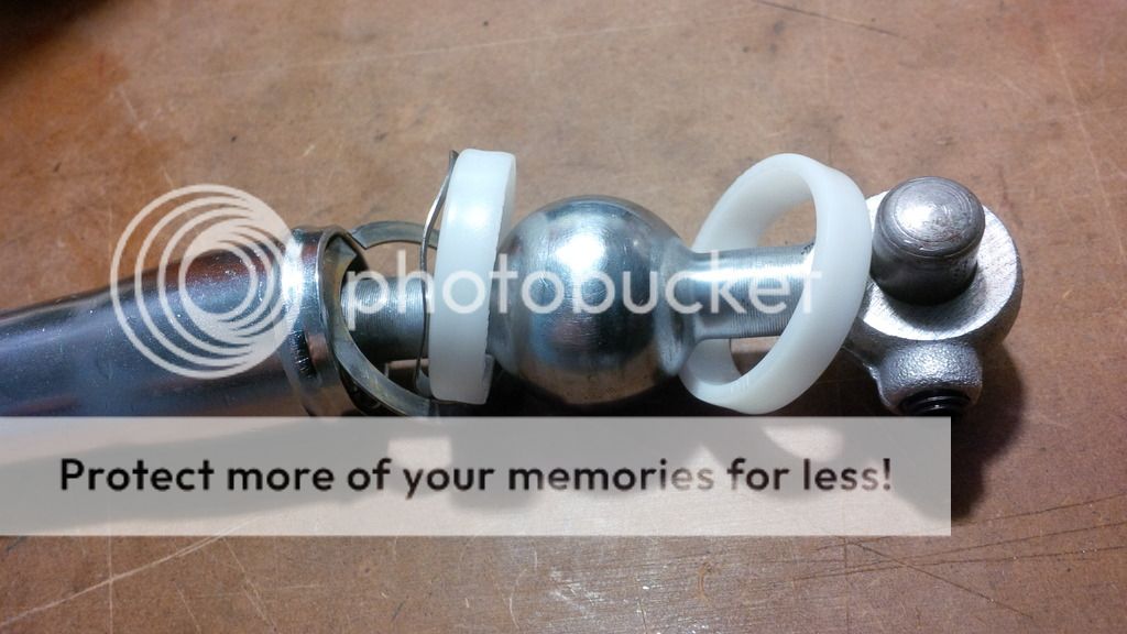

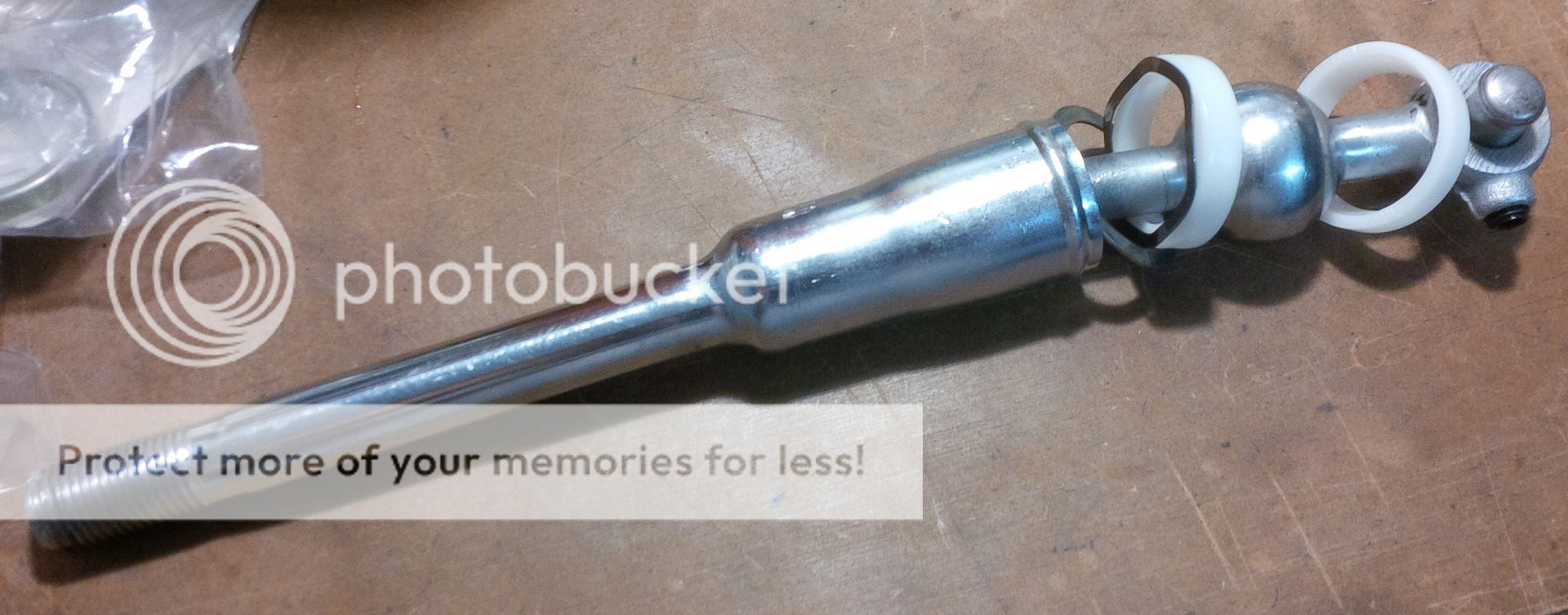

received the short shifter by Mo
here is it,
looks good, fits`perfect on a stock 3.0 cs 71
crucial is the type of shift rod, mine is not like the one in the picture, i have a sort of "Y" bar that Works perfectly in this 2002 shift lever

Looks Great DQ
That looks great....I am glad you are able to put this to good use.
Your pictures are excellent as well....may I ad that there is a threaded shift sleeve you can use for your next project....I personally had a round wooden knob on that sleeve (but is was very old and brittle)
Agree, the UUC is a nice system. Just call them to get what you need. Only caveat is that the shifter rod top is slotted and not threaded, so you can't use the old style knobs.
