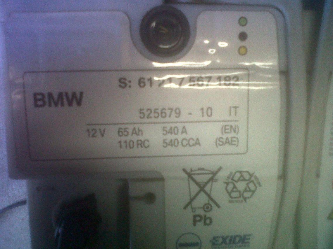

Looks to be sealed. There is a small window to peek into. When I peek it is yellow inside. It is suposed to show green yellow or black based on the diagram. Not sure what they mean but I would asume green is a good battery. it was black originally, got it to yellow but now need to get it to green.
Photo of Battery
Here is a photo.
Your battery is dead and can't be revived unfortunately. It at least needs a small trickle charge to last a year, I too have found this out the hard way.
