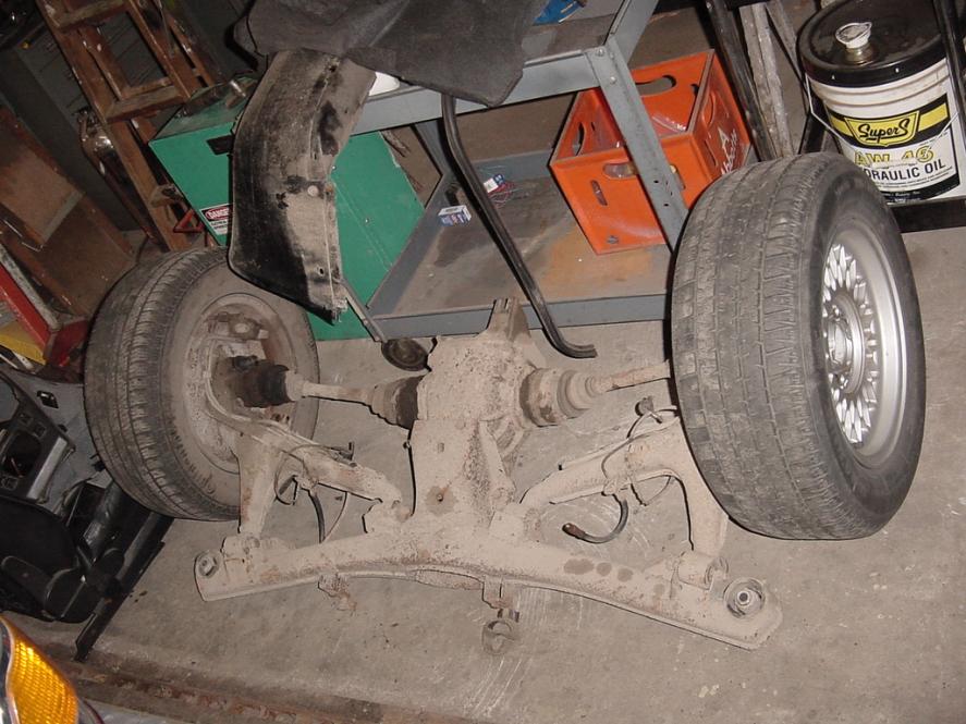

The front subframe sitting on a sheet of plywood resting on a moving dolly.

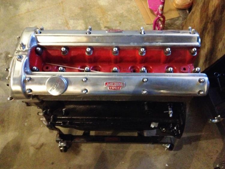

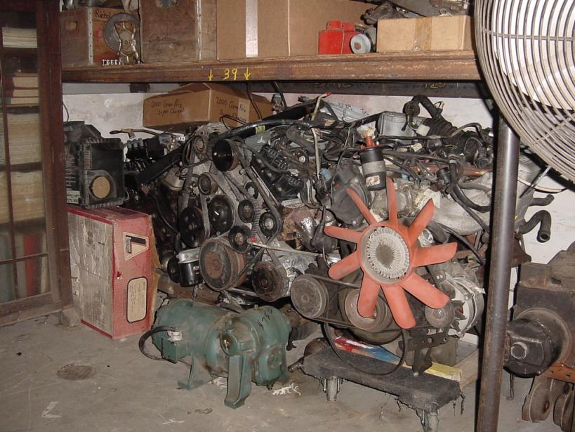

pic of engine dolly
What I like about these is that they're sturdy, roll well, and compact (if you're storage space is tight. Plus, this little dolly lets you work on most of the engine (just can't drop the sump), which is nice when you're prepping it for an install.

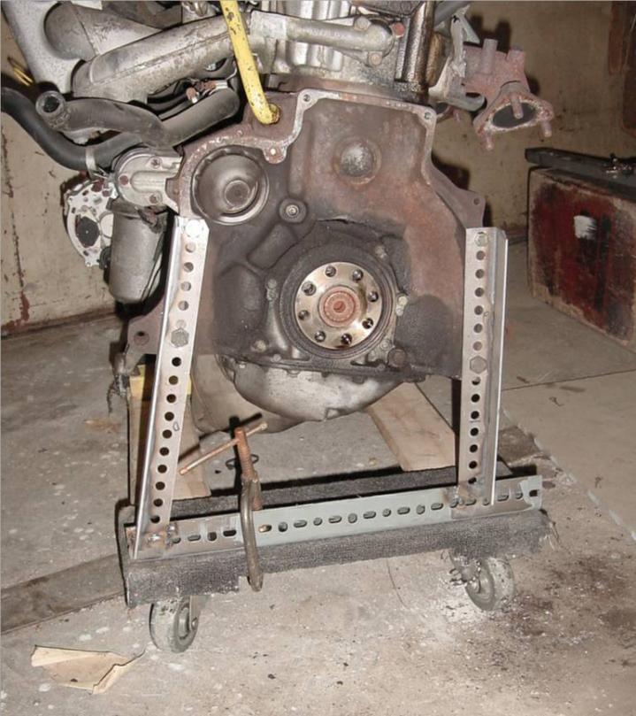

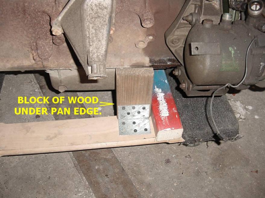

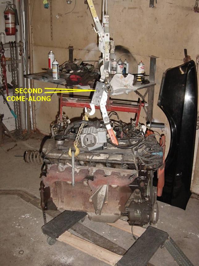

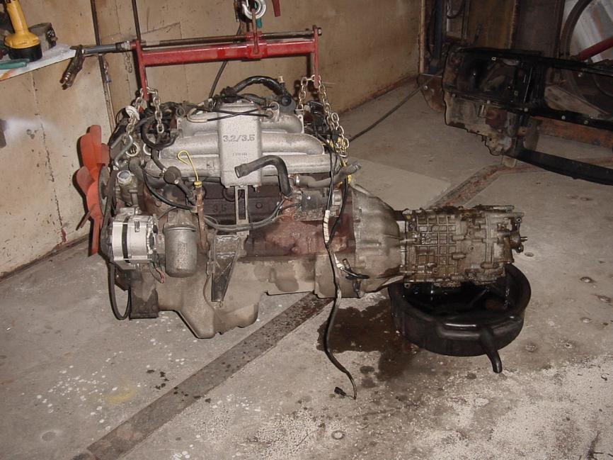

Thanks for the help guys. Once I pulled off the bell housing I knew exactly what to do. I put a second come-along on the engine to make it almost upright and quickly fabricated some frame-work to hold it that way. A block of wood under the pan edge at the front of the engine completed the job. Little Frankie (an Italian leprechaun) came over this past Sunday and helped me wheel it across 70 feet of concrete without incident to be stored in my mom’s furnace room. It sits with pretty good company (as far as 6 cylinder engines go), a 86 turbocharged Buick gran national and a 3800 supercharged Buick. Nothing ended up broken :-D and no one was hurt….. I just love it when a plan goes well. ~ John Buchtenkirch
