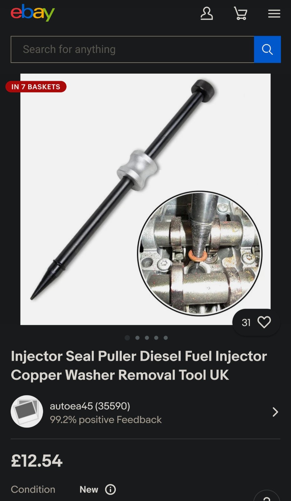

Injector gaskets should be replaced as well.
Sometimes the old injector gaskets are stuck down in the head and difficult to remove but there are cheap injector gasket puller tools available on ebay etc.
Better to have and don't need, than the other way around.
I am now buying a seal removal tool as you suggested and an injector puller also.

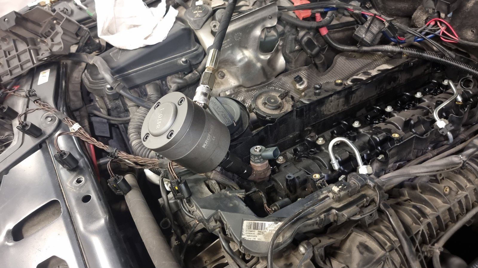

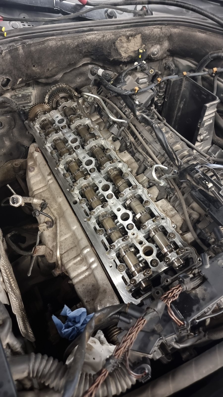

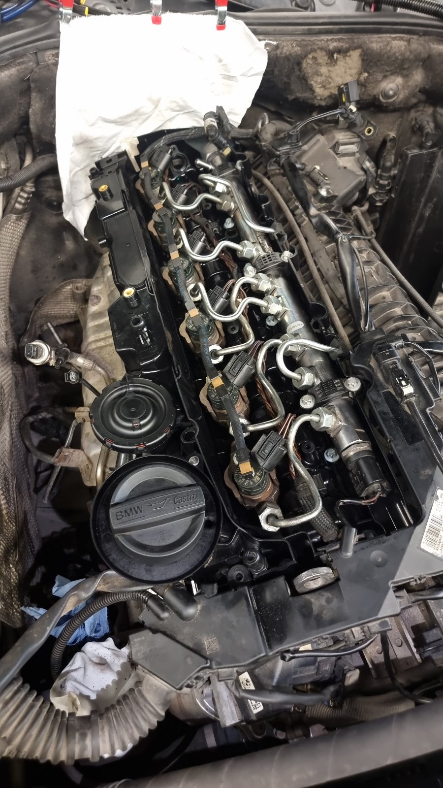

I did mine last weekend as well, injector no.1 was pretty badly stuck but got it out with a pneumatic extractor tool.
My vent pipe broke too ;)
