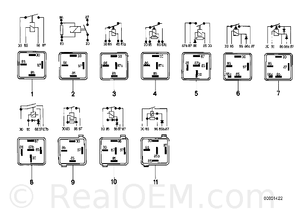

Here's a schematic representation of the E24 relays. Note that some have built-in noise suppression, some have diodes to make them polarity sensitive, some are normally closed, some are normally open, and some have double poles.
