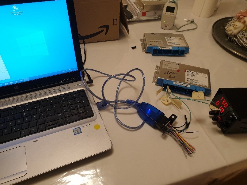

I built myself a bench-flash device to optimize the grandpa mode auto tranny 5HP19 with Alpina and Z4 software:
I also got a benchflash device for the DME and you can customize/optimize a lot, e.g. Vanos parameters, deactivate driver's wish correction and similar. Of course, these are all topics that do not play a role for the E9 but they are nice challanges in youngtimer BMWs. Different models, different challanges :)
