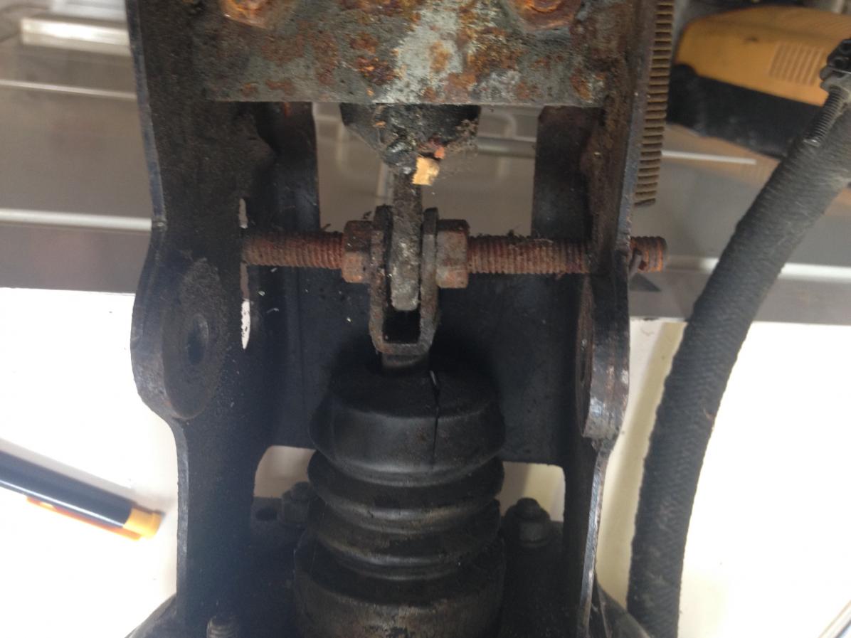

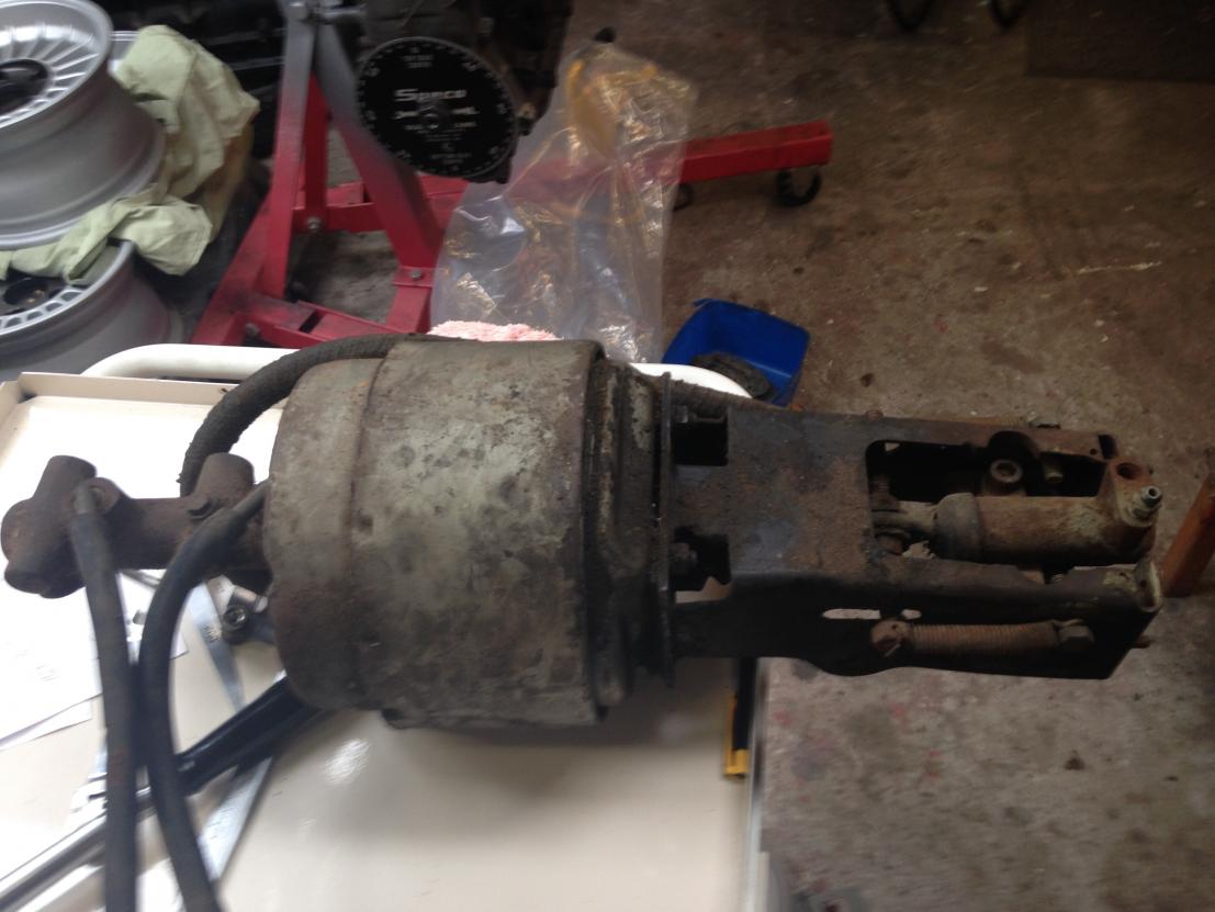

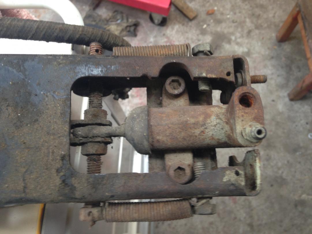

I had a Tii which had been converted to rhd (badly) that used a small hydraulic master and slave cylinder to actuate the lhd servo/ master cylinder. It worked fine.
Thats interesting. Was the lhd servo mechanically operated? If so then it must be some attachment which converts mechanical to fluid operation. I also have a couple of spare tii servo's which I might experiment with.
There was a simple master cylinder which was probably a clutch master of some type instead of the rhd brake master, actuated by the normal rod from the brake pedal. I suppose the "slave" pictured needs to give a 1:1 ratio of movement. This system gave a good pedal feel and was trouble free, but I don't know how you would do it with the twin booster setup
