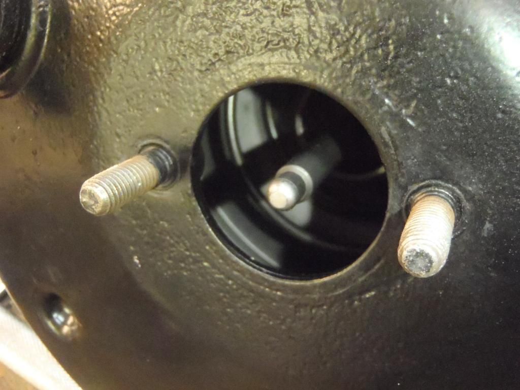

Anyway, I got the booster back from pwrbrake.com, they did an excellent job. The area around where the master cylinder mates to the booser is a little rough, even after powder coating. Is there a product to use on the square "o-ring" that resides in the cylinder? I'm considering something like silicon sealer but I've always hesatated doing that for a number of reasons.
Is there something else, specifically for O-rings that lasts and will ensure adequate sealing?
Locktite 5452. Sealer for o-ring boss.

I sure hope it works. I'm not a piker when it comes to spending on the Coupe but wow!
Here's a picture of the wear I'm talking about. Hope this stuff handles it.
