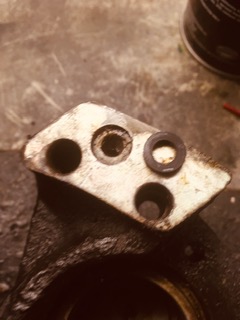

OK, forgive me, this is for my 88 M6 but I ask here due to the extensive knowledge. I had a sticking front caliper so am rebuilding. This 4 puck caliper was rebuilt just before I bought the car 7 years ago by a alleged reputable business. I removed the pucks, split the caliper and there were ZERO O-rings between the two halves! This caliper was trashed looking c/w the other side that was working fine. I did not smell or see brake fluid but............I cannot believe a caliper does not have O-rings. 99% sure this was a crap rebuild.

I meant the smaller o-rings between the 2 sides of the caliper, the ones that seal the channels. It did have the piston seals. I have some from PBR for my E9 rebuild.
All is well with those. I still cannot get over 40 bucks for a single rebuild kit......

You really cannot get the calipers clean, especially the bores when together. I use a Dremel and small brass brush to do the bores and tracks for the boots, then follow with 0000 steel wool by hand on the bores and pucks. Follow with a magnet to clear all steel wool. Also easier to paint, difficult to tape off the bores otherwise. Easier to set the pucks, boots and clip. Also I want to check the o-ring seals.........or lack thereof.
