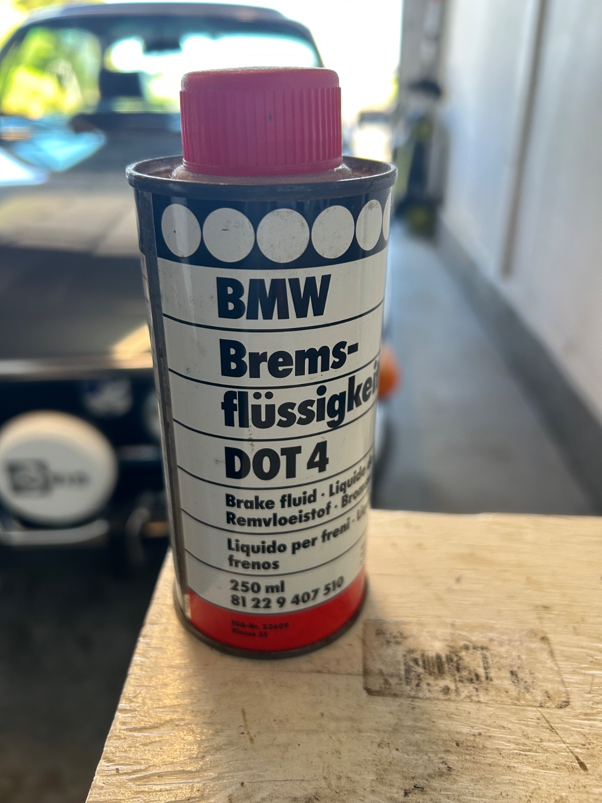

Just bled the brakes this evening for the first time with the new calipers, master/slave, brake lines, rotors, pads, etc. I used the BMW DOT 4 that had come with something that I’d ordered, hopefully that will work out ok. All newer system, so perhaps newer fluid…
