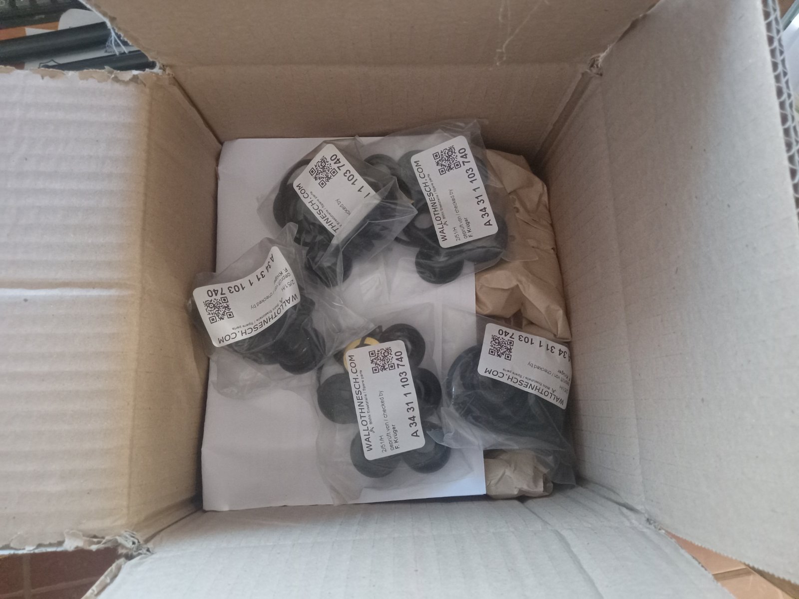

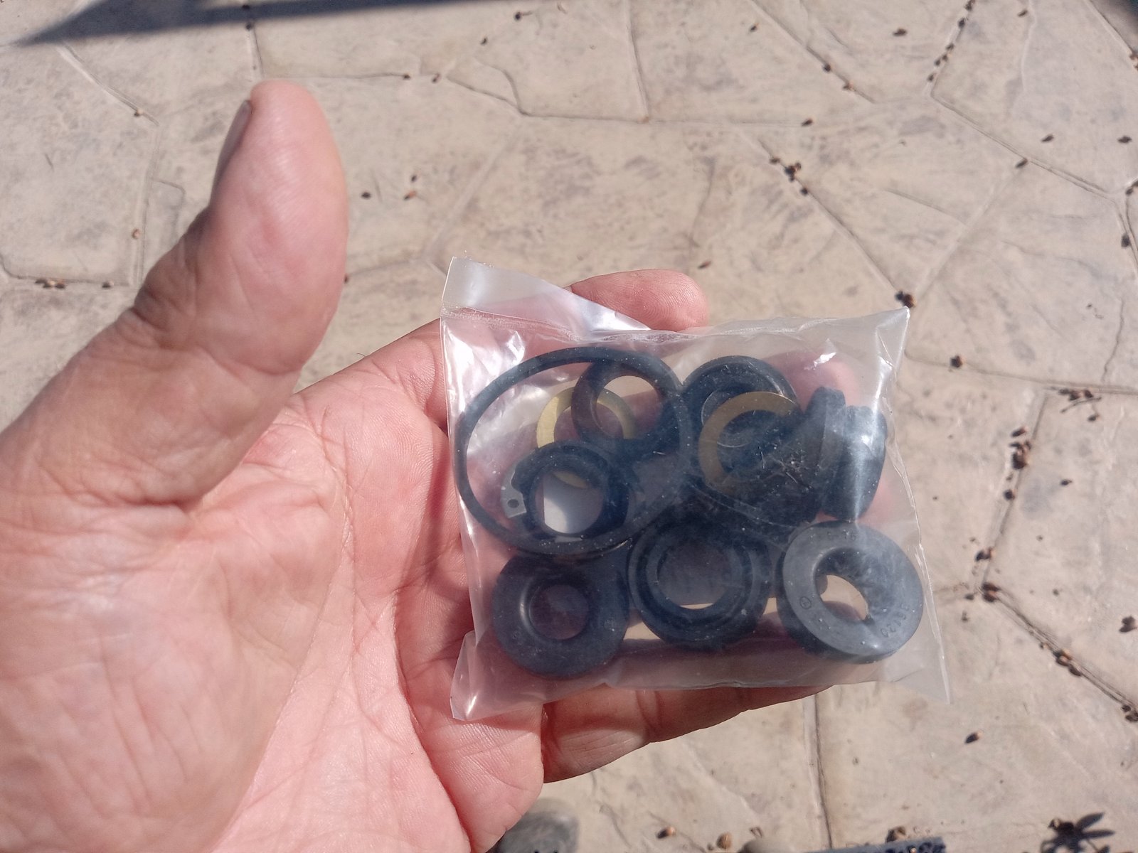

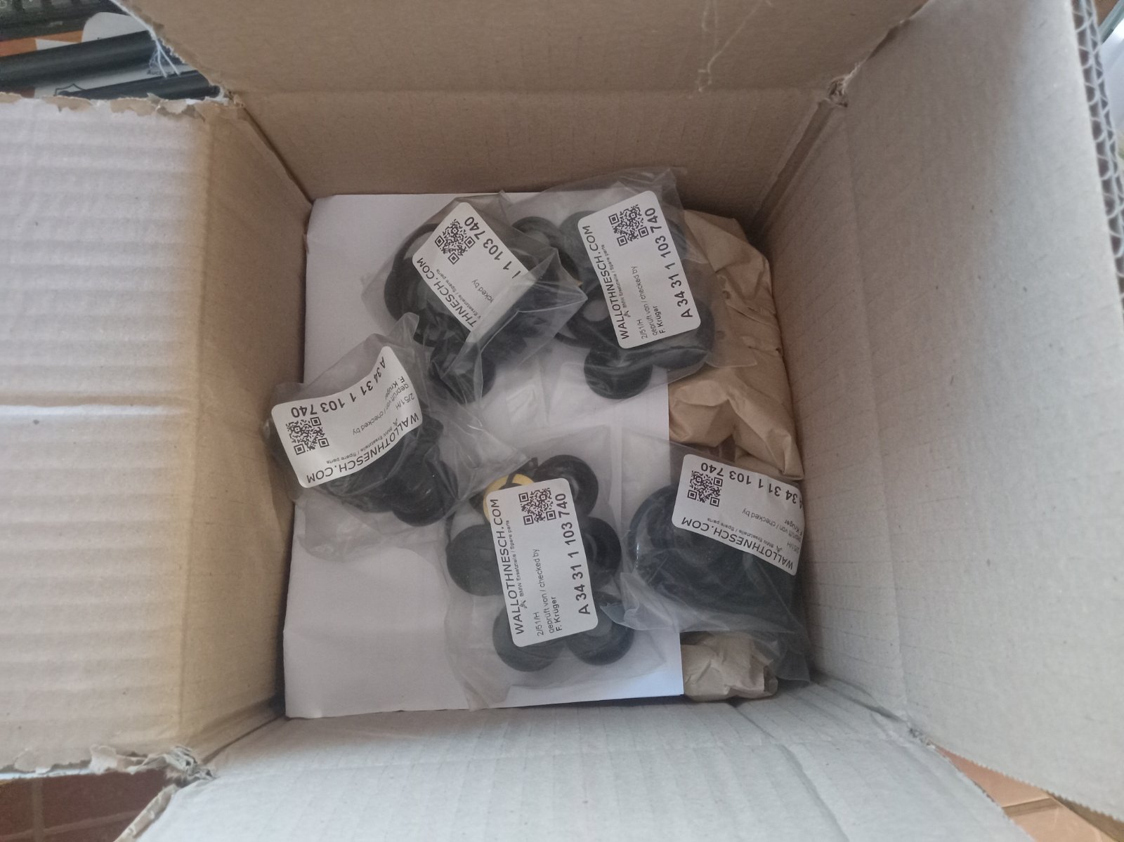

So I ordered 5 rebuild kits pn a34311103740 supposedly for the large (23,7mm) MC, see photos. I can spare you the pain (and 3 week wait) at $100 per kit post paid within the USA. That's far less than the cost of buying a kit from Germany, considering the 50 Euro shipping charge and the UPS add-on (which probably reflects a brokerage fee, not just the tariff which is supposed to be 10% from Europe.)
