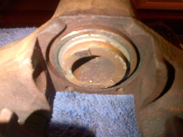

There is a raised semi circle on the piston (see pic), the bisecting line is supposed to be 20 degrees off of center or something. I took pictures and just estimated the way it was before it came out. No problems.
