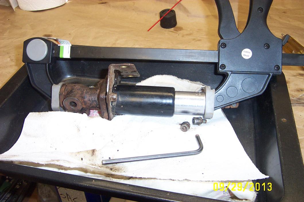

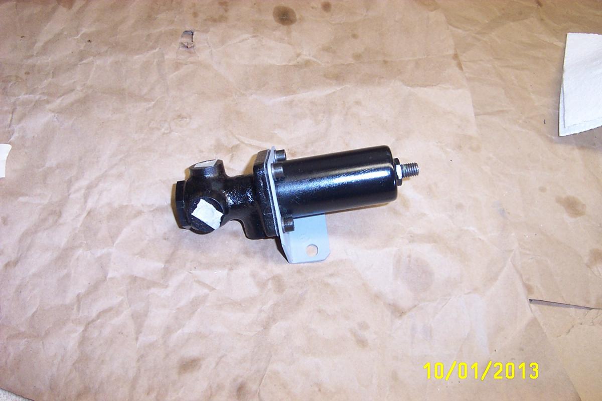

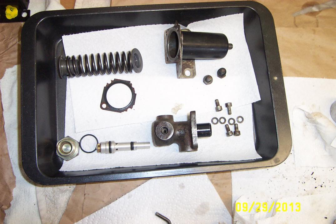

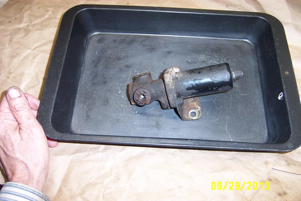

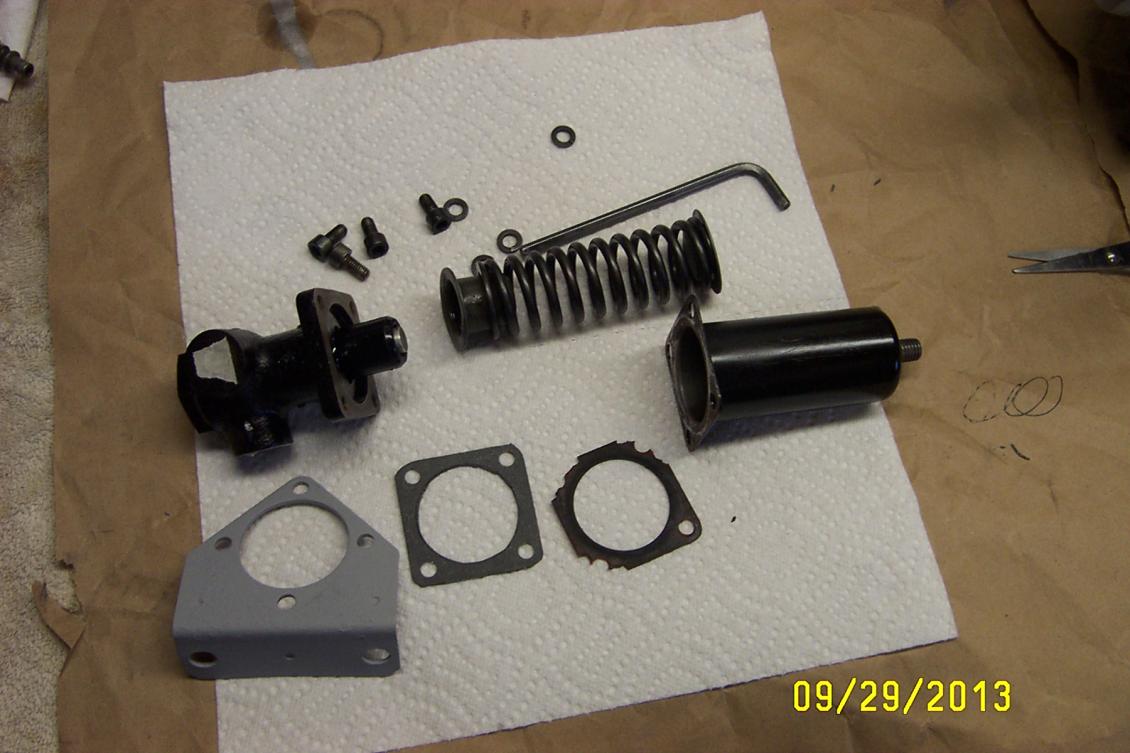

Valve disected, cleaned, reassembled.
Got the valve off of the 2800CS. Took apart to check condition. Found it was fairly clean inside. No pitting, bore clean, seals looked reusable. Only had to make a new gasket for the spring housing.
Photos show the sequence. As an earlier post cautioned, when loosing the 4 allen screws, it is a good idea to use a clamp to relax the heavy duty spring inside.
Pretty straight forward procedure, inspect, clean, assemble, and paint. Toughest part was getting the 3 brake lines loose!
We'll know if it still works in a few weeks when car is back together.

The big spring was compressed the same way it was taken apart with the large clamp. Check the photo upon taking apart.
