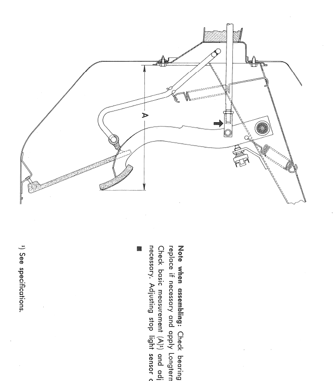

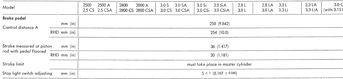

i was looking also for some explanation as to RHD or LHD, when you mentioned servos in plural i though of you as a britton, was me wrong ?
Hi there, many thanks deQuincey. That is a very useful piece of info. You are partly right, of course I should have stated that it is a RHD car. I do live in the UK, but am from Ireland. I’ve decided to send them away to be refurbed so the decision’s made.
