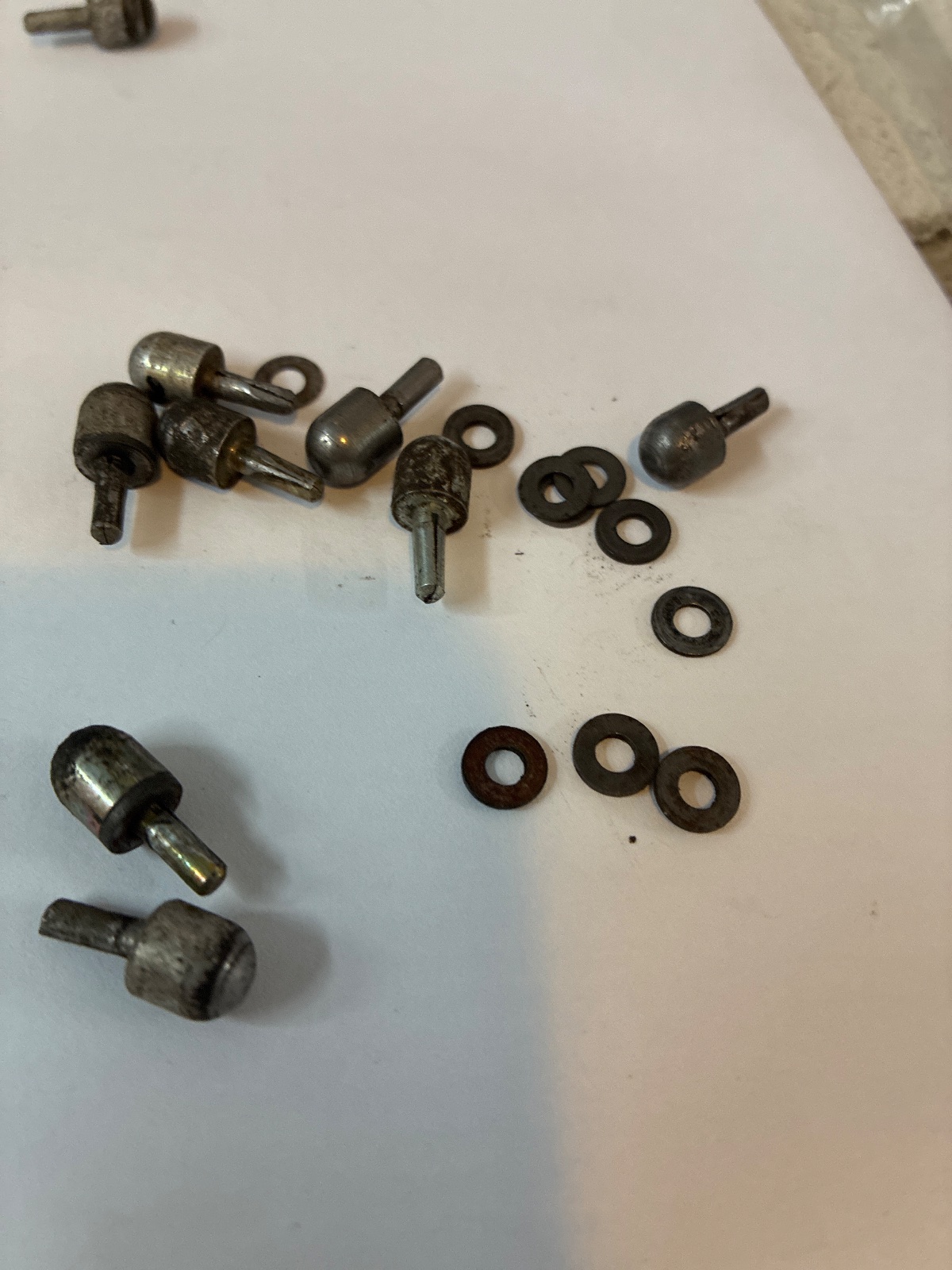

You shimmed the tip of the shaft correct?
There are different lengths of the tips.
question - did you just recently change your brake booster?
Local mechanic (smarter than me and a whole lot more expert) did the work. However he did screw the pooch by leaving the washers I put on the booster studs (temporarily) to diagnose the original brake binding problem. That did make the problem go away. The leaking developed later, after we changed just about everything but the booster and the MC twice. And by shims I mean washers yes. The shimming should have nothing to do with the fluid leaking if I understand how this works. That just allows for the right amount of play before the booster kicks in.
