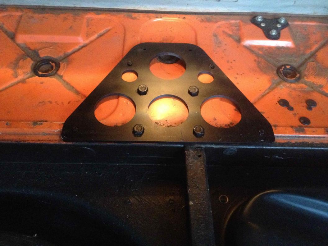

Do you have a pic of that diff reinforcement plate, I lost the email you sent me. Thanks.
Gary,
Diff reinforcement picture is attached. I also have the CAD drawing and a file that will go straight into a laser cutting machine.
The plate is connected via long bolts to the diff mount. I also have nuts immediately clamping the plate and upper box section, another set of nuts reinforcing the lower box section (immediately above the diff mount), then the nuts holding the diff mount.
Cheers,
Rod
