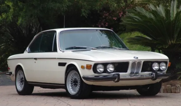

In 2011 Steve listed it as a BAT exclusive, for $15,500, and it sold within 3 days to Darryl, who brought it to the SF bay area. Darryl had a post-purchase check at Phaedrus, who said it had "minimal rust" and repaired a 1" spot under the passenger floor mat. It had 140psi compression on all cylinders. Phaedrus replaced the valve and timing cover gaskets for leaks, replaced the thermostat housing, removed the front US marker lights and re-sprayed some areas where the paint was pulling up along the chrome belt trim. They installed the Wilwood 300mm big brake kit along with the trailing arms from a 3.0CS and Bilstein HD shocks, and a Stebro stainless exhuast. At some point Darryl also installed a JBL amp and stereo along with a an original Becker Europa radio, and a 30-pin apple iphone connector. Darryl reportedly only drove it 5000 miles in the 14 years he owned it. Here is the charming interior from the July 2025 BAT listing:

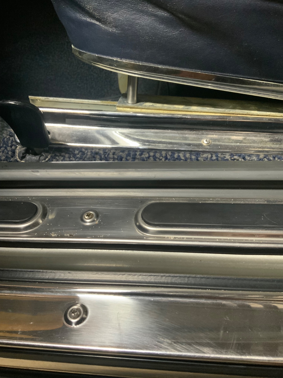

For the seat, just install a 1/2” or 1” bushing from Ace Hardware between upper slider and seat, no need to drill anything, and use a longer M6 bolt. I am also 6’ 5” and it helps immensely. The retractor prevents the seat from sliding back any farther.

Yes, I use a 1” spacer on both my e3 and e9. You can’t get the rear any lower and your seatbelt retractor will prevent it from sliding back any farther than it is now. My height is all in my legs and it gives great thigh support. Pic is my e3.

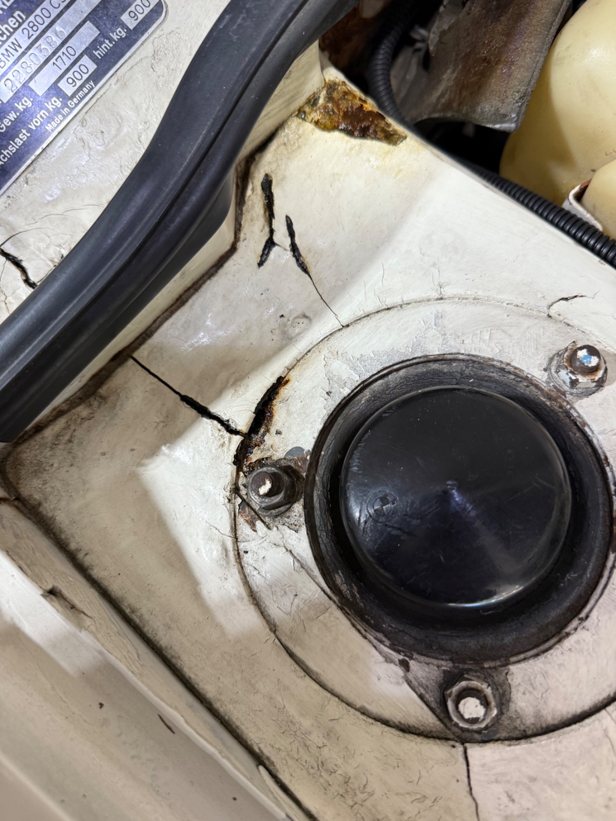

The first, most visible place I wanted to check is in the engine bay around the strut towers, where the butyl has cracked. Because of the structural importance, I wanted to make sure this metal is solid. I didn’t lift up any more of the butyl insulation but I did take a strong, needle-like pick and probe quite hard wherever the butyl is cracked and (sigh of relief) the metal feels solid. It also looks good from underneath, but it’s harder to tell because of the rubbery undercoating in the wheel well. Then I brushed some fluid film into the the places where the butyl has cracked or flaked, in order to seal the area.

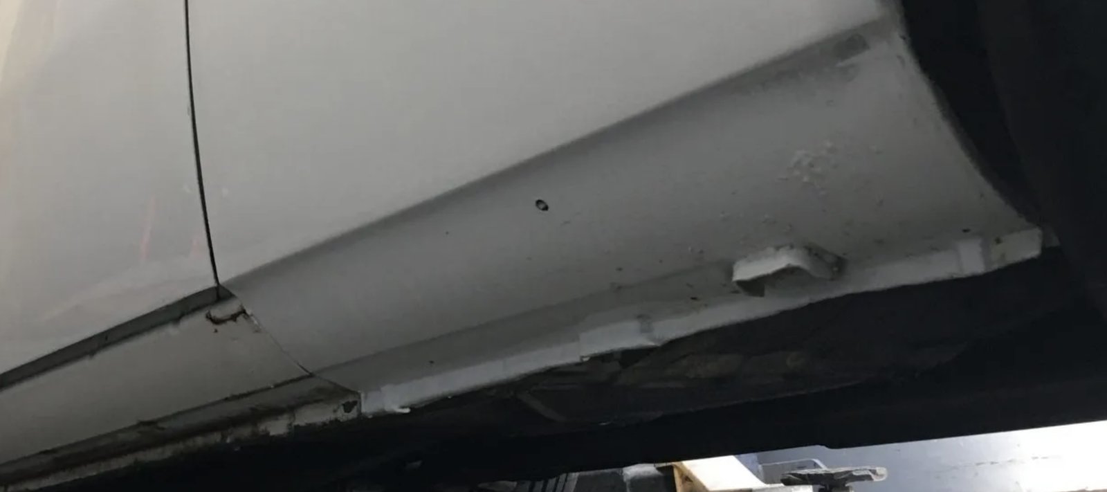

The only paint bubbles from rust are on the driver’s side rear rocker, and only visible after the black rocker cover is removed. This section behind the door has clearly been repainted - I don’t know if the metal was replaced during the 2003 refurbishment, or if they just sprayed over bubbles when the car had a partial respray 13 years ago? Either way, the bubbles are small considering that the paint is apparently at least 13 years old.
Because of how small they are, on solid metal, I will watch these rather than have them repaired now. I did decide to get a borescope to look inside. I’ll put all those pics in the next post:

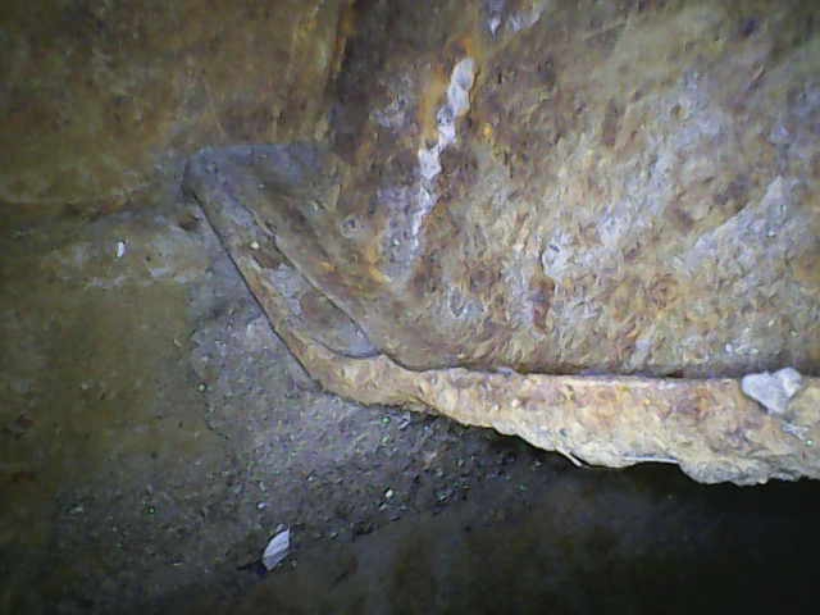

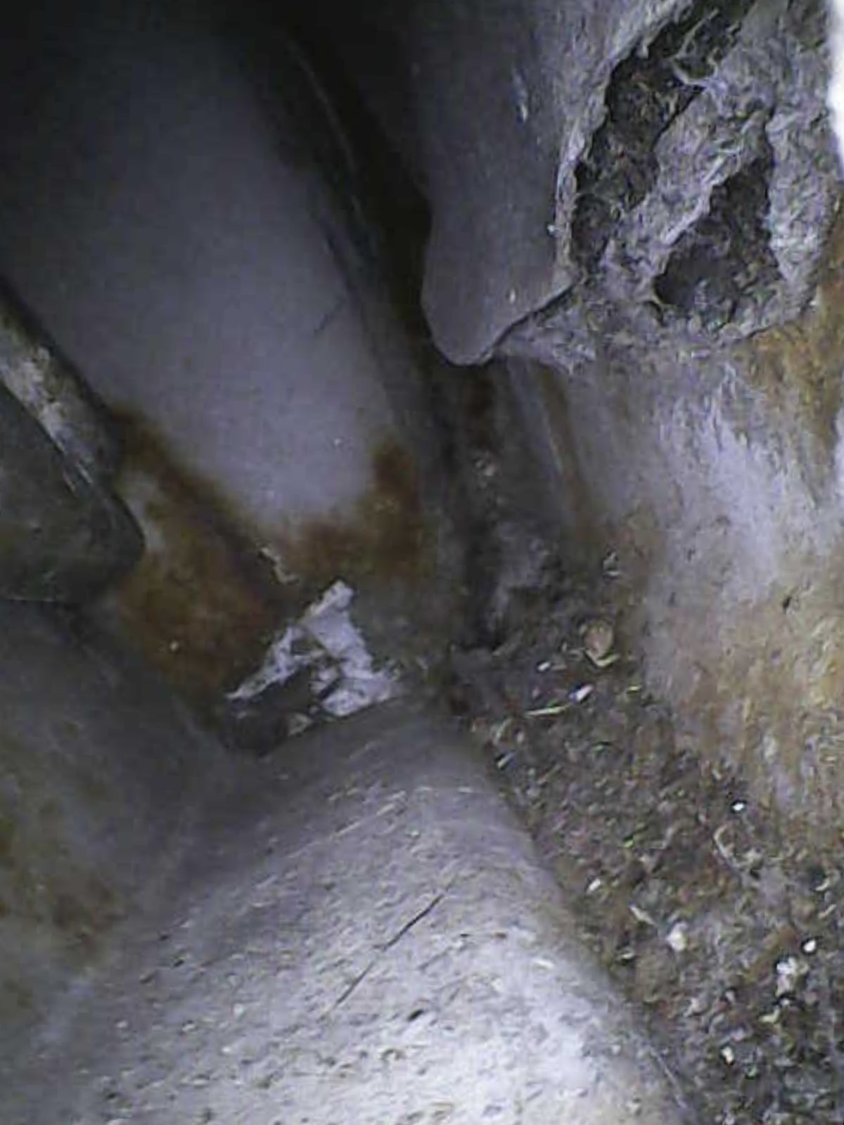

Ok, coupe, time for your endoscopy! First off, the L rear rocker where the rust bubbles are. It doesn’t look too bad inside, the rust must be coming from moisture trapped in the insulation and/or debris at the bottom. Either that or it is coming from the outside, where grit between the rocker cover and the metal scratched the paint?

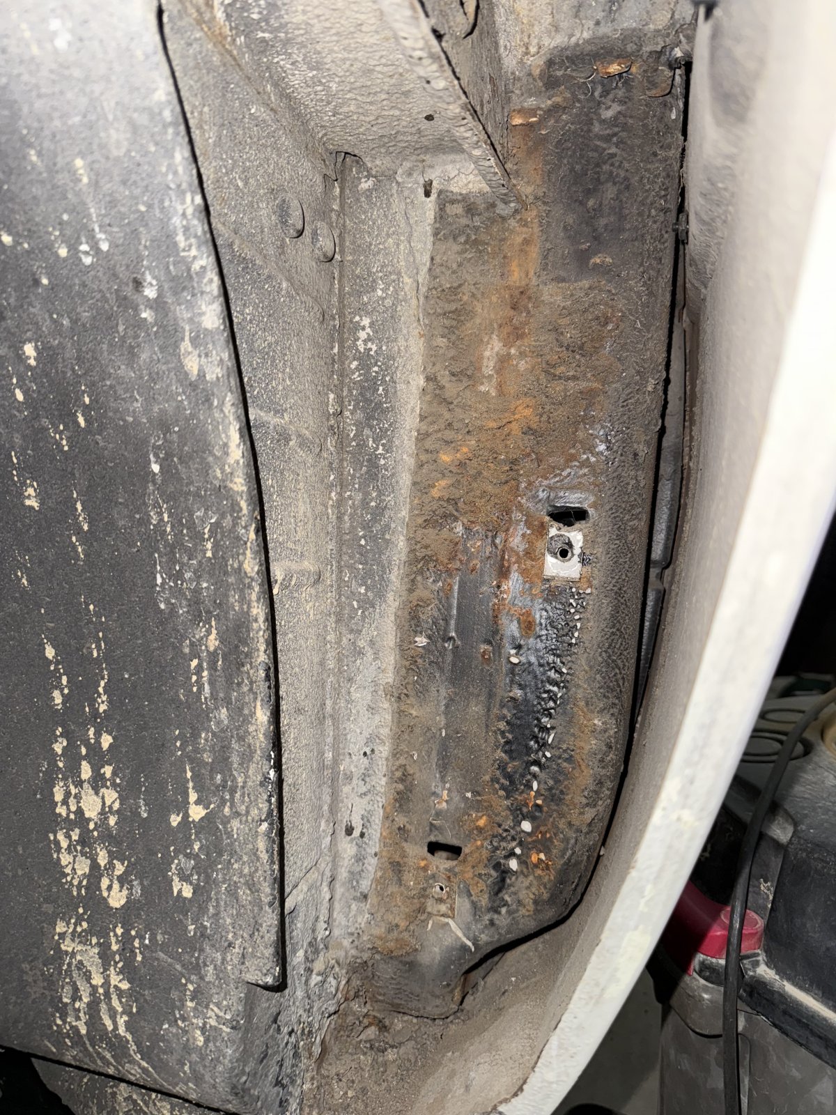

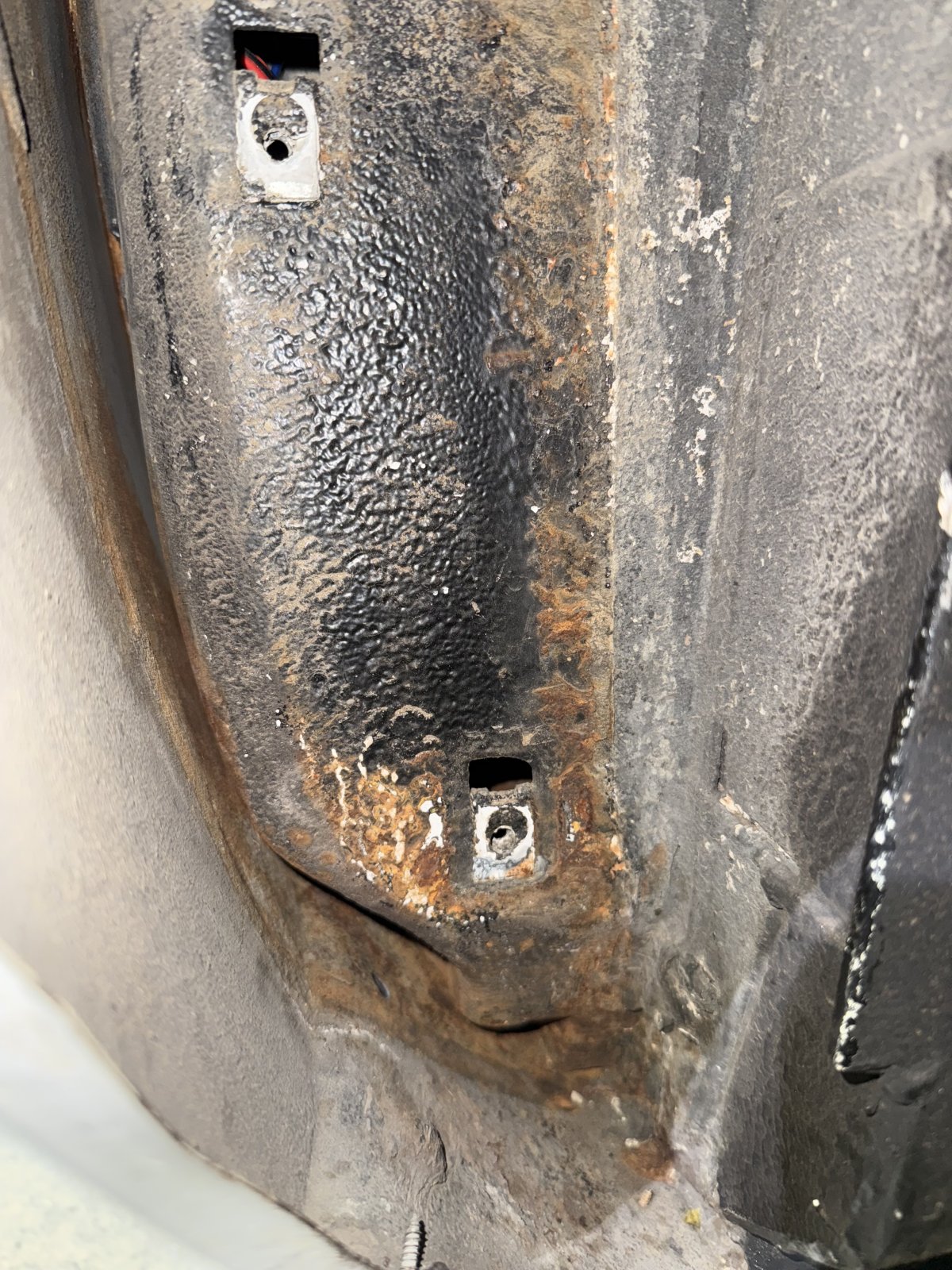

Next I got out my 10mm wrench and pulled off the panels behind the front tires. Here is the driver side before doing any cleaning:
Passenger side was dirtier, but after scraping a bit, it still looks pretty good:
I then put the borescope through the slots above the screw holes to look at the inside A-pillar structure As expected based on the “outside”, the passenger side looks worse, but still no bubbling/flaking to make me concerned that the metal is compromised. Driver:

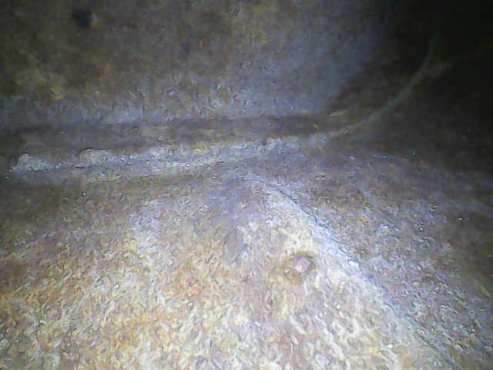

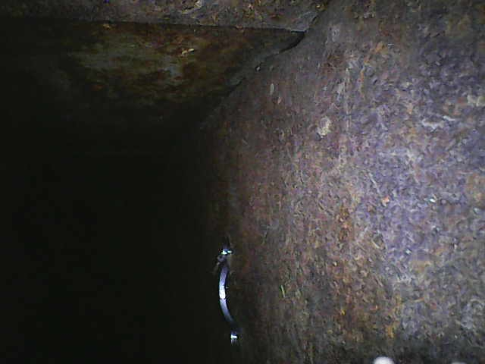

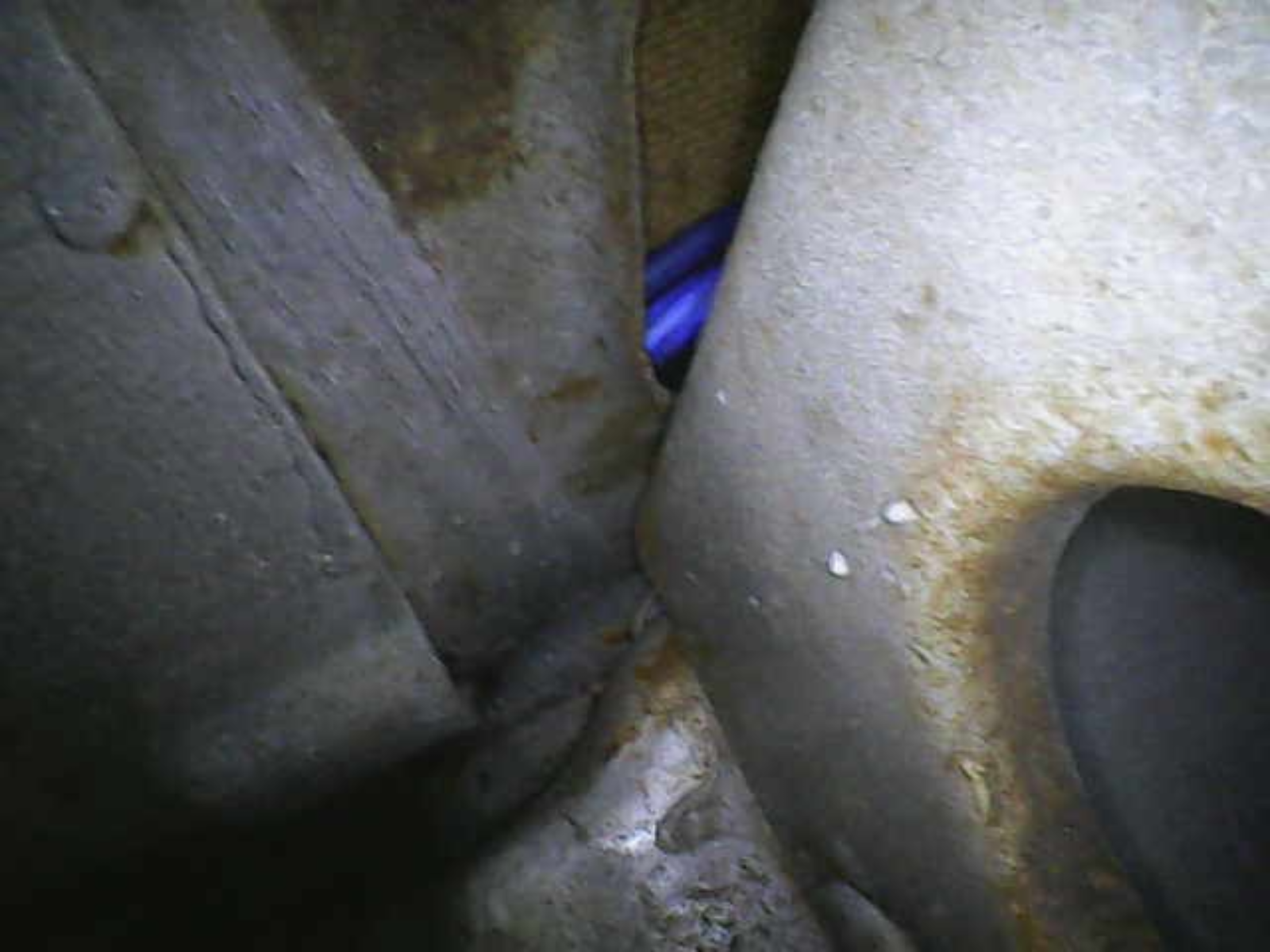

Next I scoped the box section frame rails. Here, the passenger looks better. The driver side has lots of surface rust but no bubbling or flaking. You can see where somebody drilled the rail to zip-tie a sensor cable that runs to the back of the trans. I think this drilling must be recent because you can see some bright steel burrs attached to the hole, that haven’t oxidized.
Passenger:
Driver:

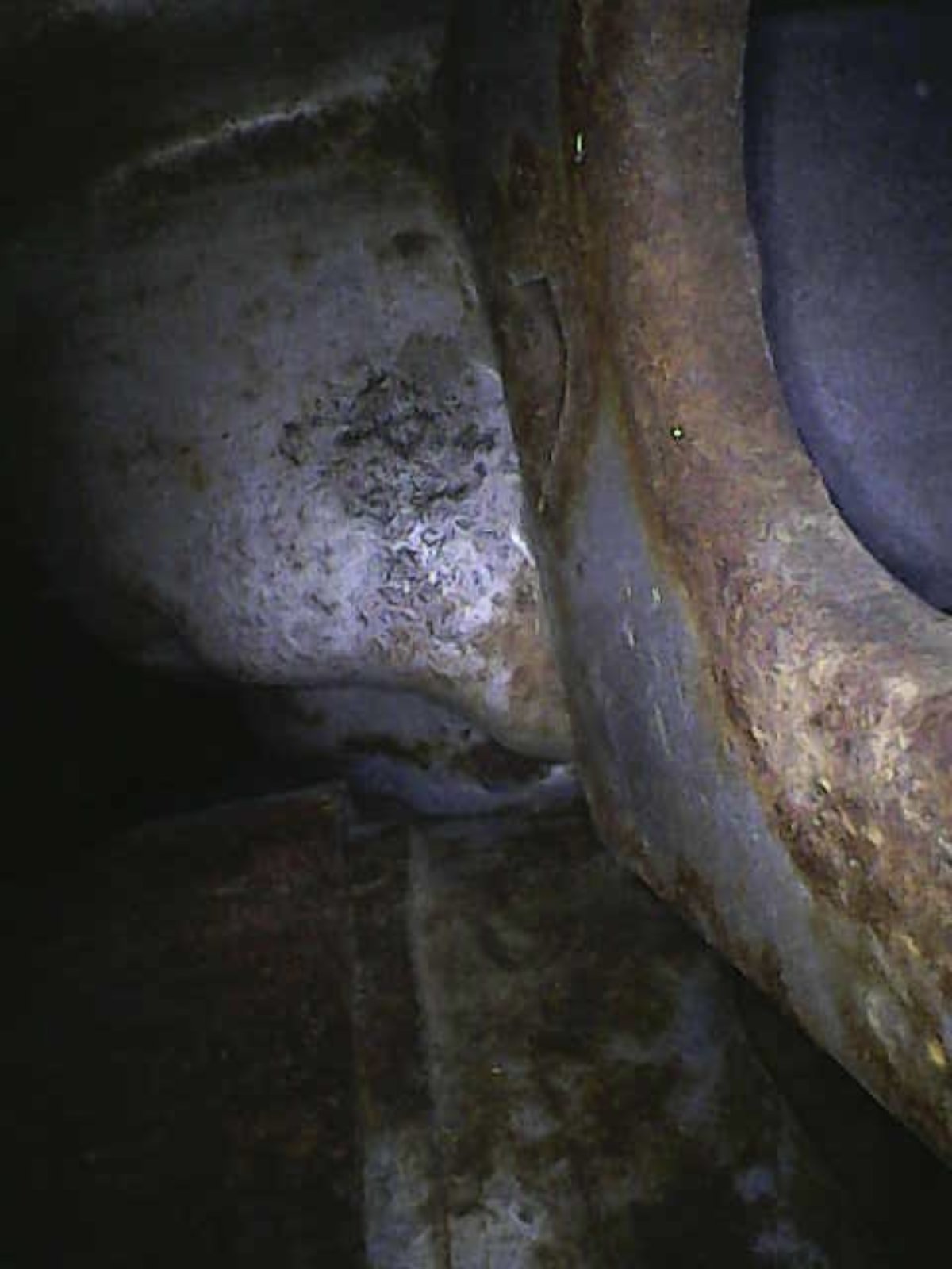

Lastly, I scoped into the open “sand traps” at the top of the front wheel wells. This time it is the driver side that has more surface rust. On both sides, you can still see the weld structure of the metal, so once again, nothing structurally concerning. I contorted my body to break up all the sand and debris at the bottom of these cavities, then used the shop vac to suck it clean.
Passenger:
Driver:
