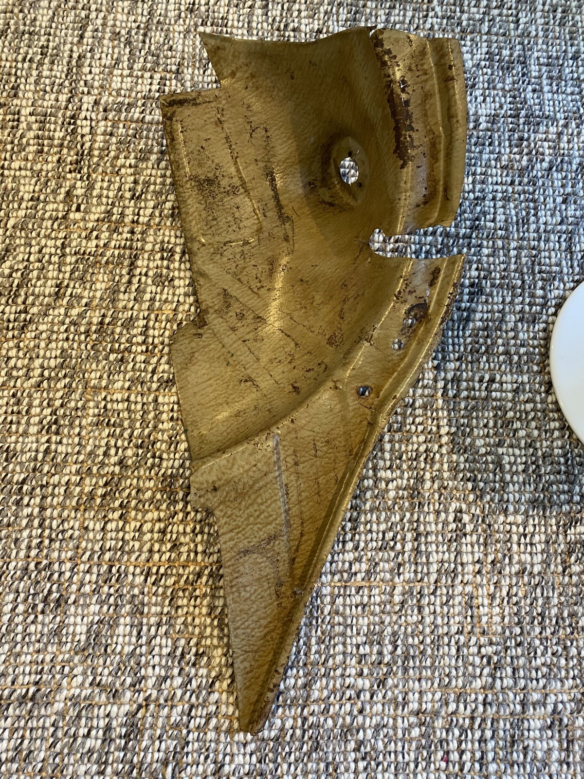

I am in the process of undertaking a refresh of my trunk compartment. I have a 74 and the plastic shock covers are very brittle as is typically the case. A few cracks here and there as well. So far I was successful in removing them both in one piece. before I attempt to clean them up and paint them with matching SEM paint I was hoping I could find a way to strengthen them up. Does anyone have any recommendations on something I might be able to spray on the back of them to add a bit more strength and flexibility? My immediate thought was possibly a bed-liner type spray product. Also interested in any products to glue up the cracks as well.

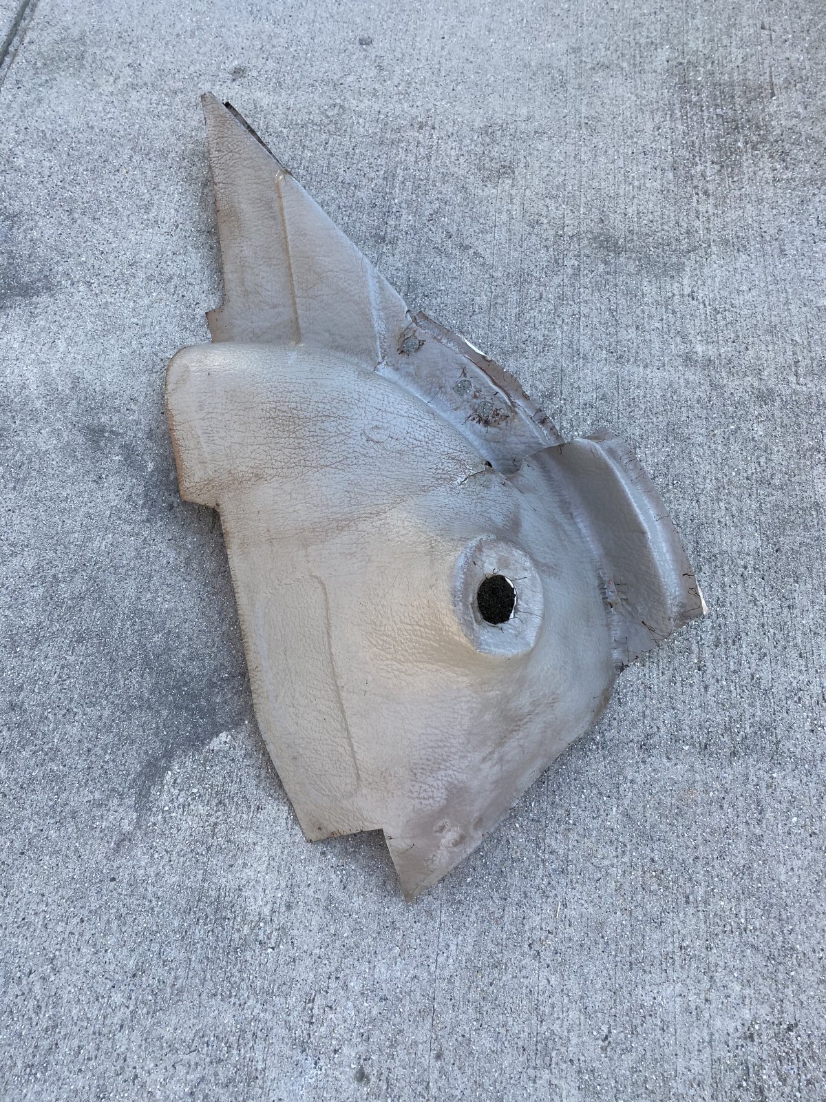

When I refurbished mine I used gel-coat to reinforce. Sure there multiple methods to achieve the refurbish.

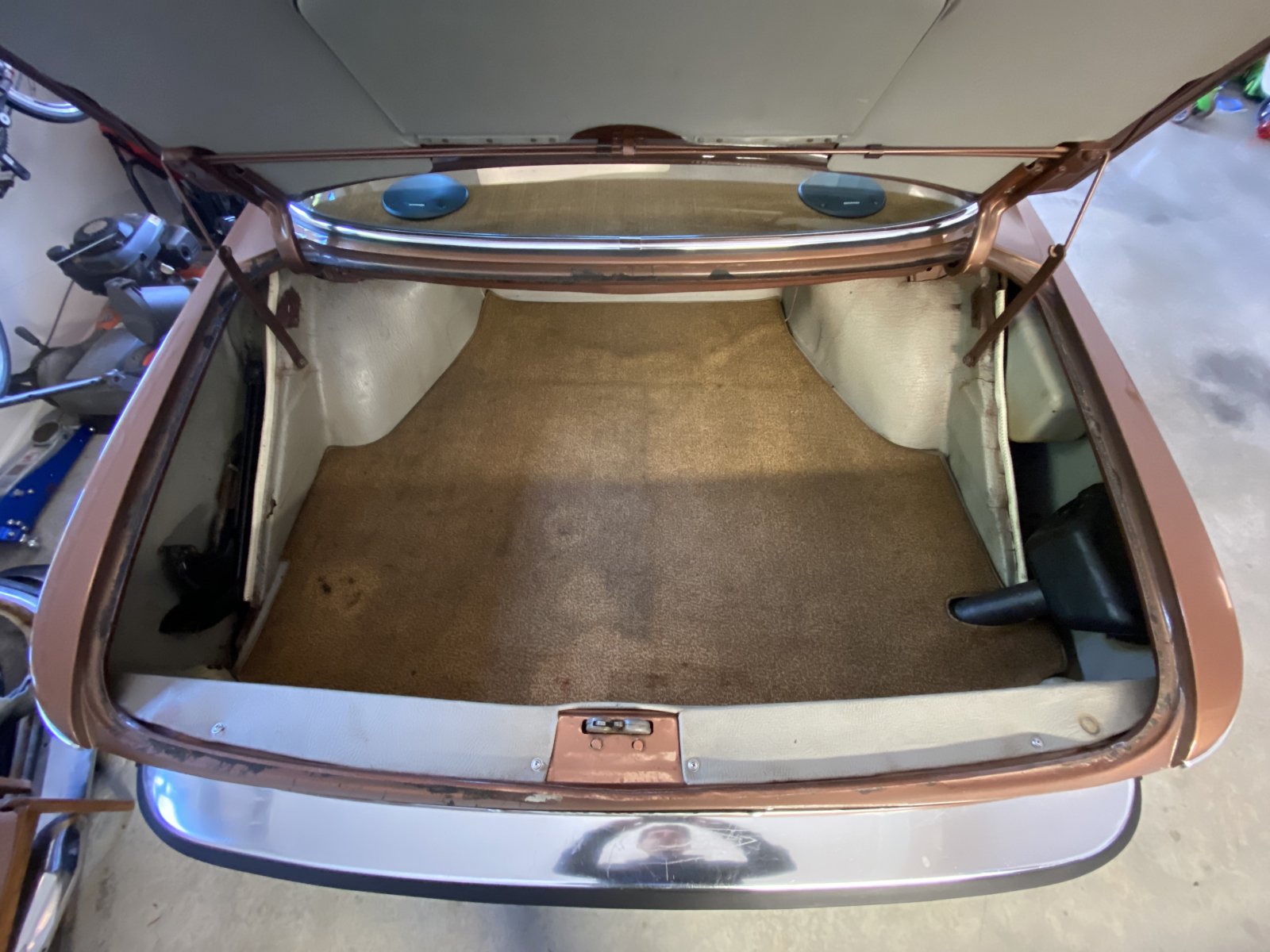

Hah! This is total mission creep for me. I started with simply wanting to swap my rear 74 bumper for a 72.... now next thing I know I’ve got the trunk stripped, tail lights out and being refreshed, and the list goes not. Thinking I may as well sand and paint the truck compartment too as it was poorly done during a repaint in the past. Very slippery slope. I guess I can’t help myself.

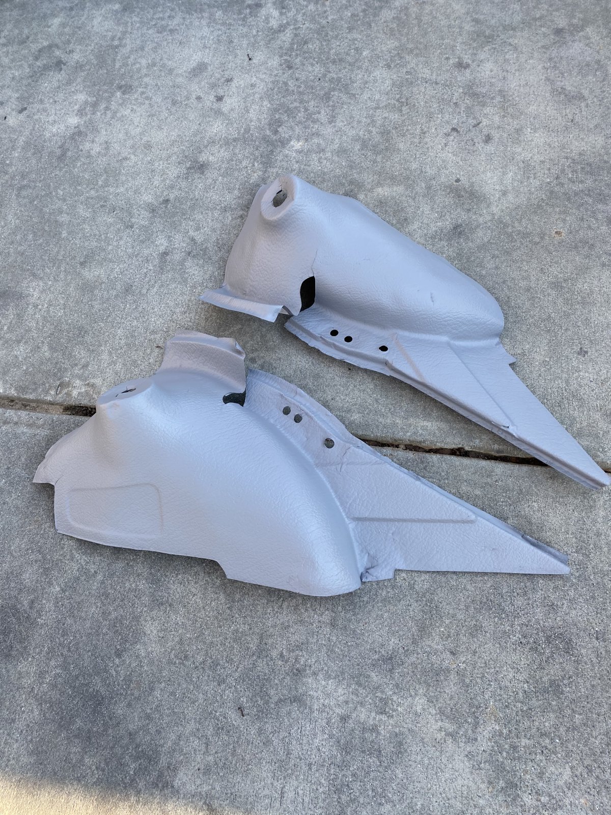

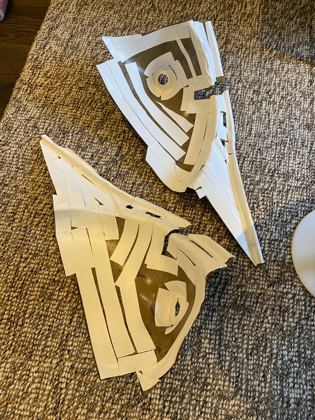

I ended up applying a flexible butyl tape. It’s thin and when bonds it grips incredibly tight with a gummy adhesion. It becomes one with the plastic. When I was done I was amazed at how solid the pieces felt. They have some heft and are flexible all at the same time. It works great where their were cracks to tighten them up. Need to be careful though because once this stuff sticks on, you won’t be able to get it off.
I then used some epoxy I had on hand to fix the cracks.
