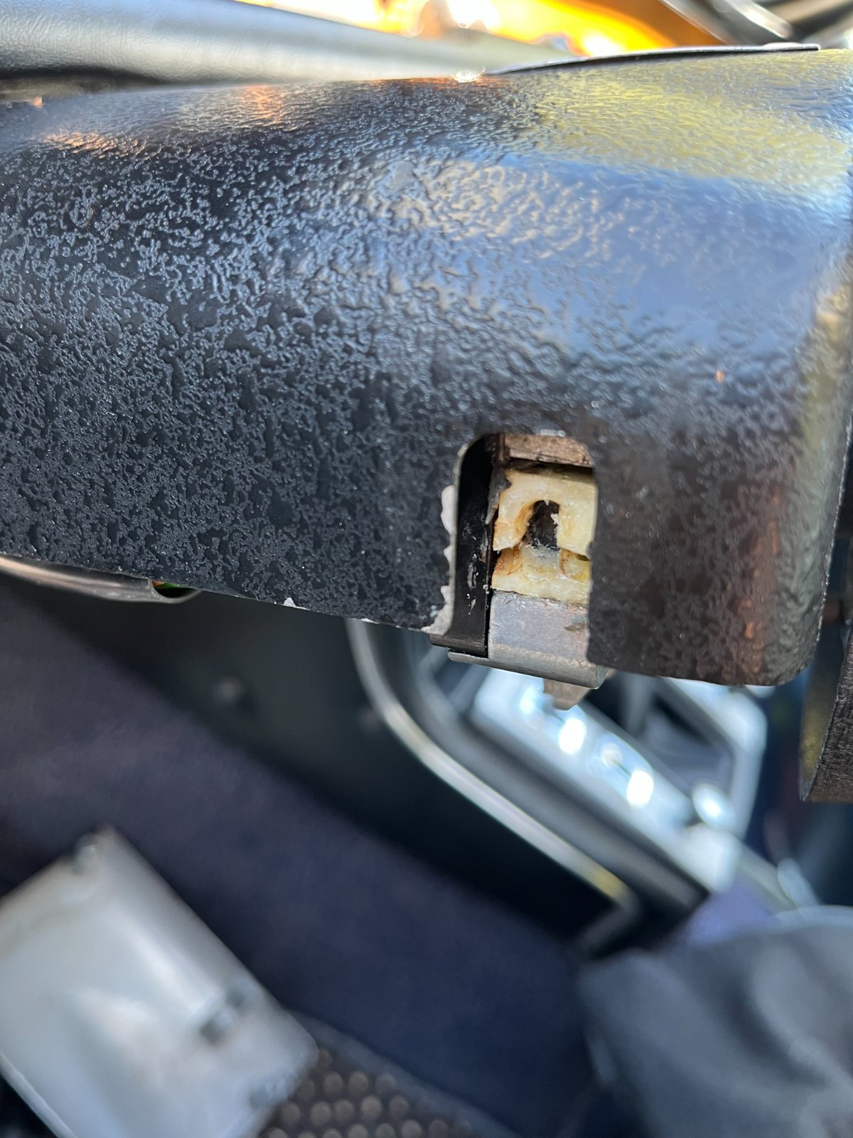

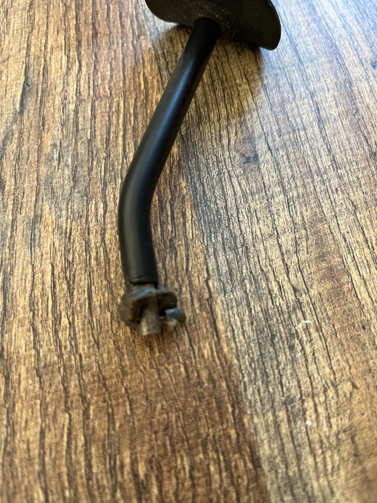

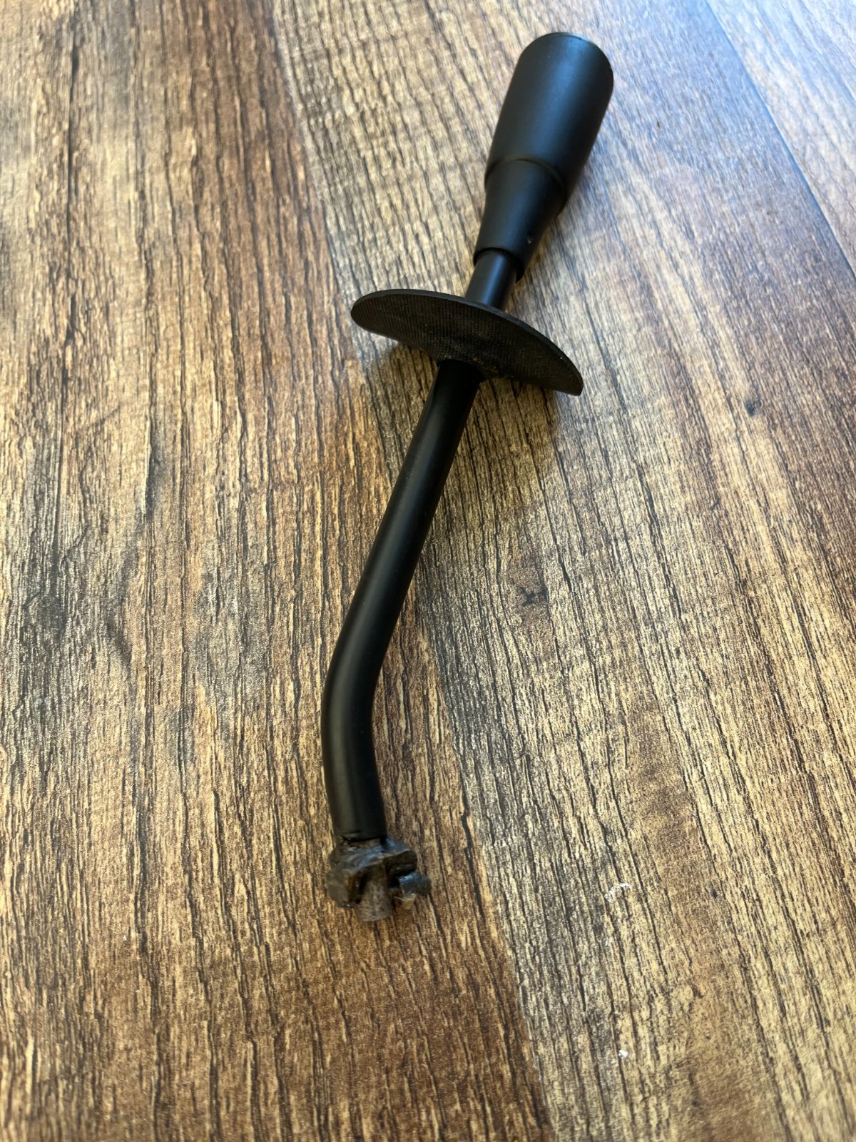

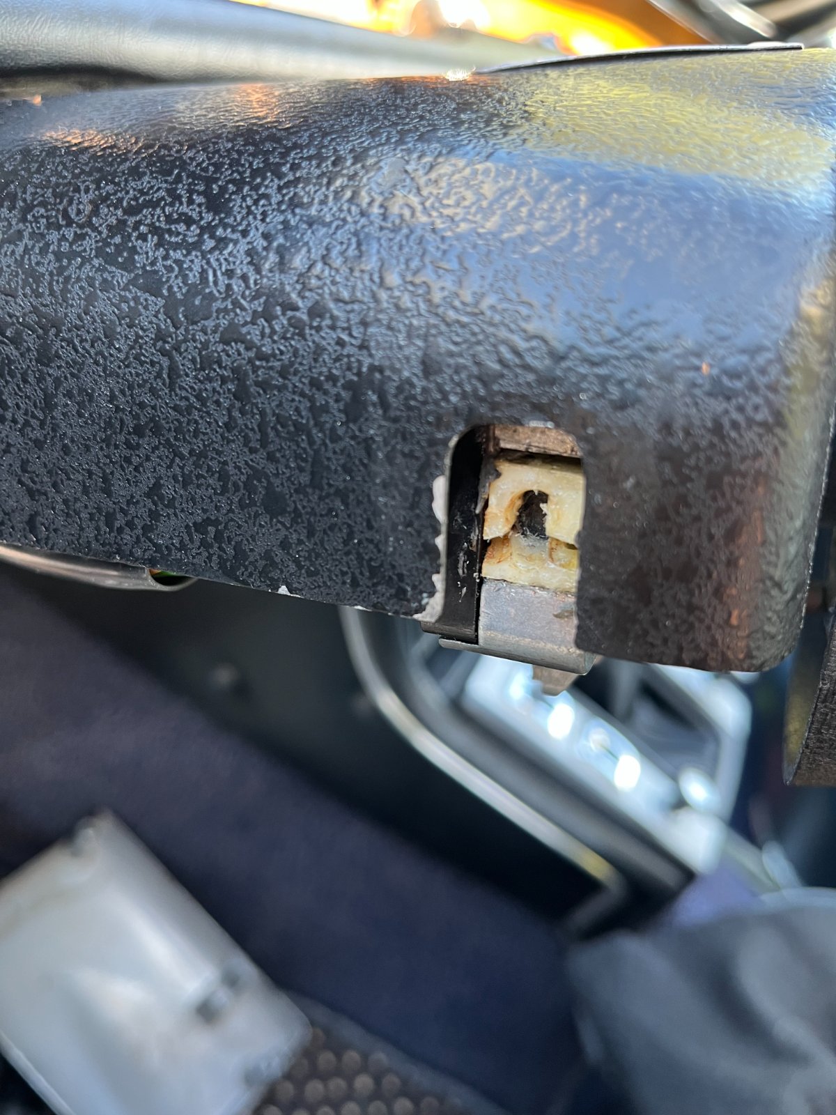

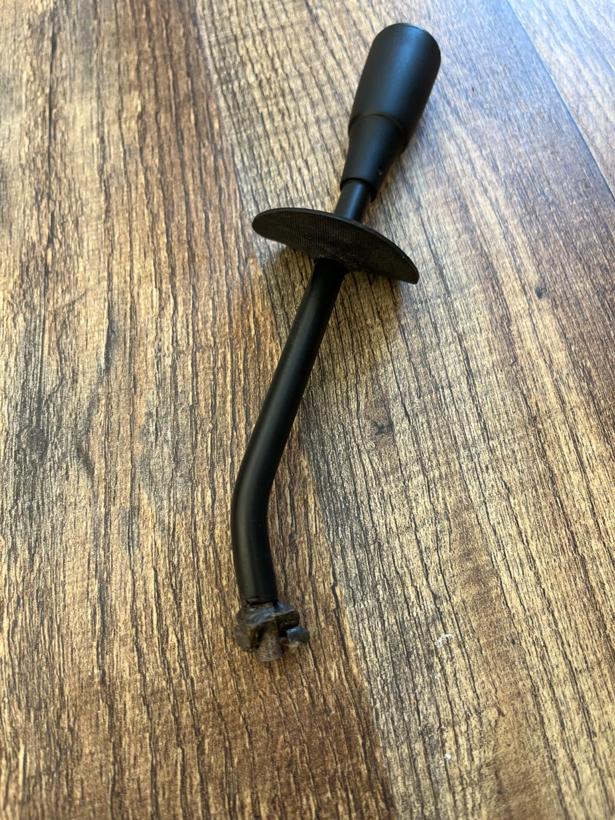

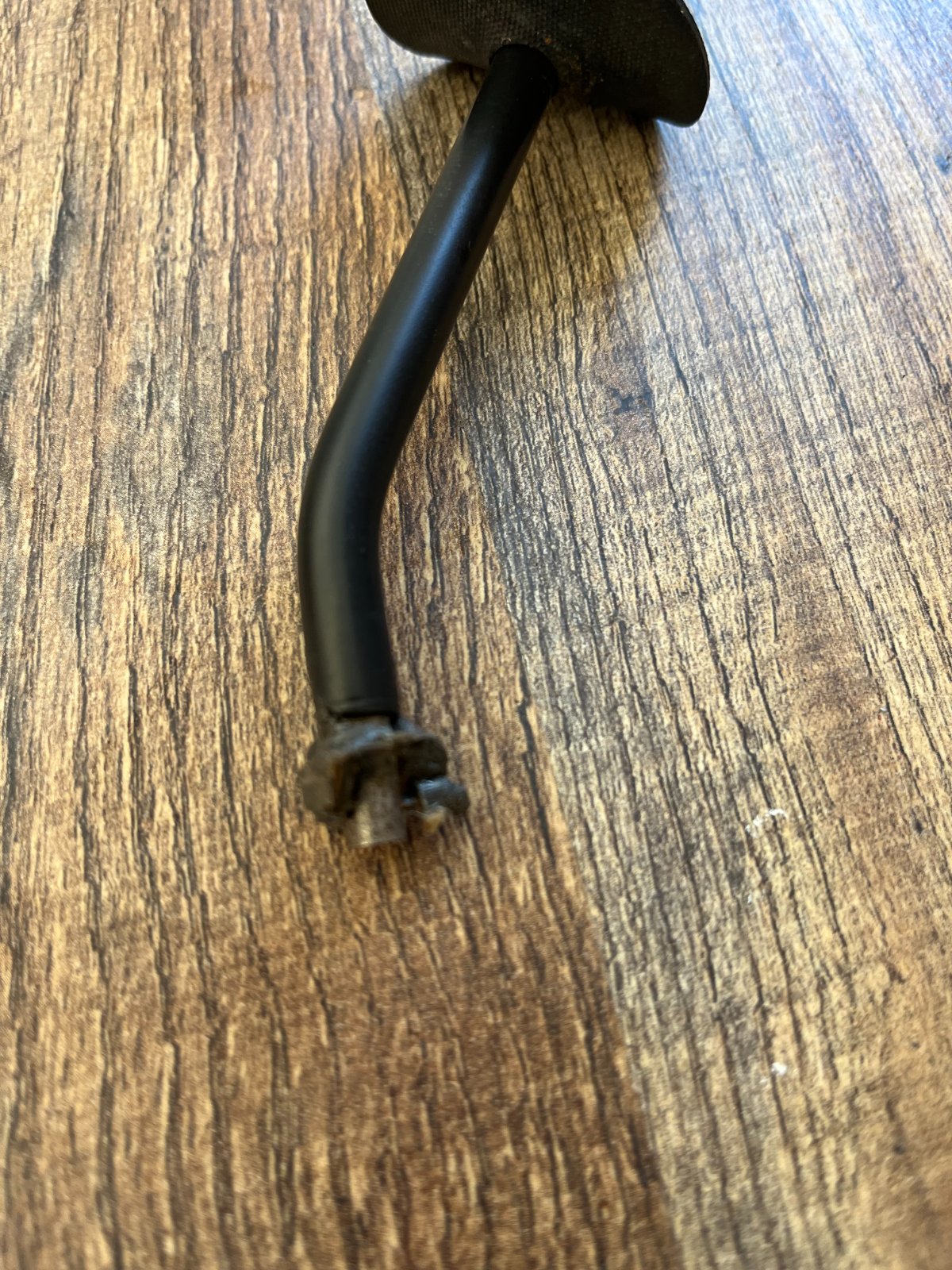

Me headlight dip switch just broke. Looks like it may have been glued in. My questions are
1- Advice on repairing? Maybe just glue it back. Seems to have worked for years
2- Replace swithch? Does anyone have one or know the part number. Does the stem just pressure fit into it?

If you are looking for a replacement let me know, I should have one.
Regards
Thomas
Mine always break in the bright position! E9 and E24. I replaced quickly as the list of detractors grew really quickly every night...
New one it is!

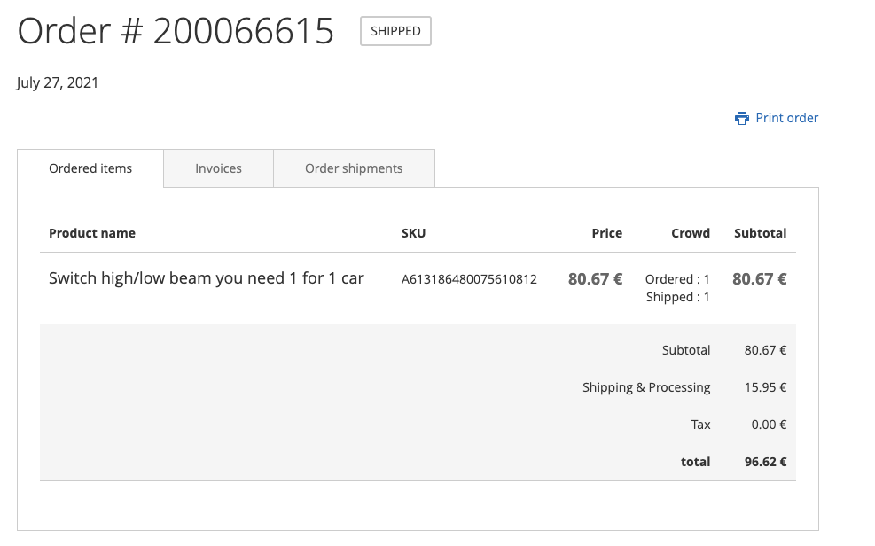

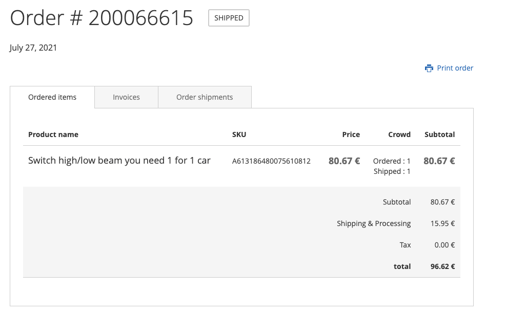

W&N. get a 2002 one and adjust the plastic covering. You may need to do some simple changes to the connecter, but they only cost about €70 whilst I was offered one for $600 as NOS.
