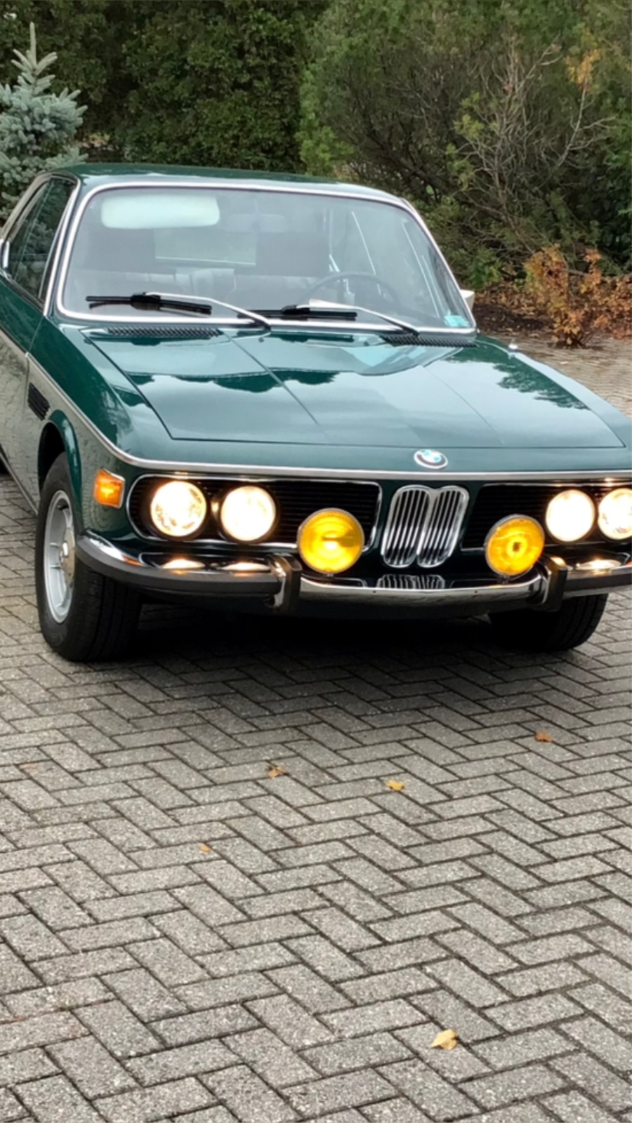

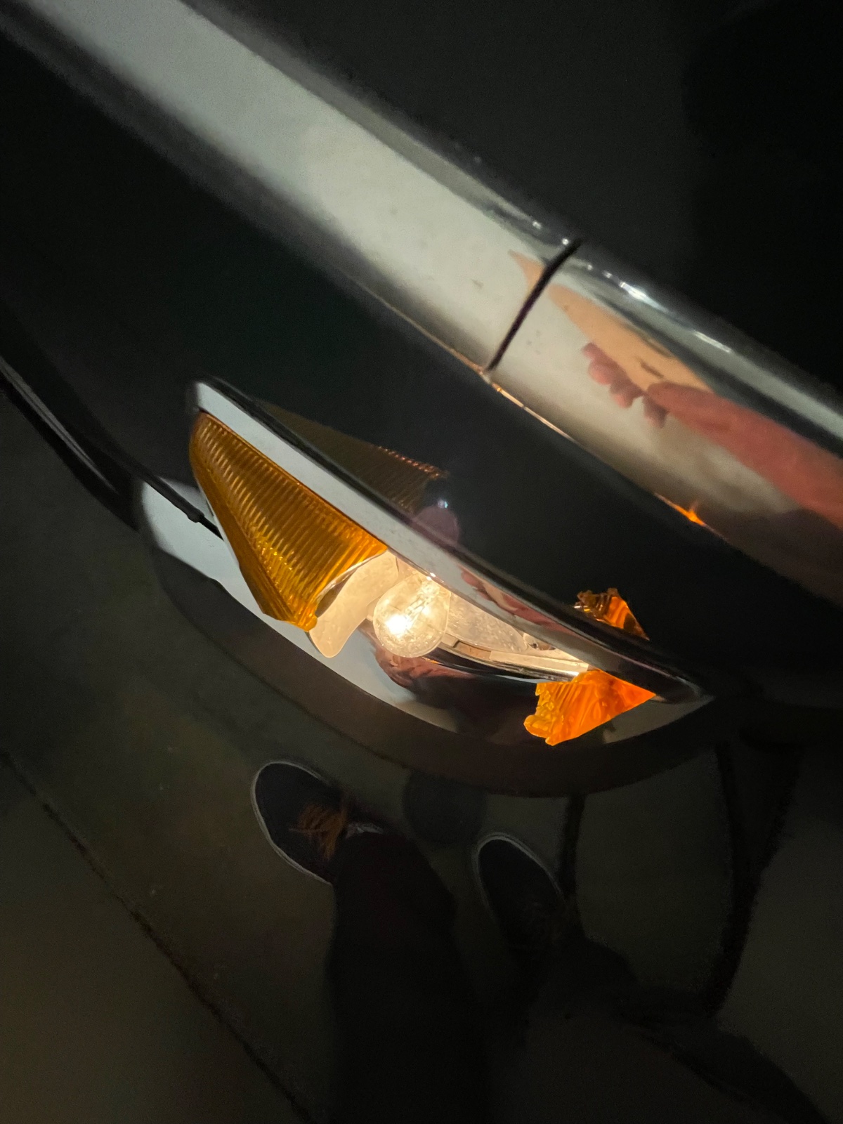

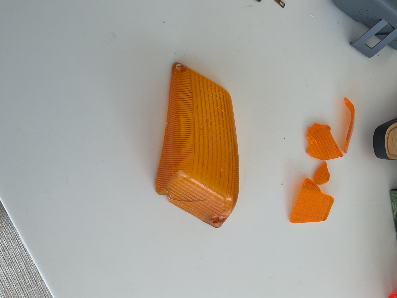

Sadly, I broke the lens; the first damage, ever, on my original ‘73 3.0cs. I have an old one saved from my bare metal restoration in the’90s, but would like to find a new replacement. I now live in Vancouver Canada . Help is greatly appreciated. Cheers, John

John, it looks like a Euro lens and not a US lens but let us know which one you seek.

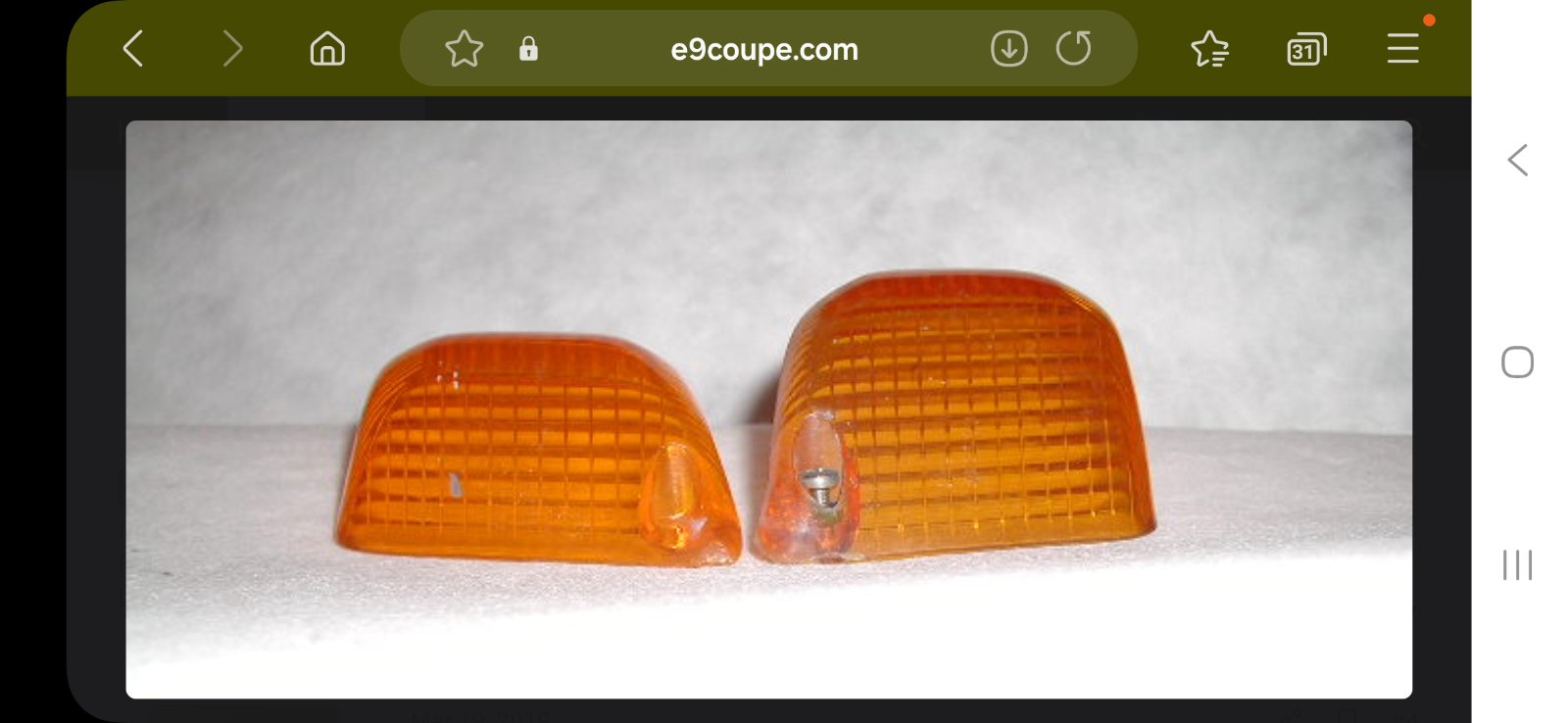

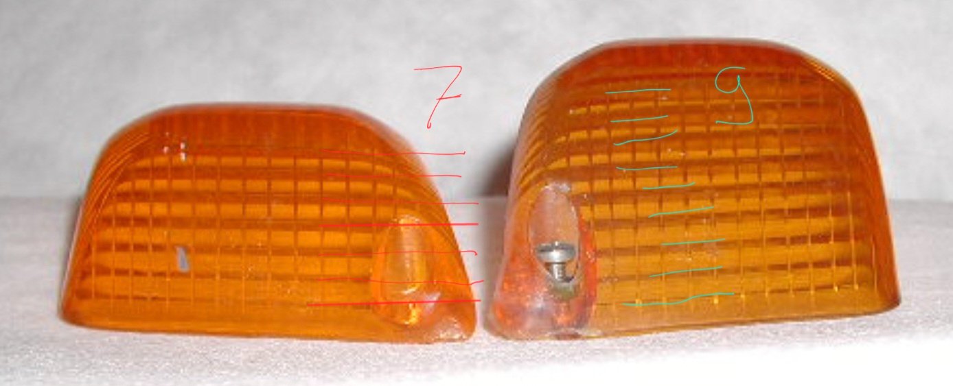

Here's a pic from our site (thanks @Gransin !) that shows the taller US next to a slimmer EU version.
I always count the lines on the side, and see 7 lines on the EU version, and 9 on the taller US version.

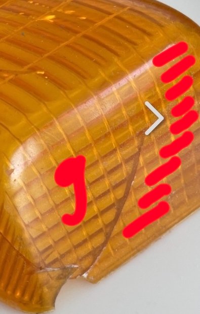

Your pic with the one with a crack shows 9 lines, so I think you have US spec lenses.
