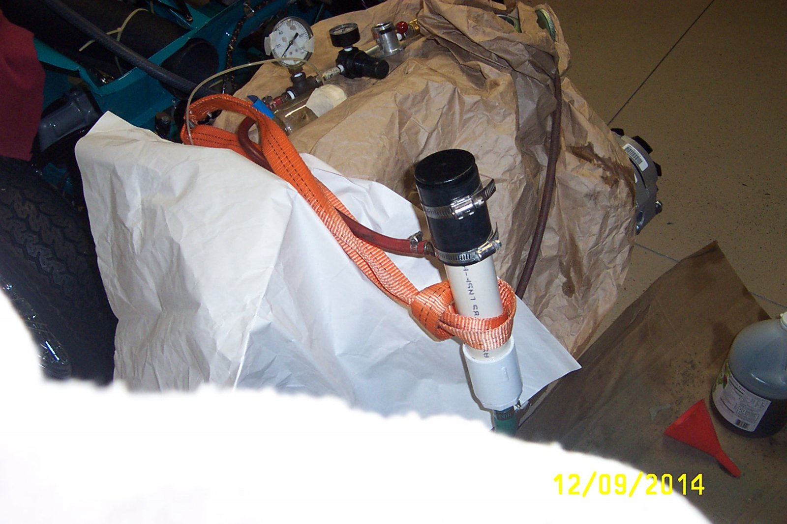

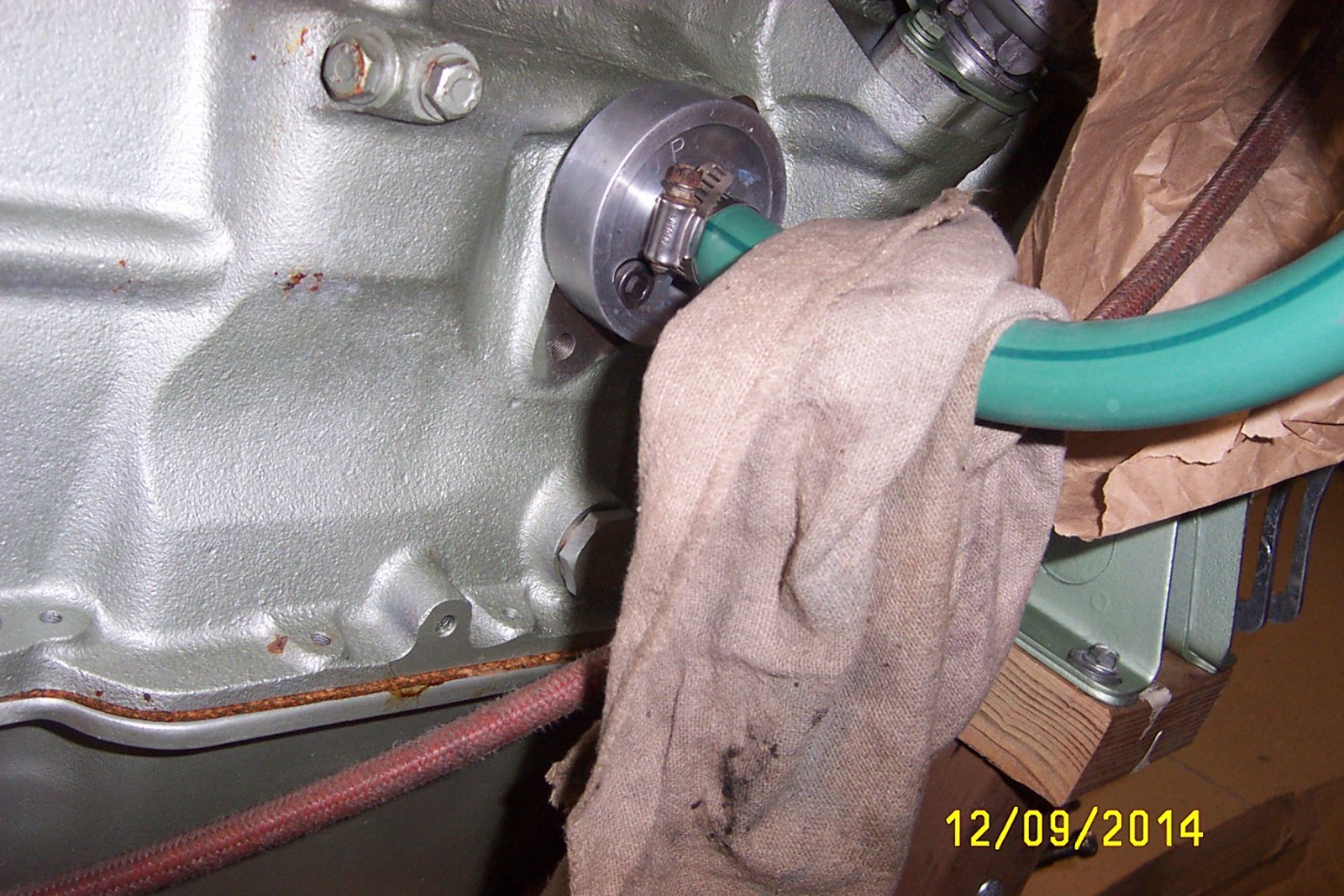

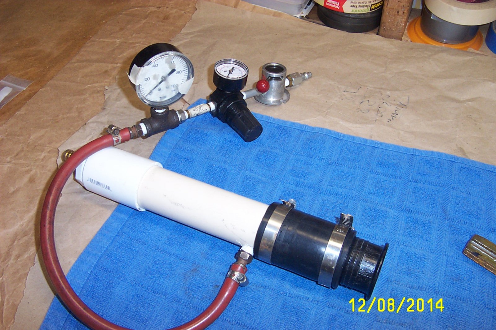

I remember a few years ago we did an Austin Healey 3000 motor and had to make a air pressure feed gizmo of some sort to insure oils got to all the bearings, etc. This was instead of spinning and spinning the engine. It was a static procedure. What we did was to air force oil in thru the oil filter adapter. A few pics are included for the healey engine.

Regarding the Healey procedure. No my recollection is none. As i remember the issue was to get the oil to the bearings first. Something to do with the oil passage routing. By going directly into oil filter housing it delivered the oil to the bearings. Anyhow that was years ago (memory fuzzy) but it did work. After doing so we spun engine after oil filter install and up came the pressure. Maybe at the end of the day it was just a science project, but it was advised by the gurus on the Healey six forum.

The Healey procedure was static, the engine was not spun when the pressure to the small oil reservoir was applied. I suppose one could think of the air pressure forcing the oil into the case as acting like an oil pump. If I remember some even slightly heated the oil.
