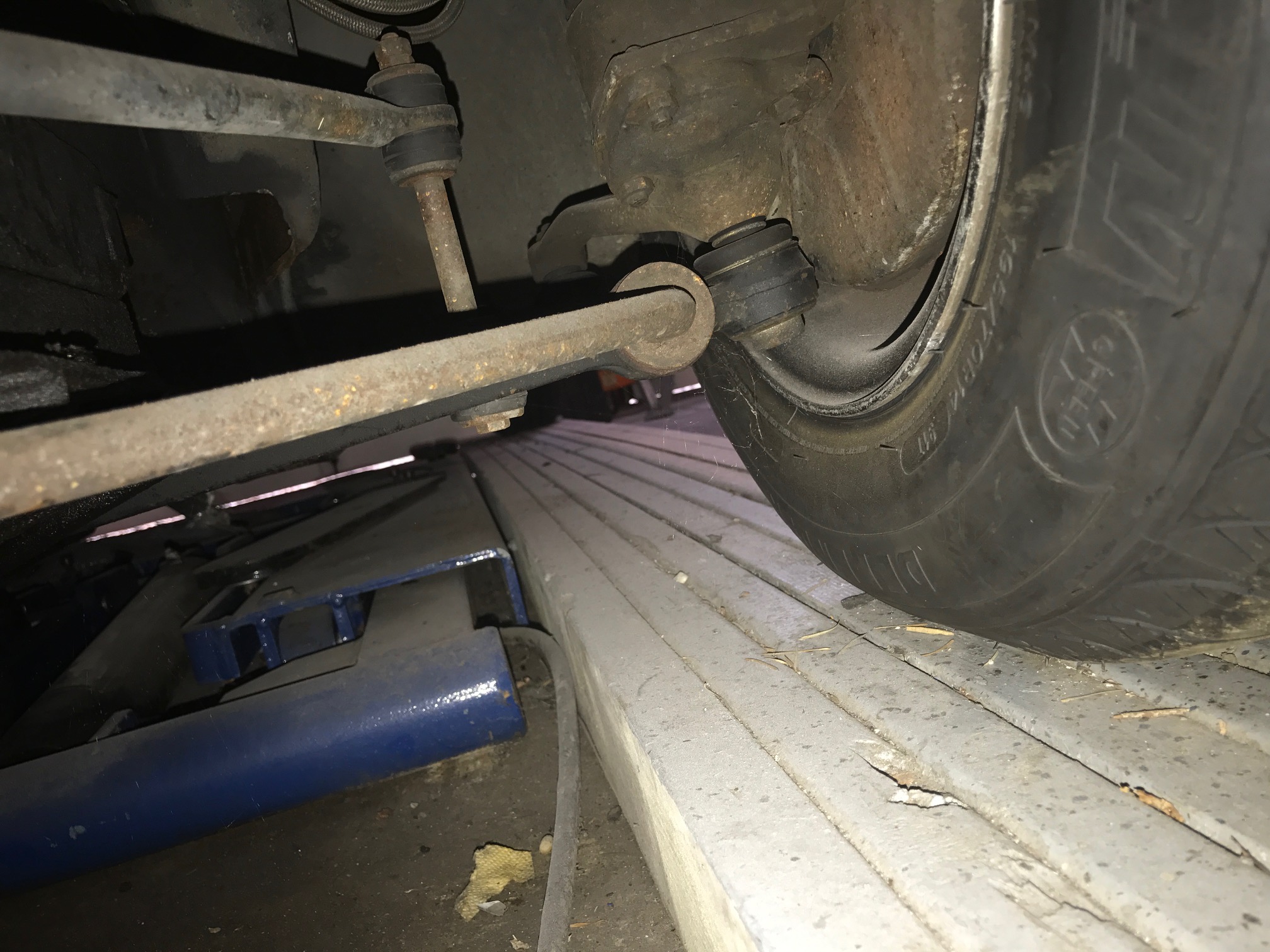

My opinion is it's pretty close to a 1:1 ratio, to get the steering parts and A arms back in to the range they were designed to work in. That means spacers of 2 and 3 inches would be useful, given how much some cars are lowered. However, as noted, they will not fit. Below is a look at my strut with 14" wheels, I bet I could use an inch spacer before the ball joint would hit the rim. In the 911 world it's the same, the amount you can "raise the spindles" is driven by your wheel diameter. Larger diameter wheels, the more "spacer" you can use.
Which brings up another point. In the 911 world, the "correct" way to lower the car is to raise the spindle on the strut, then bend or adapt the steering linkage with spacers back to stock geometry. The benefit of doing it this way is getting the steering linkage right, same as these spacers but it also preserves wheel travel. So, if you lower the car a bunch and use large spacers like this, you have better geometry but you are still running the suspension near the bump stops unless you also shorten the strut and use a different insert. That is where I am headed, eventually, now that I have a welder.
All that being said if you can verify an inch spacer would fit 14" wheels that would be a useful size.
