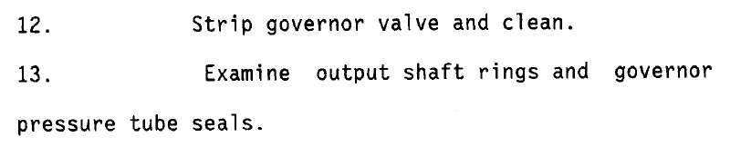

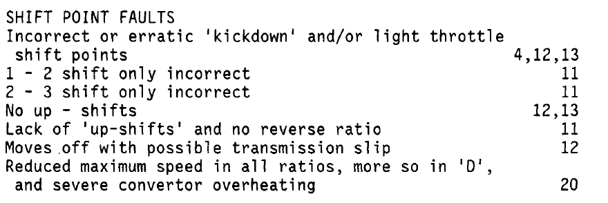

Is kick down cable too tight ?, otherwise could be that the governor valve is not working as it should
