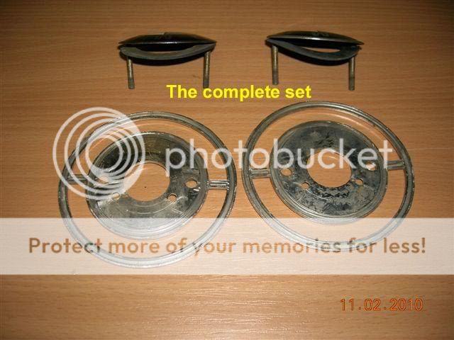

let me explain myself
this is what i meant by the original parts (the type, depends on the production year):
the emblems (in the topof the photo ) have a very long screw that goes inside the car, so you "must" dissassemble the trim panel to get the nuts out, it is impossible to dissasemble this type from outside
the roundels in the bottom of the picture will have two simple screw accesible when you remove the emblems

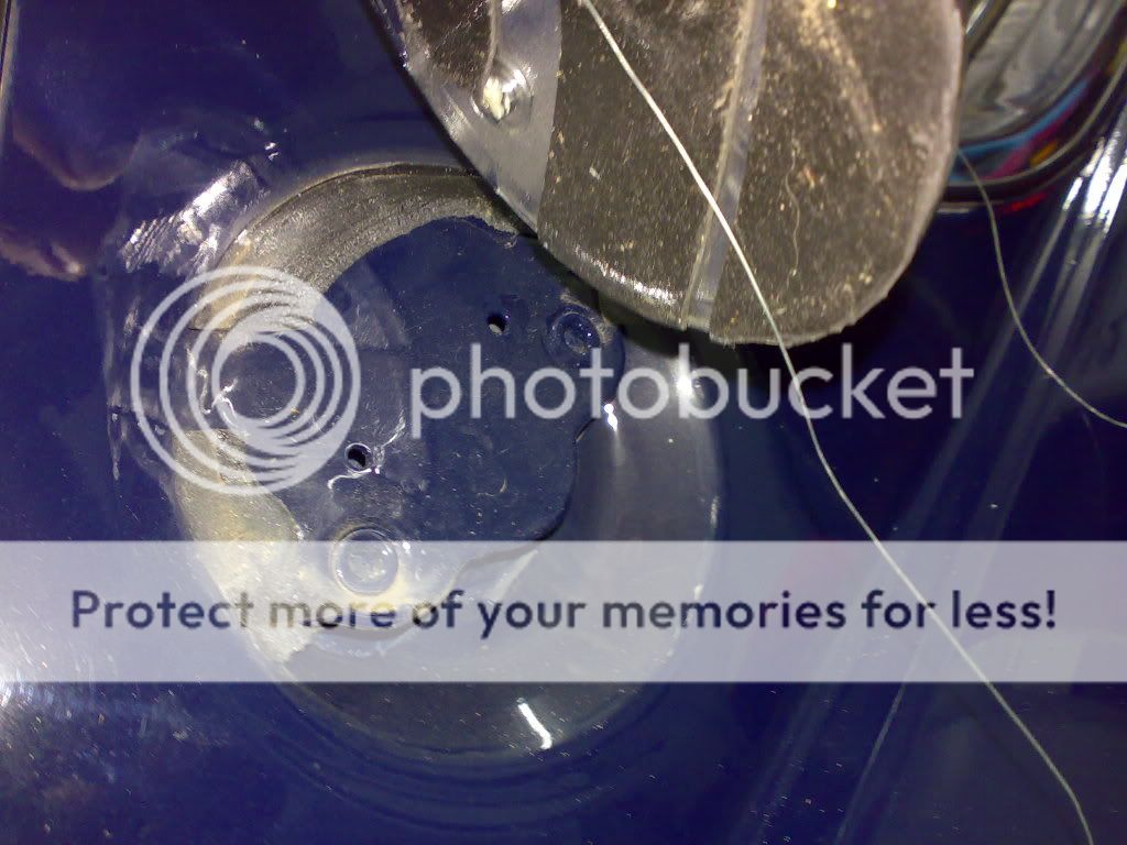

i drilled my front emblem support pins because some stupid worker replaced that emblem and glued it with polyurethame mastic, so it was impossible to remove it, it is a dramatic solution when everything fails, but in this case it will be also a good idea if you dont mind destroying the old emblems

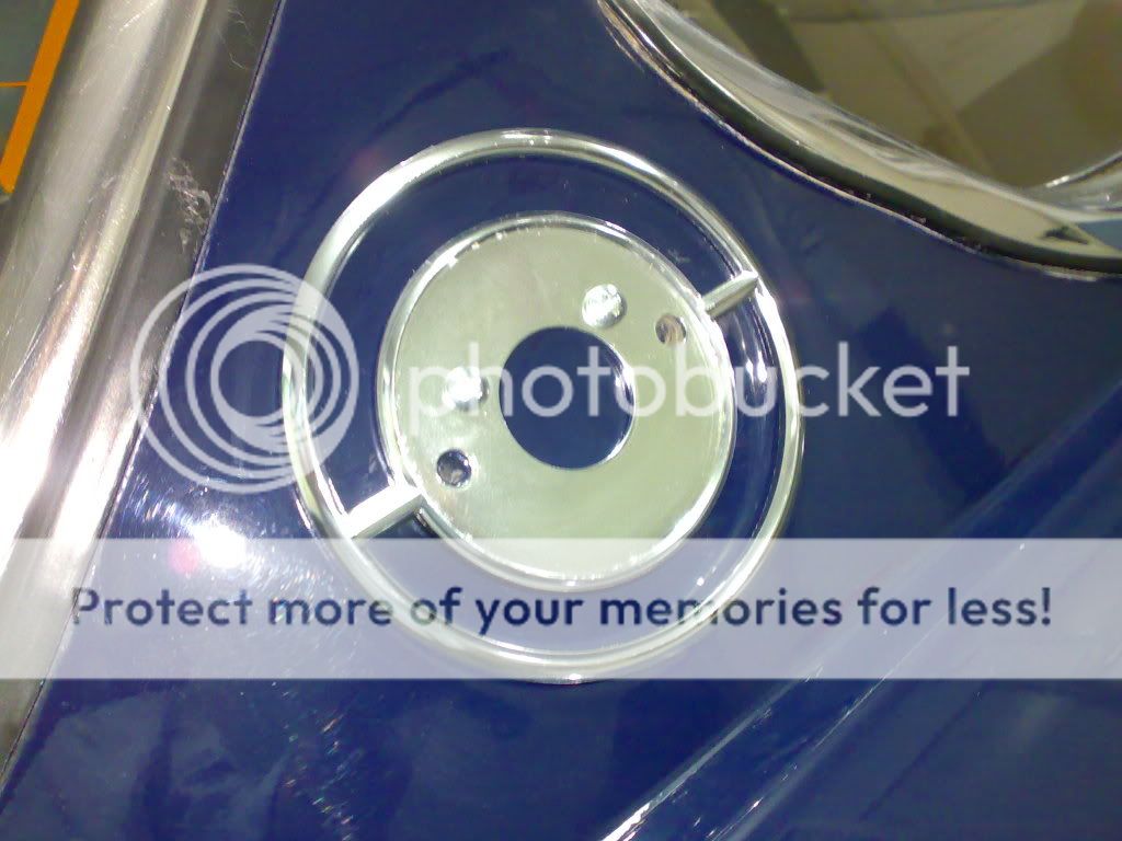

here you can see a pic of the support area
in the pic you can also see the small plastic caps that will allow the emblem clips to enter and fix
here you can see the installation of the roundel with 2 simple screws
