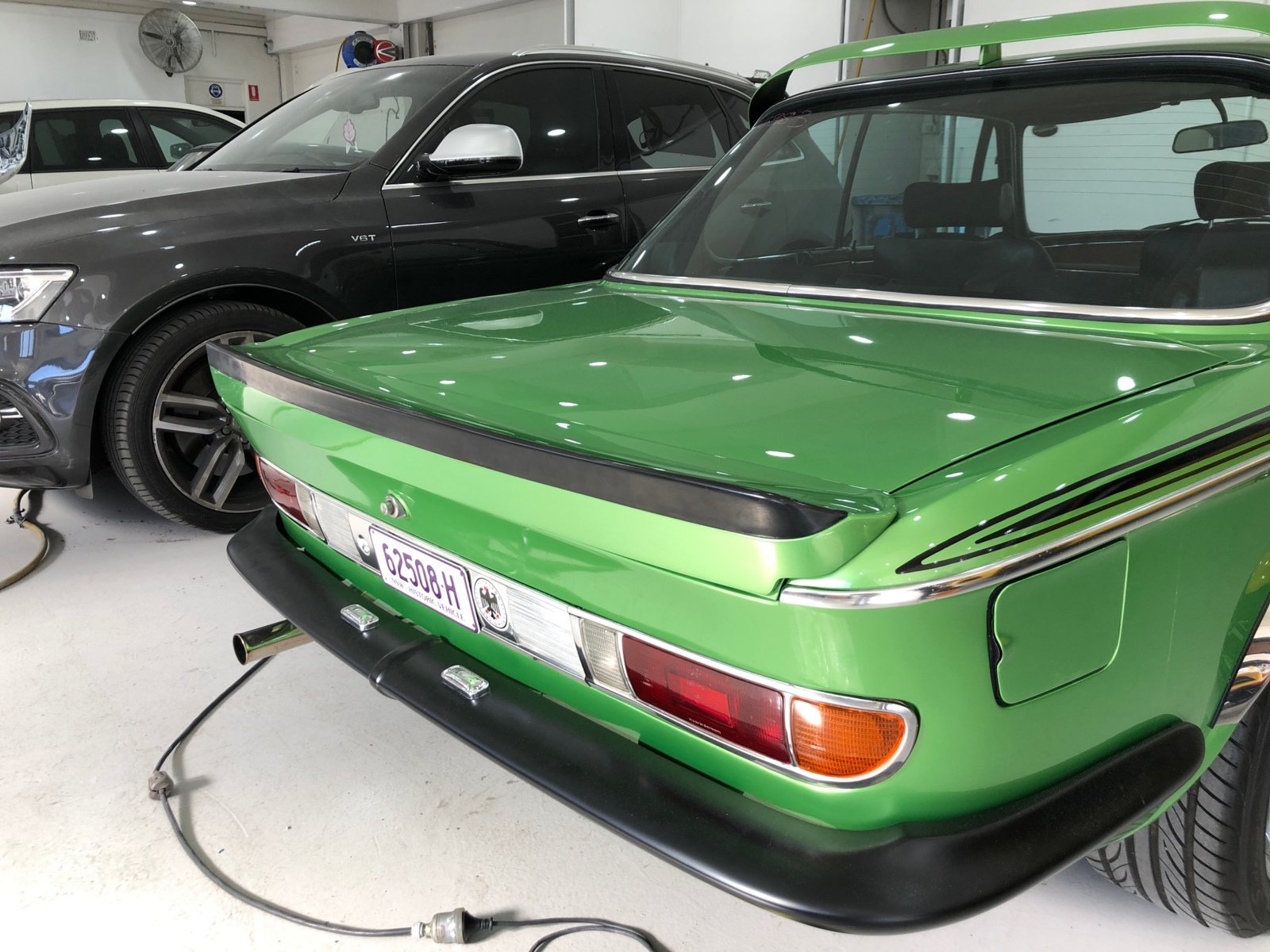

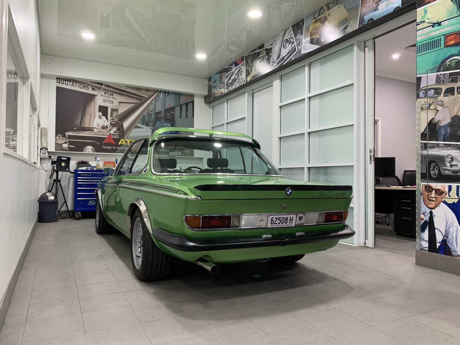

Really need some advice here as facing a bit of a dilemma.
I have had my car in getting a boot repaint and a small spoiler installed. (I managed to acquire an original CSL spoiler, this spoiler is not a recent repo version)
When I briefed the body shop I wanted the spoiler flush with the boot-lid however the reality is the curvature on the spoiler is slightly more of a rounded arc so sits about 6mm proud of the metal on edge of boot-lid in middle section. (the corners match but it bows out ever so slightly in the middle section)
I have looked at many photos of other cars, some spoiler installs also have a slight 'overbite' vs the rear lower centre panel, yet I have also seen other spoiler installs where they seem to make the spoiler perfectly follow the curvature of the boot-lid and flush with panel below.
I really need advice as I was hoping to pick up my car today all done. The body shop is very accommodating so would be willing to take off the spoiler and try to fettle around more, but it is already mounted (so hassle to get off) and no guarantees it can be made to sit flush the way I hoped, as with a wider arc on the spoiler it may be impossible ..... Could be opening pandoras box to try.
Anyway just wondering what I should do - just be happy with a slight 'overbite' as per the photos or should I keep pushing to get perfectly flush and flat, which might also be impossible.
Most important question is what would they have looked like when installed from 1970's era? If anyone has an original spoiler on their car, I would love to see how it sits.
(PS On the bright side they did lovely paintwork. Badge and decal going on soon)
My car below:

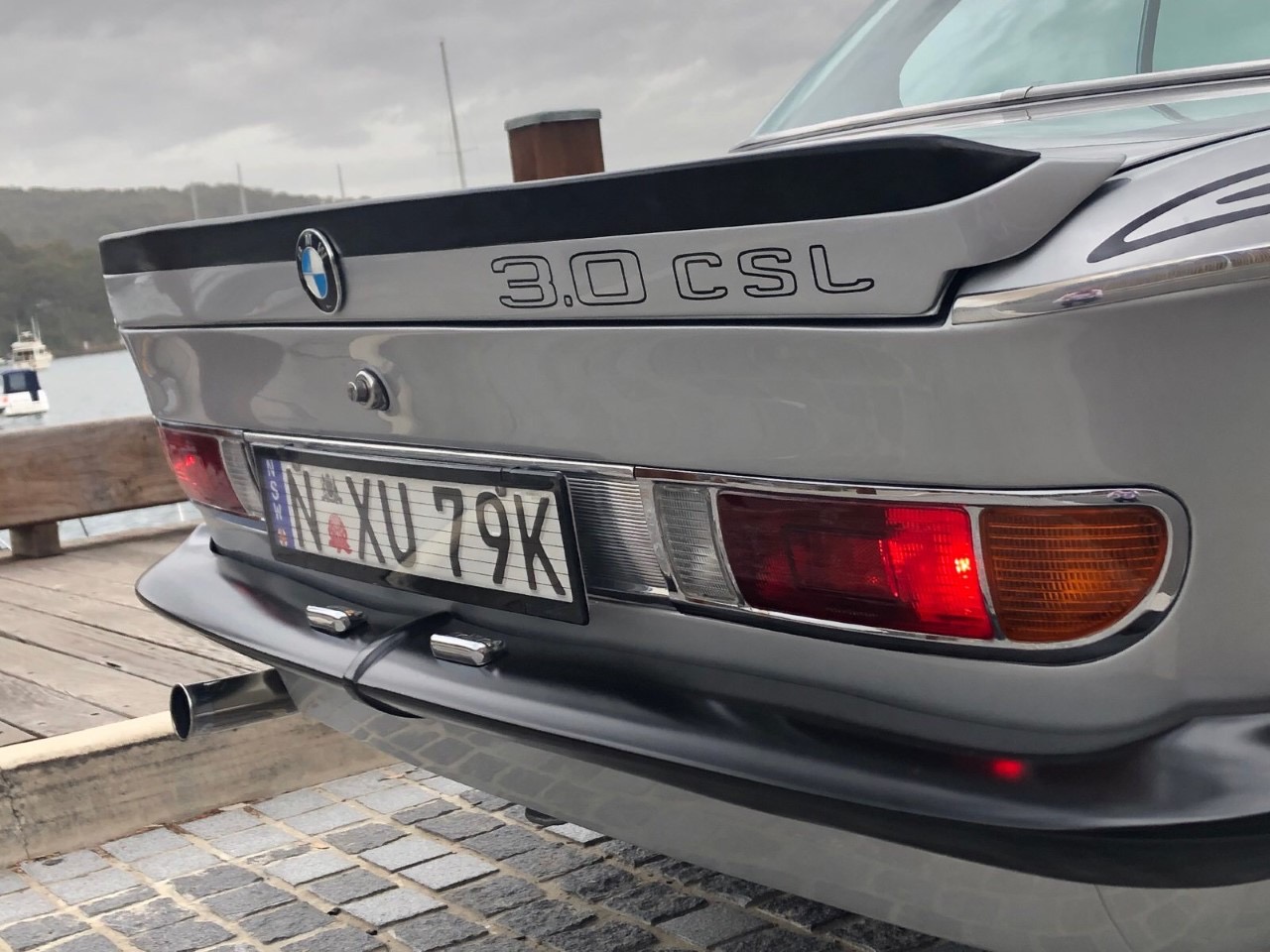

Here is 2 examples with the overbite:

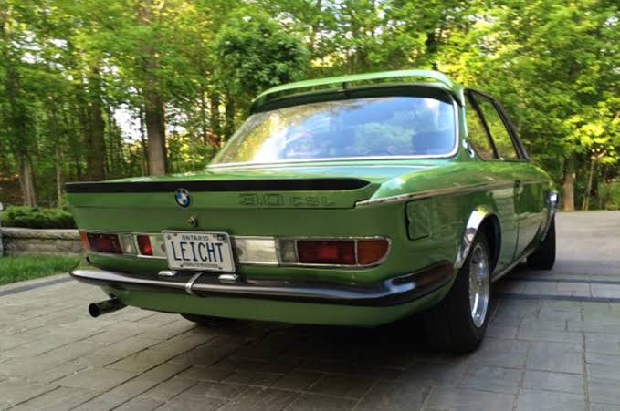

No overbites

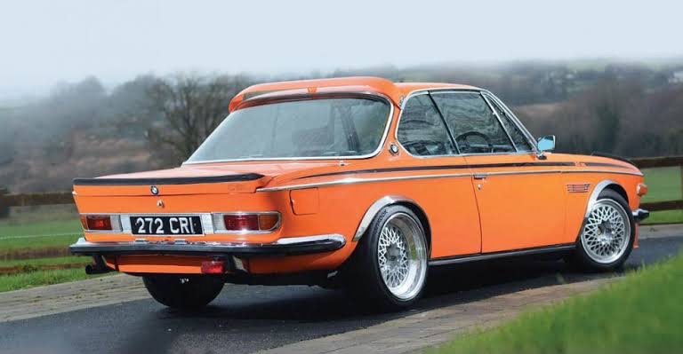

This car from the BMW museum also seems to have slightly more curvature in the spoiler as it sits out a fraction. The shadow line denotes that imo.

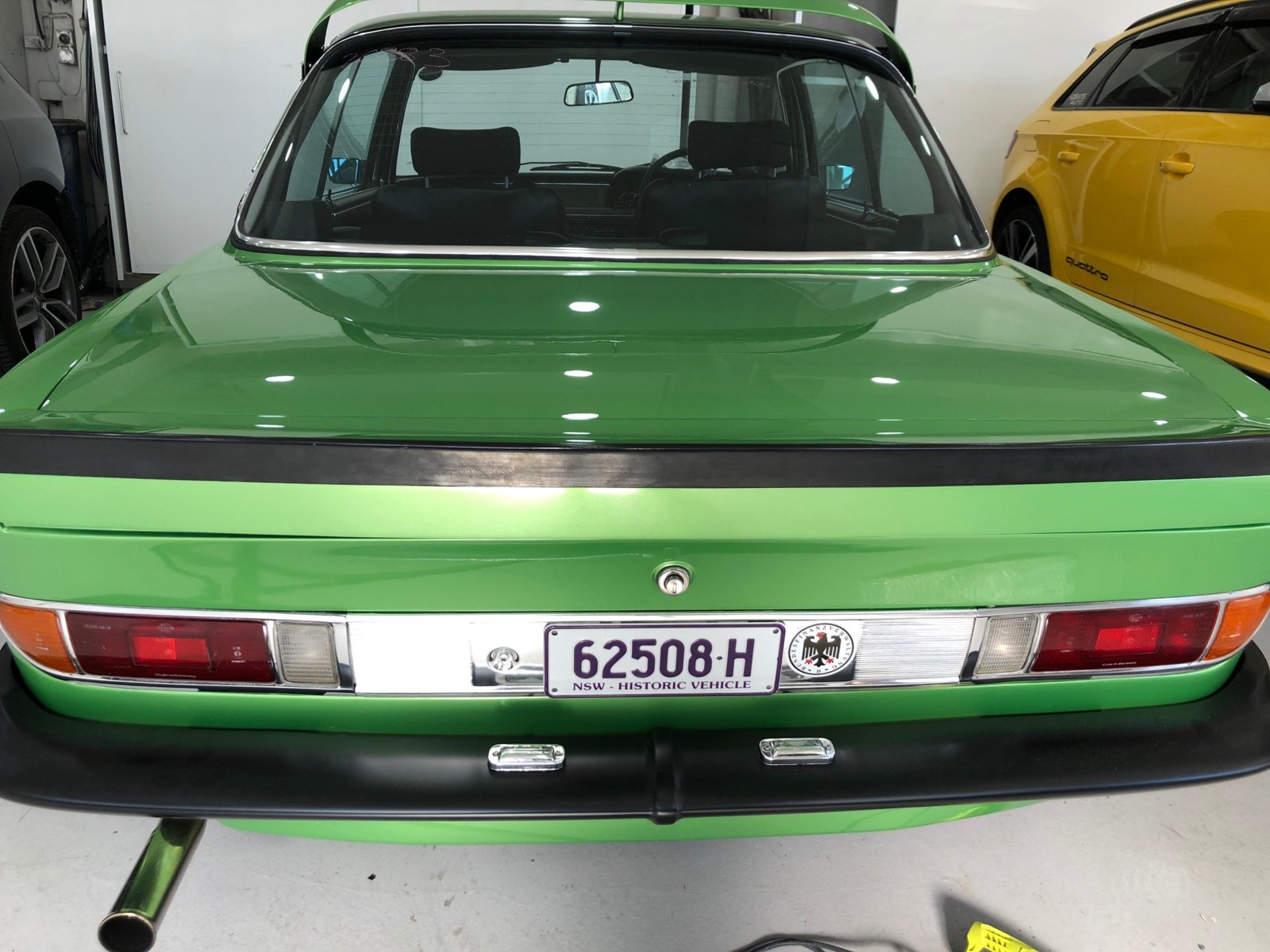

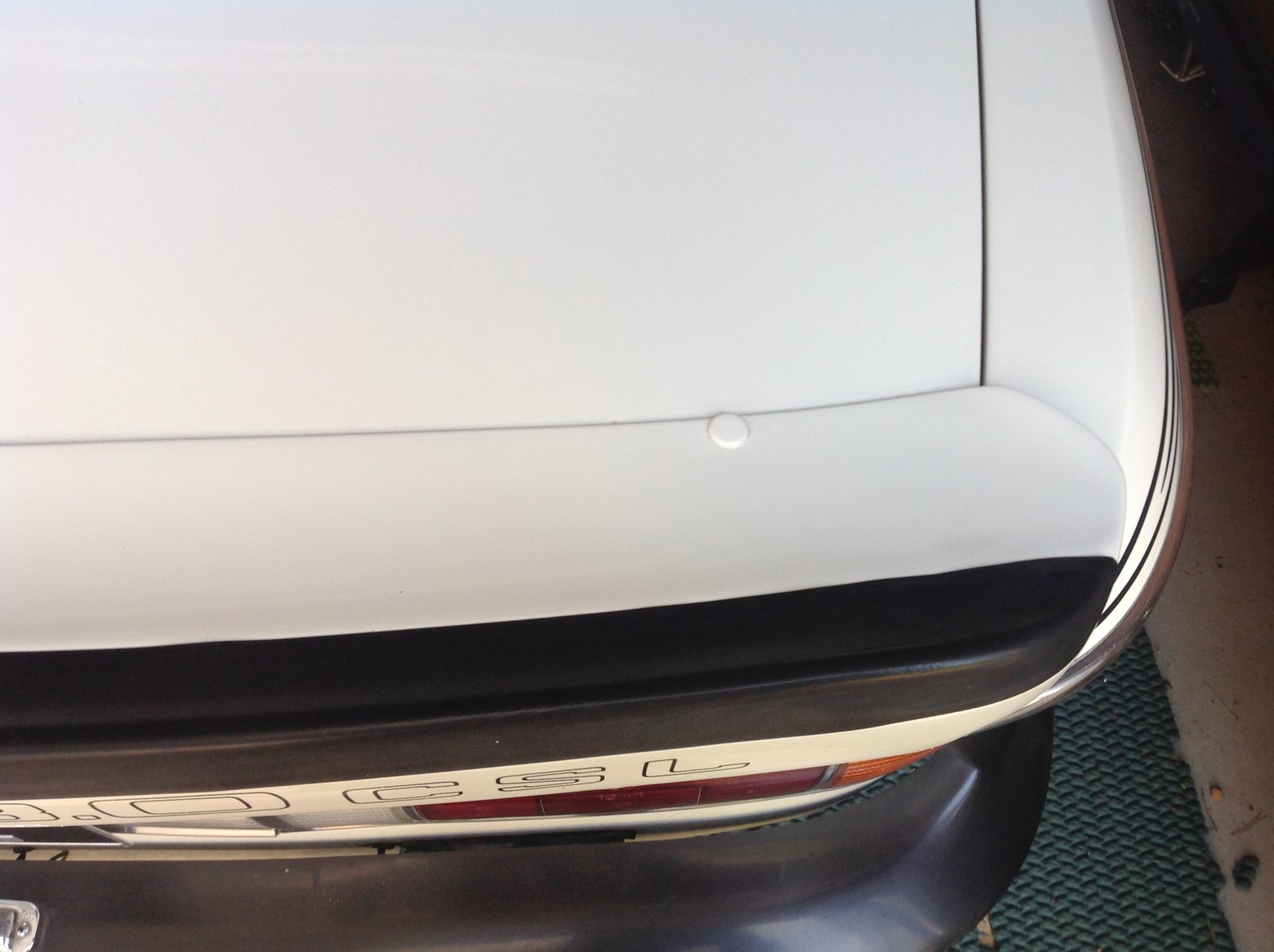

We managed to improve mine a bit - see below. I would have to grind away at my original CSL spoiler and reform it to make it fit even more precisely. So maybe not worth the hassle.
(I also kindly just got sent a photo of my actual spoiler from the seller when it was on his CSL many years ago. It also didn't sit precisely either)

Although not relevant to your topic, that Türkis Csl is not from the BMW museum, rather a private owner in Germany.

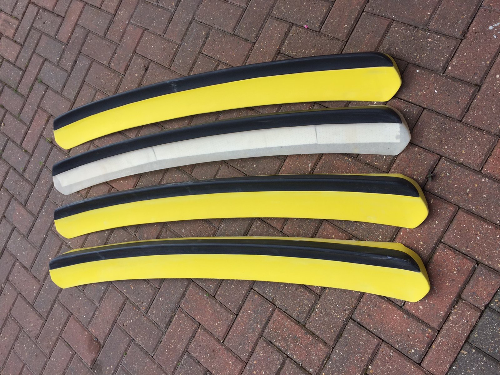

These spoilers are not precision pieces, I would go so far as to say that if you laid out a dozen spoilers side by side there would be differences in all of them, because of the material they are constructed, of and the age.
I had a good look at my spoiler , which is off the car , and the lower edge of the vertical plane is quite uneven , sagging in the middle and the entire length is not uniform , fiberglass! . The lower edge can be sanded to suit the lower edge of the boot lid , the danger there is that you go through the gel- coat and expose to much of the fiber , you can also go the other route build up the low sections of the edge with fiberglass resin to achieve the edge that you are looking for.

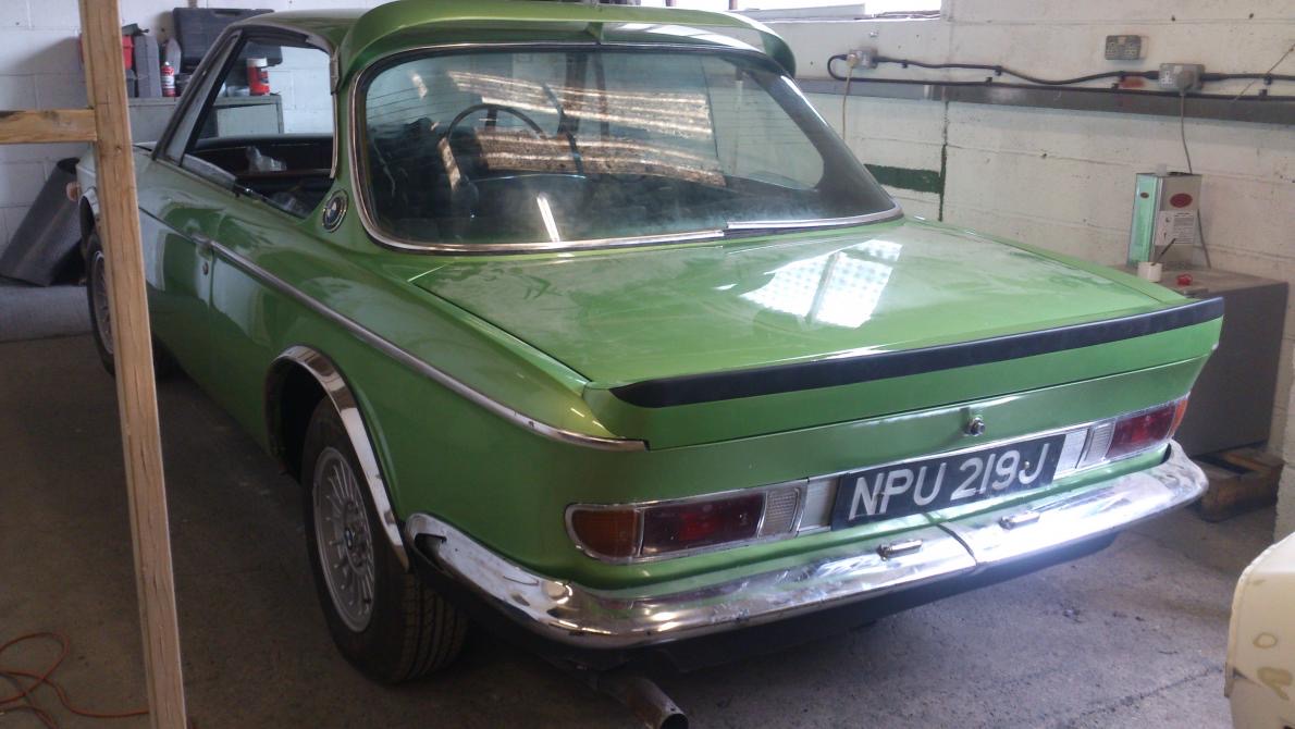

My car has the spoiler. Not sure it was fitted in the factory, but was defo on the car by the early 80s. It does look to fit flush all the way across, but on closer inspection it's not hugely tidy! Let me know if you want any more shots, but as I said, I wouldn't change a thing
Many thanks Drew, appreciate you sharing your photos.
Yes I think the flush fit is the way they are meant to be. Luckily mine fits perfectly along the bottom edge, it just sits out about 6mm too much in the middle as the spoiler curvature is not the same as the boot-lid.
Anyway most people probably wouldn't notice, as much as I do.

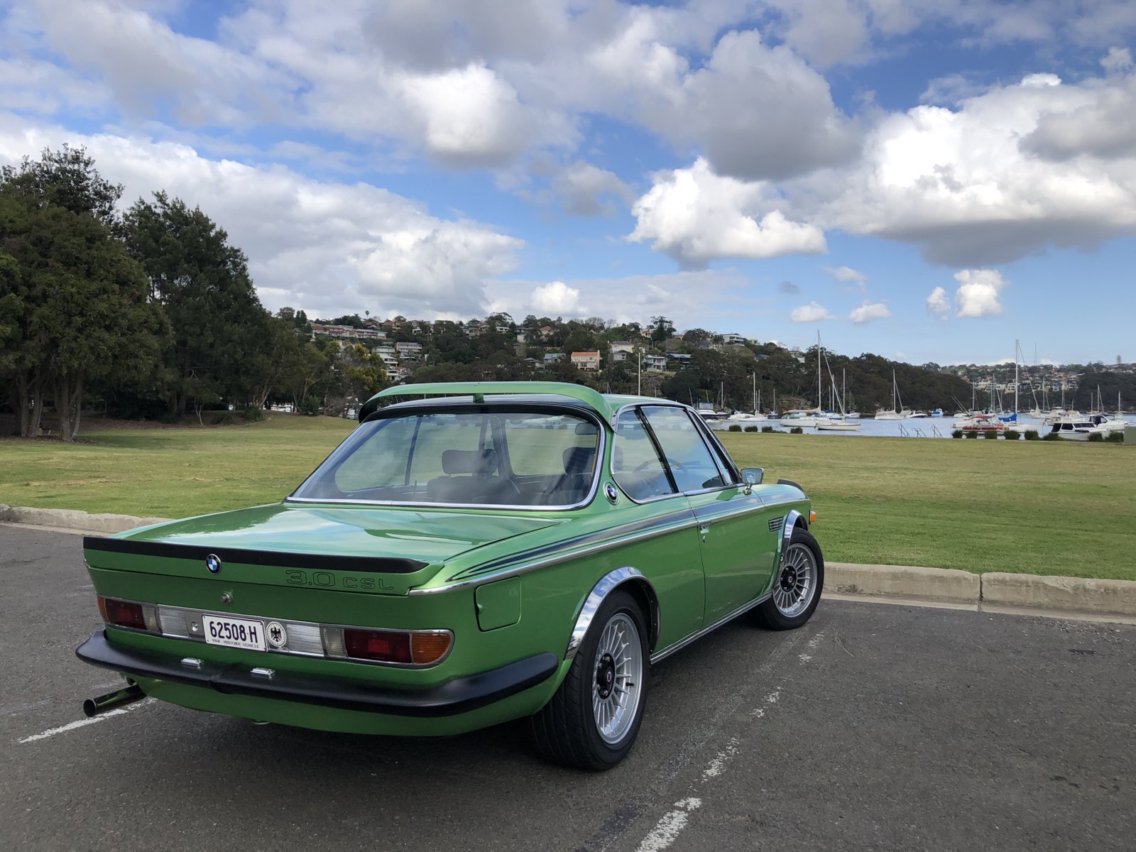

Picked up my car on Tuesday and took some photos on the way home. 100% the spoiler has made it look so much better. If an E9 has all the appendages such as roof hoop, bumper delete, front spoiler and wind splitters, it really needs the rear spoiler to make it look properly 'balanced'.
