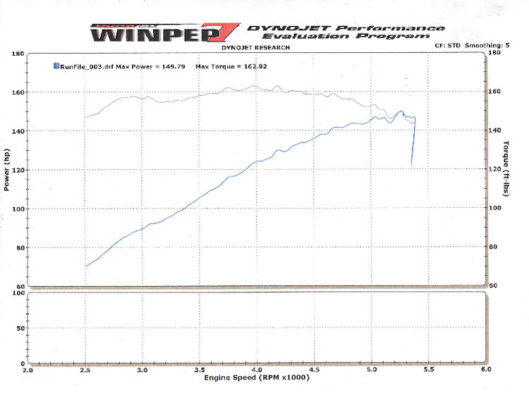

I put my super light CSi (no windows, interior) on the Dyno this afternoon. A quick Wiki search pulled up 197 HP and 201 ft/bs of torque for the CSi when new. Using a 15% power drain formula from the flywheel to the rear wheels on the Dyno, that would equate to 167 HP and 171 ft/lbs of torque at the back wheels. We actually saw 150 HP and 163 ft/lbs of torque at the back wheels, which I think are pretty healthy readings. My Dyno driver lifted at 5200 rpm, so there may have been a few more HP to be had.
